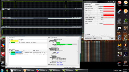

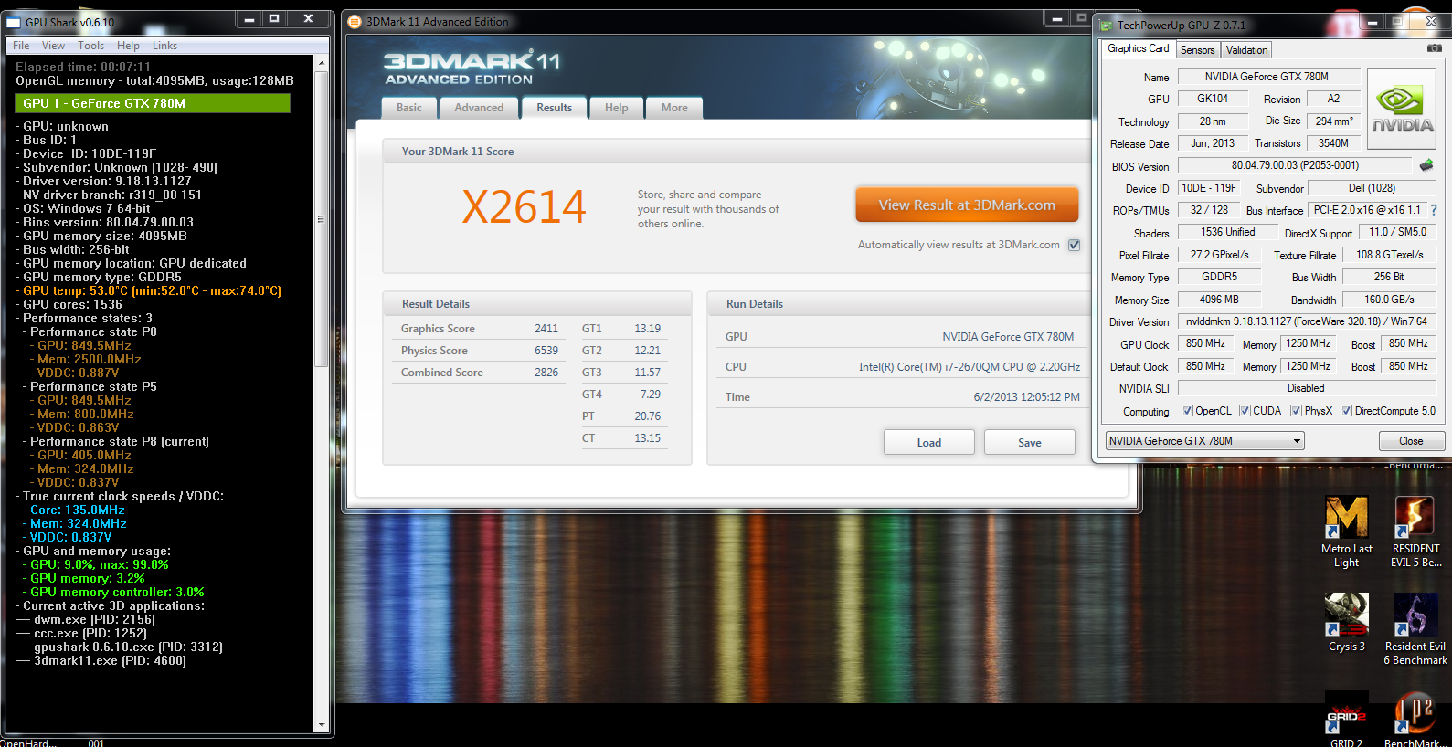

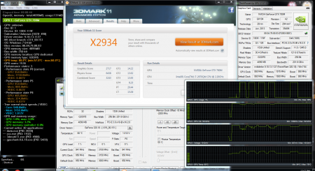

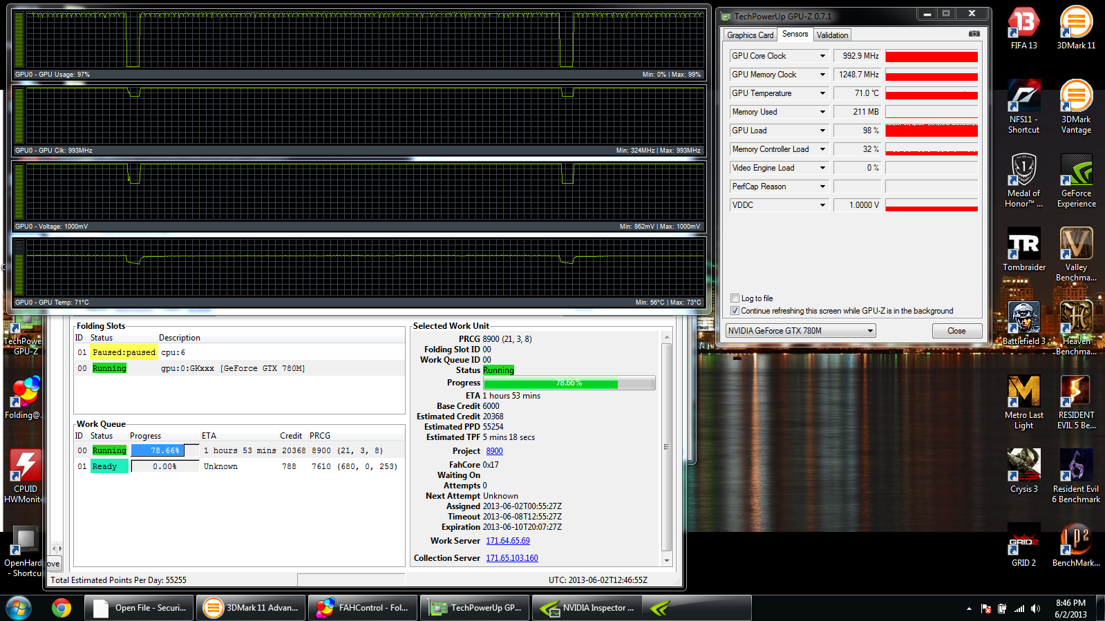

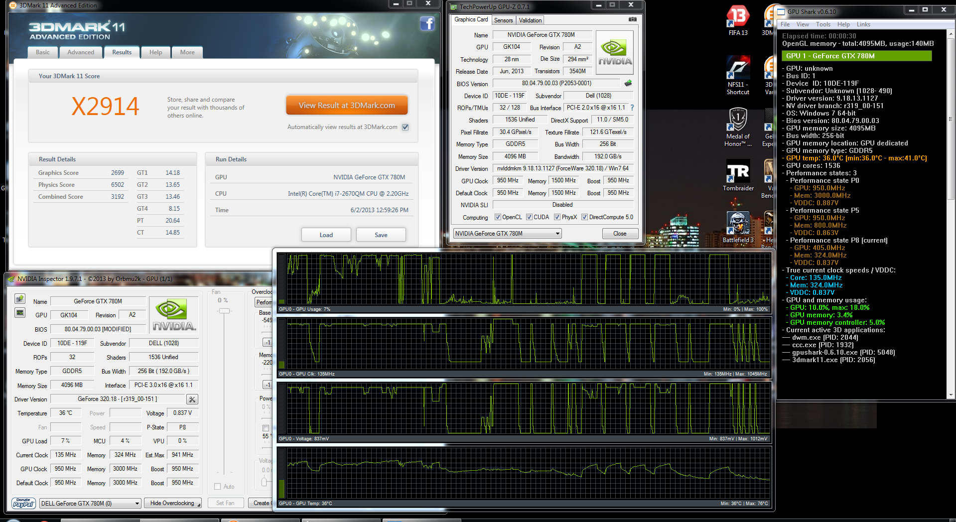

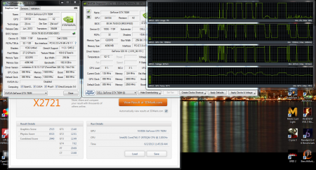

[ATTACH=CONFIG]7763[/ATTACH][ATTACH=CONFIG]7764[/ATTACH][ATTACH=CONFIG]7765[/ATTACH][ATTACH=CONFIG]7766[/ATTACH][ATTACH=CONFIG]7767[/ATTACH][ATTACH=CONFIG]7768[/ATTACH][ATTACH=CONFIG]7769[/ATTACH][ATTACH=CONFIG]7770[/ATTACH][ATTACH=CONFIG]7771[/ATTACH][ATTACH=CONFIG]7772[/ATTACH][ATTACH=CONFIG]7773[/ATTACH]

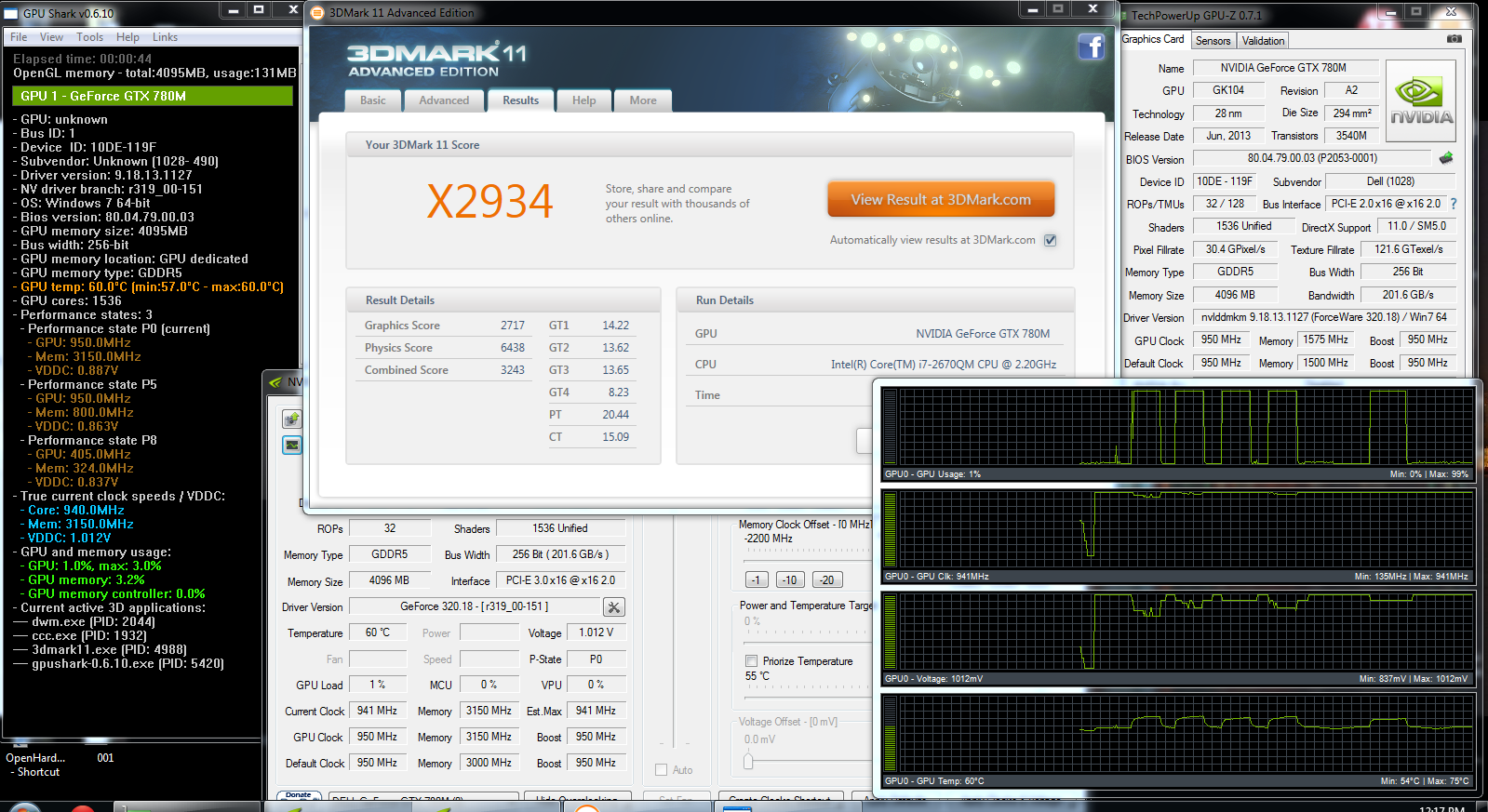

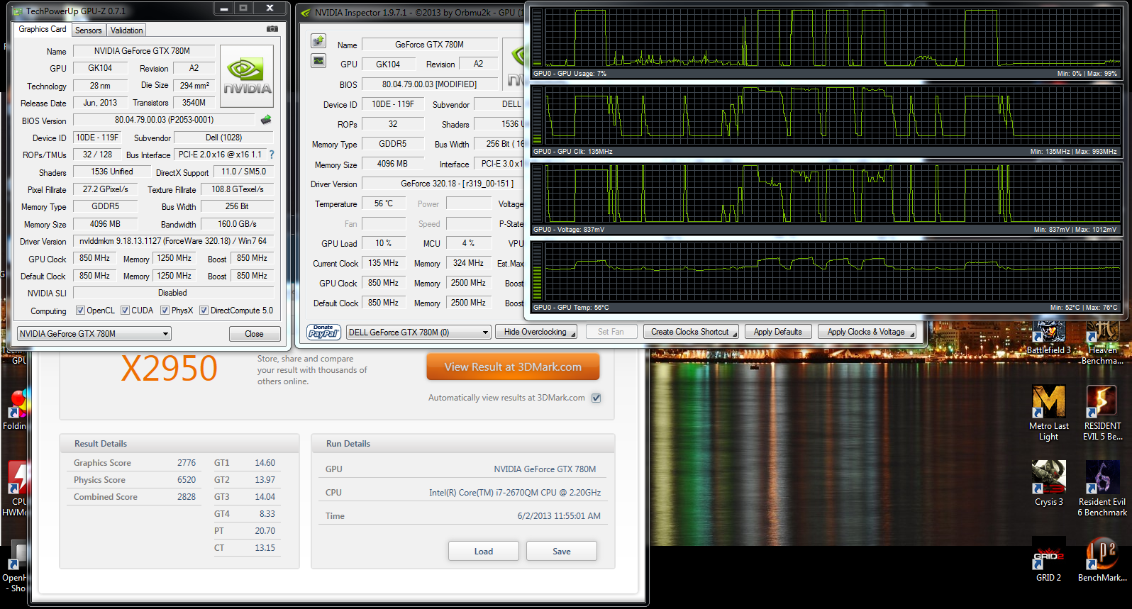

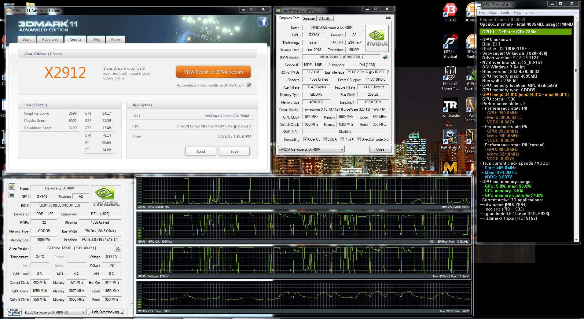

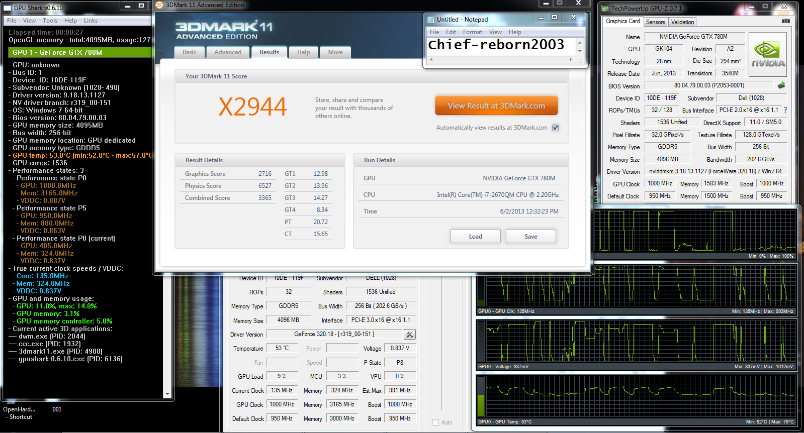

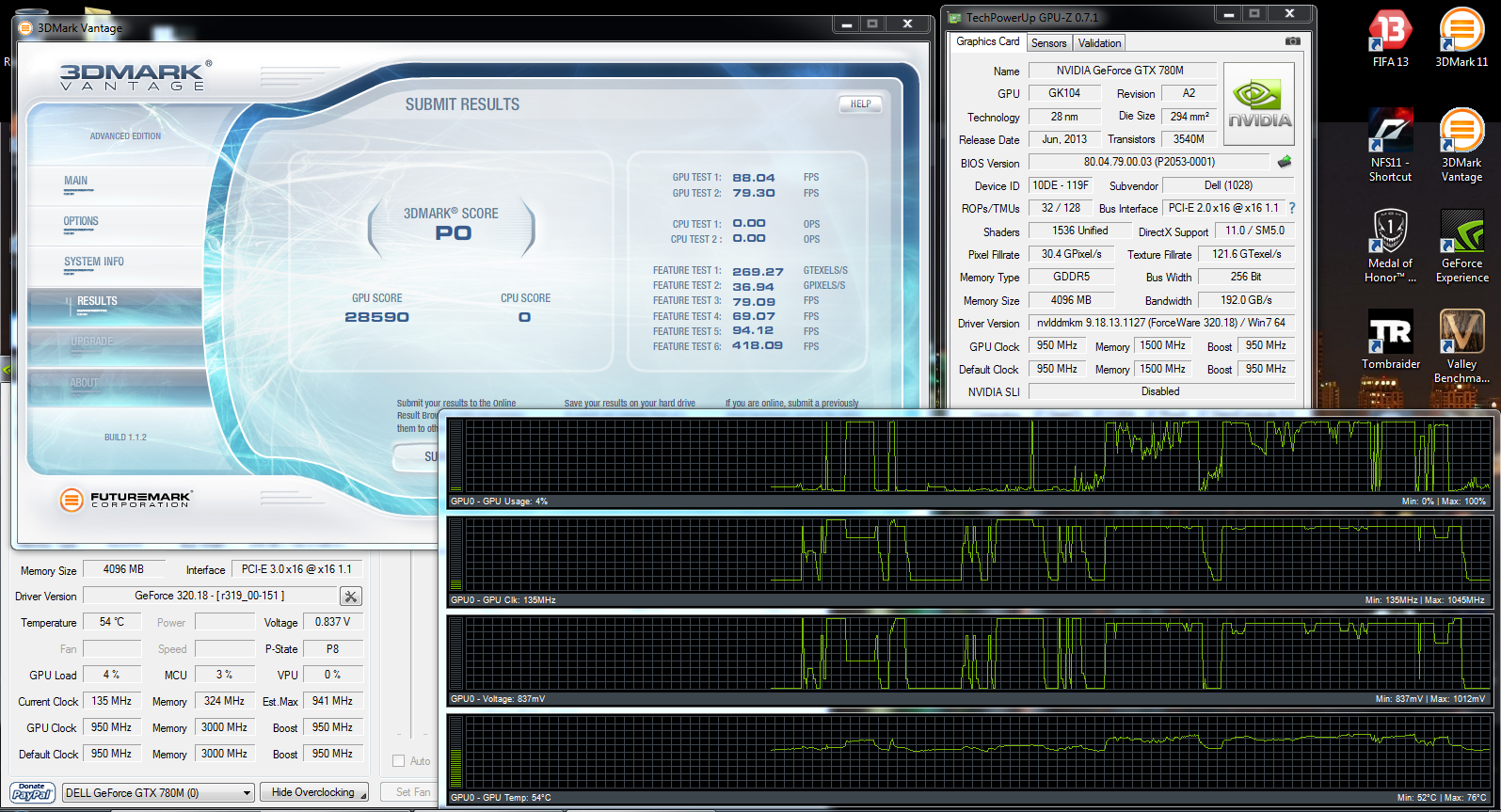

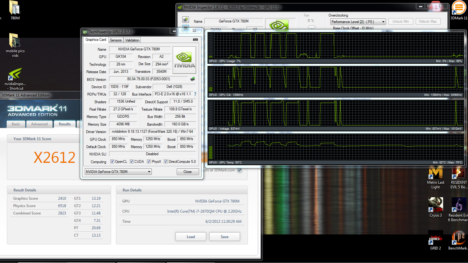

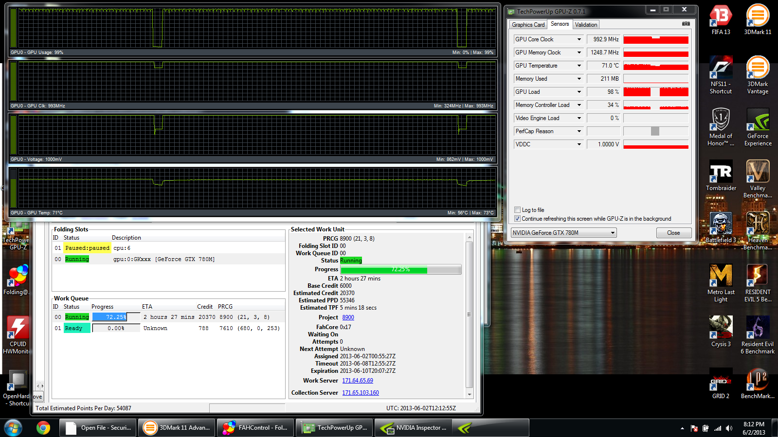

Some random X-rated;) benches with graphs to show the throttling.
Cheers. :)
Ouch. That is pretty bad throttling. I never saw your temps over 76C so it looks power draw related. You can probably fix it by looking up the power monitoring chip and modding the current sensing circuit.
Is 1.012V the default voltage, or did you raise it?

Yeah, my conclusion so far is that (unless the OEM vbios will be a lot different - which I bet it won't) the 780m with a stock vbios won't be able to beat a tweaked 680m, the card will downclock at high clocks.
seems like this generation is a big disappointment in more ways than one
Haven't had any trouble with downclocks on my Alienware 18, but a lot of people have had problems on their Alienware 17's. Either way if the modified VBios solves the problem it isn't really a problem. The card overclocks very nicely and will outperform the 680m at least 15%.
