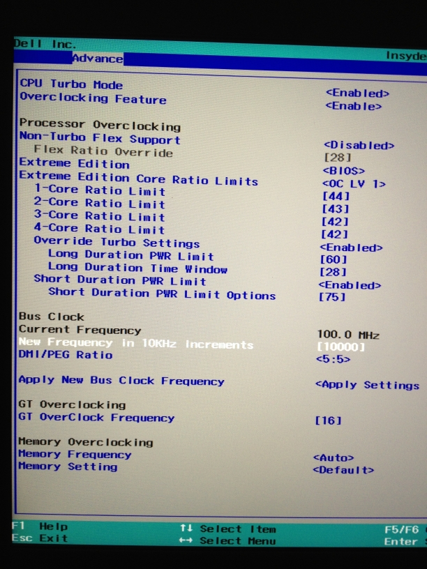

  1. No, OC via the BIOS isn't known to cause hardware failures, at least so far. Everyone who OC's is doing it basically the way you showed above, by enabling the basic OC options in the BIOS then using XTU to get access to some settings that are otherwise hidden in the AW BIOS. As you noted above, you can at least get the CPU to operate at its rated turbo speed without throttling down. For advanced overclocking though, us normal users simply must have a proper BIOS from Alienware so we're all in a holding pattern until then.
  2. Sure, basically the BIOS on the AW 18, at least as of A02, has many options hidden or locked and is preventing the system from running properly at the rated turbo speeds, often throttling well BELOW in fact, which you can verify with most any CPU utility. There are workarounds available that can restore much of that lost performance but the expectation is that Dell/Alienware will eventually release a proper BIOS, such as exists with their Ivy Bridge systems.
  3. I've since learned that the current BIOS locks BCLK at 100 so we can't OC that way period (not with XTU, nothing) which is extremely lame since Haswell specifically introduced step-down clocks specifically to allow raising BCLK. It seems with the 'OC LV 1' preset in the BIOS (the only one you get with a 4900MQ) they are actually allowing a partial unlock of the core multipliers via BIOS so I guess that explains that. So with 4 cores pumping the most I can get is 4.2 GHz on each which isn't shabby and certainly something to shoot for as soon as they ever fix this locked down BIOS situation.
  4. Now I'm confused again. For Haswell, Intel confirmed that all core and turbo multipliers were disabled for non-extreme CPU's which leads me to believe only base clock tweaking is available for OC. However in the AW 18 BIOS I can change the core ratio settings for all 4 cores and see in Windows that the cores are actually hitting the higher speeds (via CPU-Z). Of course under load I throttle immediately down to 3.1 and even 2.6 GHz (laff) but I know that's a separate BIOS issue affecting everyone. Anyway the BIOS will not however let me change the base clock at all, no matter what I set it to or what ratio, it always reverts back to 100. I hope someone creates a Haswell overclock guide just for us Alienware 14/17/18 people as I can't figure out who's doing what now. So for Haswell non-extreme, will we or won't we (eventually) have access to that 'free' ~400 MHz headroom that the Ivy Bridge people enjoyed? Does Intel XTU override this BIOS stuff in software and allow changes to BCLK and the turbo multi's? I know even bothering with OC'ing right now is pointless but I'd just like to understand these concepts a bit better.
