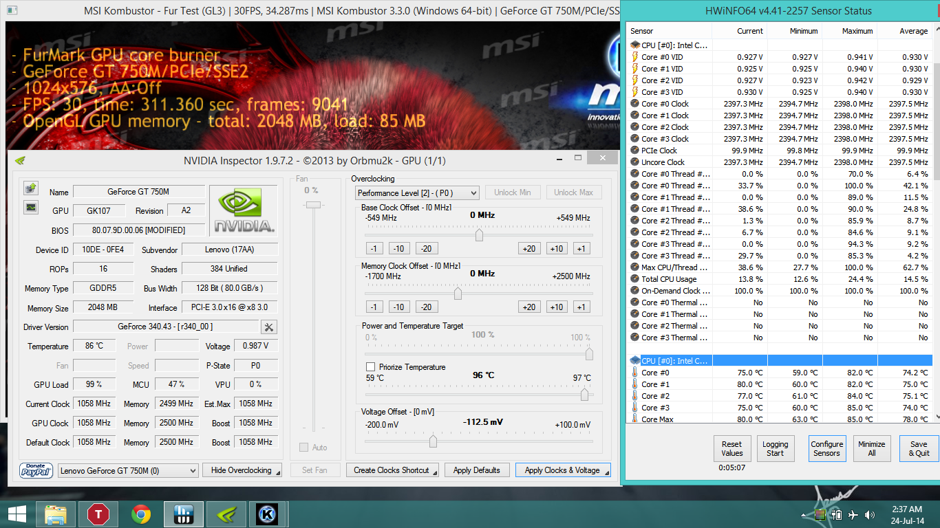

Mine can run MSI Kombustor - Fur Test for about 5 min with 0.987V(-112mV) without any artifacts or driver crash. At 0.975V(-125mV) it has some artifact, but the driver does not crash. Lower than that, there is lot of artifacts and the driver will crash. With default 1058MHz clock.post-20850-1449499797418_thumb.png
Mine can run MSI Kombustor - Fur Test for about 5 min with 0.987V(-112mV) without any artifacts or driver crash. At 0.975V(-125mV) it has some artifact, but the driver does not crash. Lower than that, there is lot of artifacts and the driver will crash. With default 1058MHz clock.[ATTACH=CONFIG]12088[/ATTACH]
Cool, even though I can't recommend that test, not necessarily healthy for the voltage supply circuits of the GPU.
Anyway, would be nice to see if 1v is game stable for everyone.
