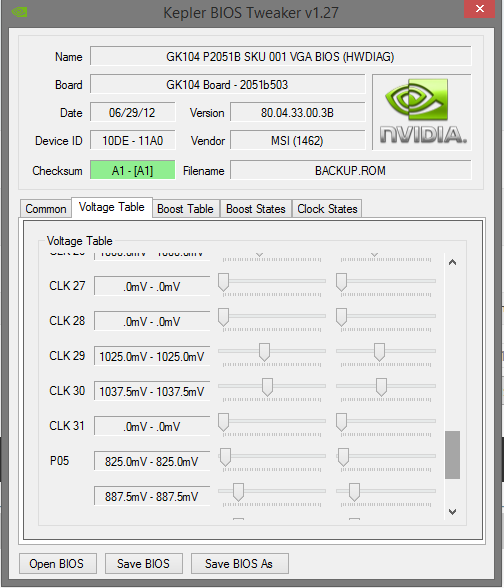

Hey Guys I need an Modded vBios for my GTX680m 2GB (MSI). Using an Medion Erazer x6825 Notebook.
Don´t know if OV is needed cause the voltages already seem pretty high. (Look at the Screenshot attached)
My Target is to get near the power of the GTX670 Desktop card.
Thank´s guys!
https://www.dropbox.com/s/uziis3ezwi5bnah/Medion%20Erazer%20GTX680m%20vBIOS%20%28MSI%202GB%29%20-%20untouched.rar
Hey guys. I'm sorry if i misunderstood something in the rules. Just knowing some school english ;)
Already editet my post with an link to Dropbox. Wanted to upload it directly here but doesnt work.
A can't find any link to the vendor page with a newer bios so just uploaded Mine. It's untouched and stock for sure.
with"my target is to get about the gtx670" i meant that this is my personaltarget. So just want to get the vbios unlocked to oc with nvinspector or sth. Like this by my self.
And oV is locked in my bios so i cannot do it in Software.
tryed the 2gb dell vbios but it doesnt work.
I would be very thankful for your help and for sure i will spend you a beer for your work.

Here you go. Please post a screenshot showing the overclocking section of nvidia inspector. Thanks.
For voltage above 1.21V you'll need either a hardmod or use the MSI AB voltage workaround.
For everything else, use the attached vbios. Please let me know if all is working fine. Thanks.
