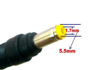

I think too. I have scoured several technical forums, where the same error was occurred because of a to weak power supply. Unfortunately I have not found a stronger power supply with the same plug. I need a plug with the dimensions: 2.5 *1.7mm An do you think , if i need an other power supply from an other company and solder on the required plug, it could work? Because some companys (for example dell and hp) use impudent tricks to protect their notebooks from not original (hp, dell) power supplys. Other power supplys would not work. Greets -

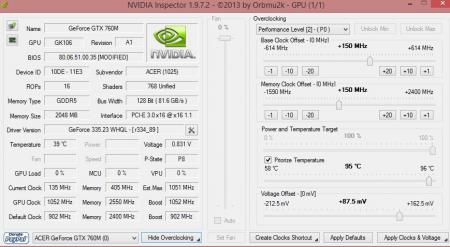

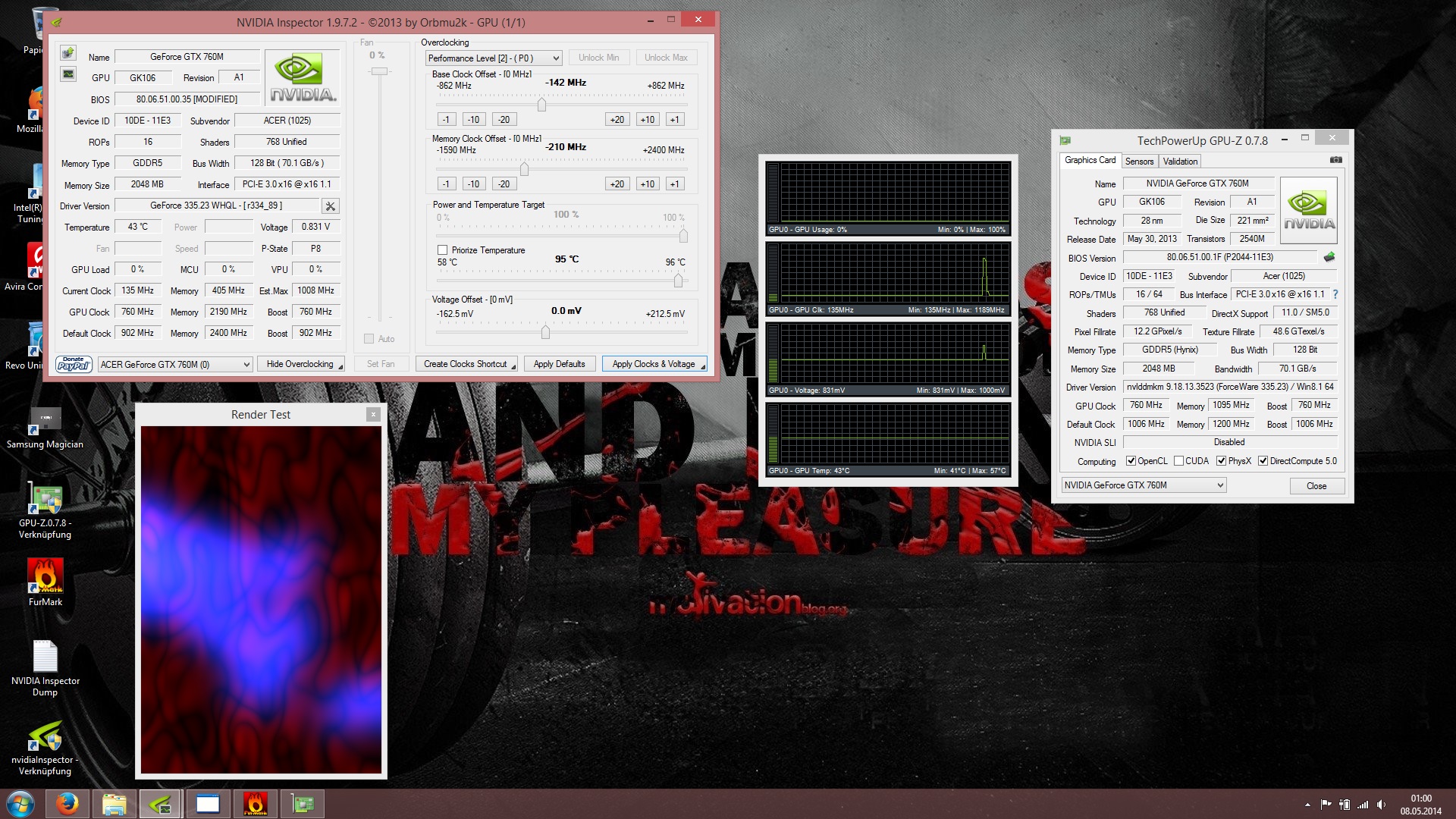

EDIT: I tested the maximum stable base clock offset and memory clock offset. But beware: You need take another external monitor (HDMI, vga), because otherwise there is not enough power for all. The benchmark programms I used for this tests were: Furmark, and Heaven Benchmark. Additional you need some control programms, for example: CPU-Z, HwMonitor to keep a watch on the temperature. What you really need for this overclocking: an external cooler, because otherwise your notebook is going to become really fast extremly hot, which could damage your hardware. Good luck! This are my tested most stable clocks, with increased core voltage and external monitor. @Klem: How much do you want for your great work? -

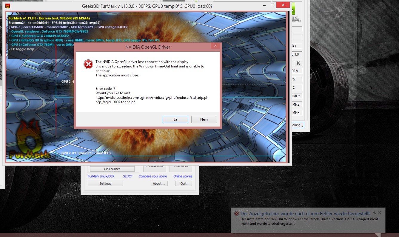

@Klem: I tried many different clocks, I took lower clocks than you, but my laptop shut down after a few minutes with Stress test ( furmark and heaven Benchmark). Whats the Problem? I took a selfmade external cooler, so the Temperature was not higher than 65 degree Celsius. Hope you can help me. Ps: (I transfered some money to paypal, but it will take a few days, until it's on the paypal Account). Greets -

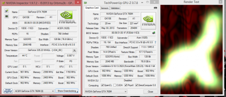

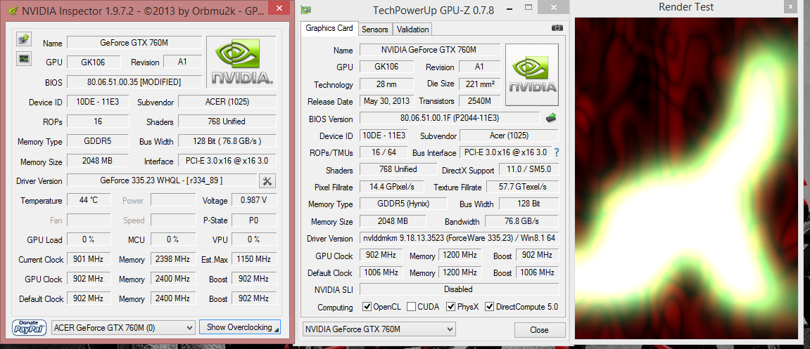

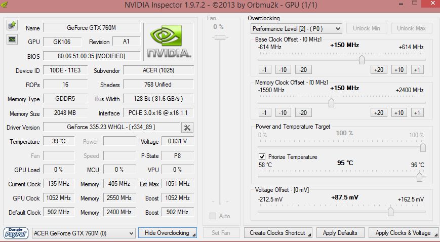

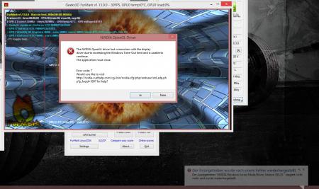

@slv7: Danke, dass du daran geacht hast. Das habe ich glücklicherweise beachtet. @Klem: I have tested your modified bios (Acer3 and Acer4). At first I updated my grafic driver. Now, gpu-z and Nvidia Inspector displays the clocks correct. But, if I start a benchmark programm, the grafic driver crash. I need to reduce the memory and the base clock a little bit. But now....it works !!! Am I need to increase the voltage offset a little(!!!) bit for no more crashes? How can I ever thank you? Thank you so much for your fast help and your great effort!. Please give me your Paypal ID, so I can value your help with some coffees -

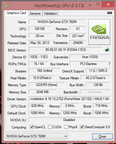

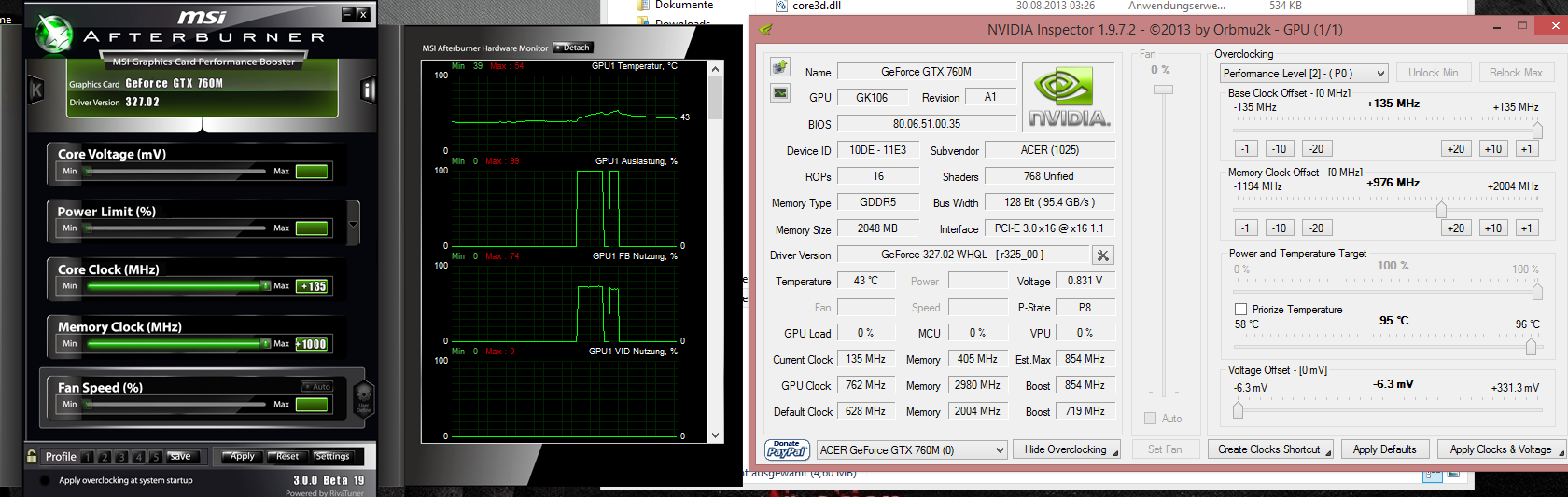

@Klem : to prove it to you, I reflashed the previous bios Look: --------------------------------------------- EDIT: it's just occurred to me that GPU-Z show 80.06.51.00.1F and NVidia Inspector 80.06.51.00.35 -

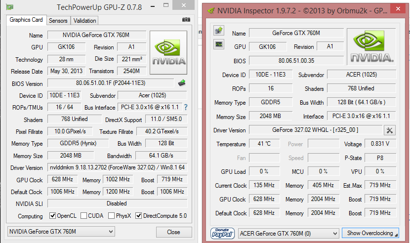

@Klem:Before I flashed your file ( main bios), my vbios had was 80.06.51.00.1F. After I flashed your Bios, I had 80.06.51.00.35 Greets -
