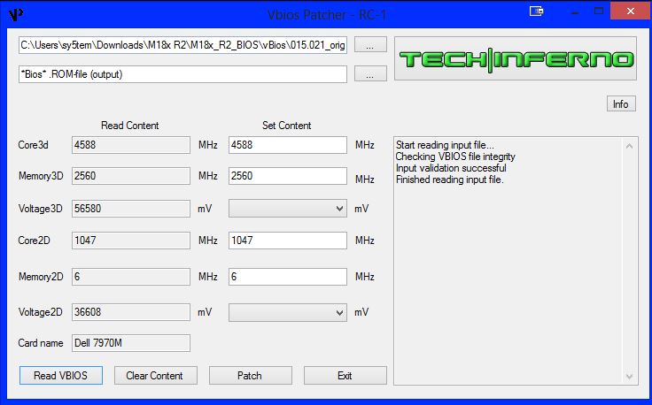

hello, thank you, work nicely
now i have ad 1 of my videocard changed and it came with 021 bios! 015.021.000.000.000000(113-C42904A1-118) the vbios can't read it , you know about this bios? what's new or removed?

Yeah, I know. Mentioned it already several times. Will be updated when we find time. The current patcher is rather basic and not that sophisticated, only works for the old Dell 7970m vbios.
