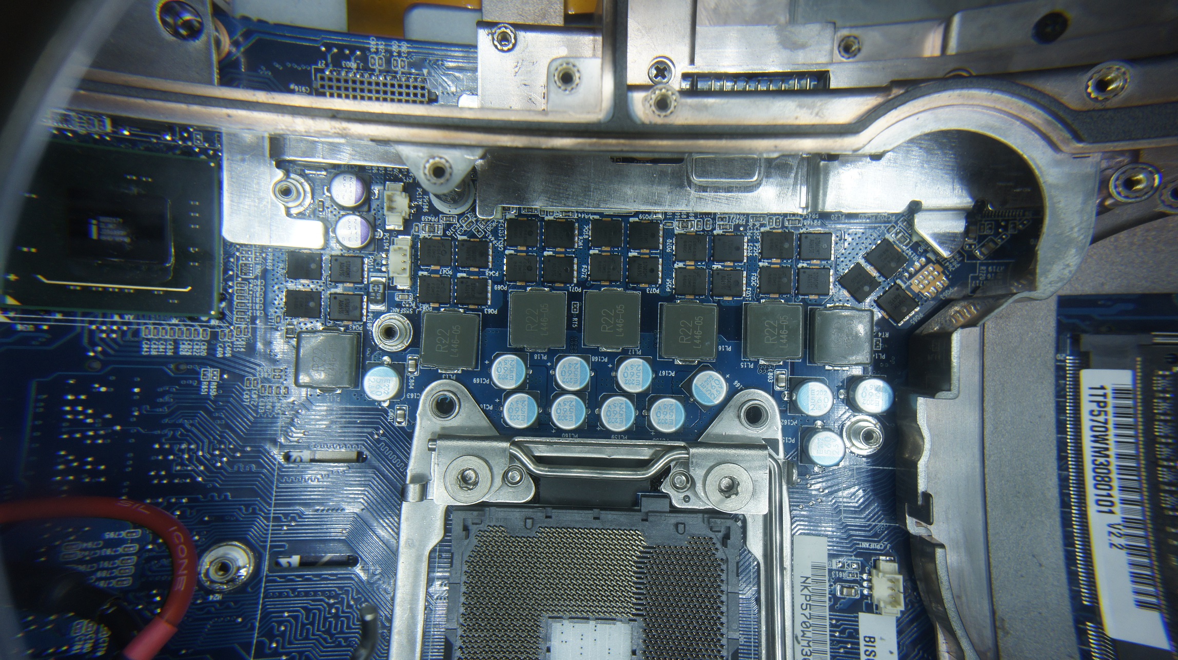

Hi Prema, Anyway I'm going back to the K5000M so I ask out of sheer curiosity whether my mainboard is compatible up to the GTX780M or above? This is not the CPU PWR capacitors or MOSFETs make the difference between mainboards. What is it? Is it too important differences in the PCB circuits or is just a matter of mainboard SMD component replacement? Regards

You can give even 16mm square electrical wire and further will not result. the weakest link in P150xM is plug/connector. If you do not replace it forget to the high OC. All my P150 are replaced connector/mobo from P170. BTW, My QS K5000M (9300 points in 3DMark) had poor ASIC but thicker PCB than standard OEM card, so better contact.

I just want to say, that the existing technical solutions of Clevo work to the appearance of GTX980M. Talking about the larger PSU does not make sense to time the changes in the supply system on the motherboards. Perhaps a 36V mobo/power supply would be a solution?
820W/20V~40A I do not have full technical documentation, but I bet that it power socket may have difficulties at 15-20A after 15-30 minutes. It's just for 2-3 benchmarks. Good luck for the 3 hours of the games.
I think that rather than deliberate about the size of the power supply, Clevo should think about changing the power socket/plug, or the ability to easily install a second one, without converter box.
