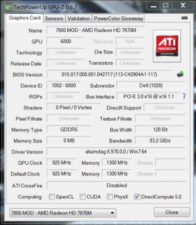

Did some tests with the VBIOS of the AMD 7970m, here's what I've got so far:

- Core / memory clocks: Works fine so far, I only tested the 3d settings, but I assume it also works for the other clock profiles.
In the GPU-Z screenshot you can see the changed clocks:
