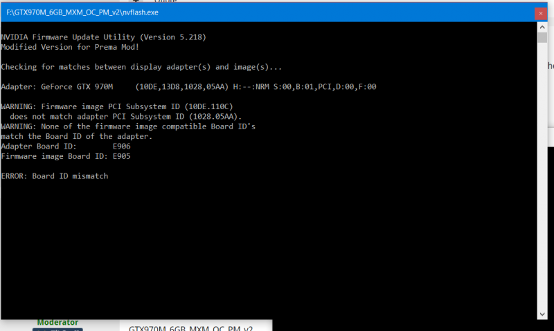

@J95I tried man same thing in safe I get Unable to start service  0x0000043 ?
Is it because I have secure boot on ? I choose number 6 "Enable Safe mode" is it the correct option ?
This image below is when I tried in not in safe mode but with dedicated more
.......:) disable secure boot and keep it disabled, incl fast boot...;)

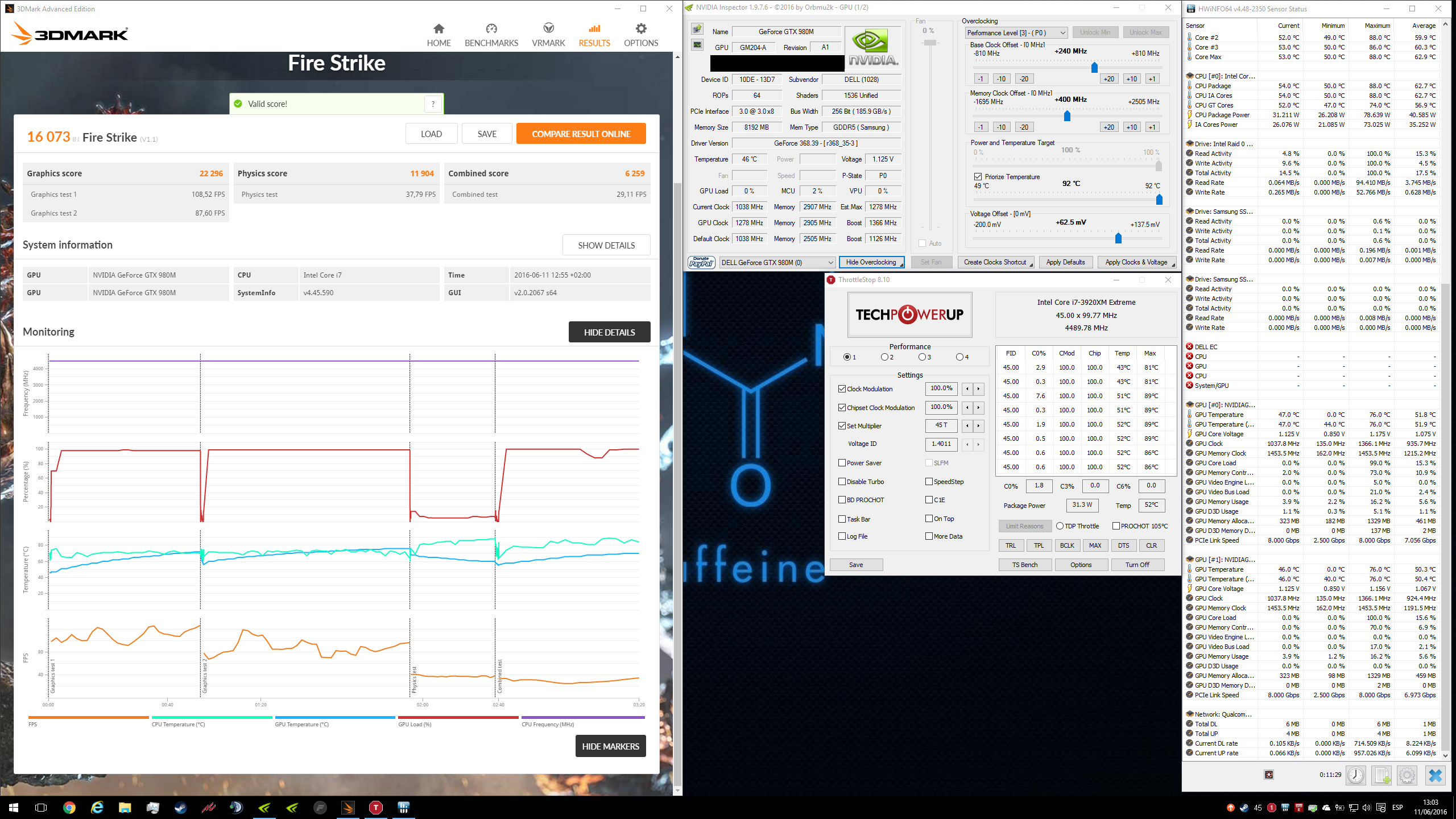

Cheers mate, I don't know what Nvidia did this time but for me it's the best driver for my setup. Better than 352.84.
OC'ing is more stable with this driver, temps are ~2°C cooler.

I didn't work man I feel ashamed taking so much of your time :(@J95
In safe mode I still get unable to start service no matter what I do .
and again everything else Board ID mismatch :(

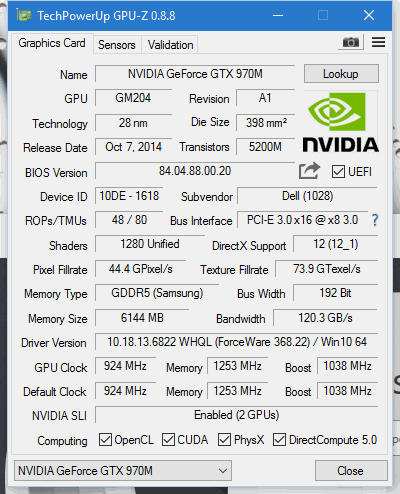

Hi @Prema
Was pointed your way by @J95 I have already upgraded the drivers thanks to @J95 but now want to update vbios as I get a bit of throttling, I am running an Alienware M18x R2 with 2 x GTX970M cards. I am a complete noob about this stuff. Can you give me a heads up on what bios file I need and how to do it please
