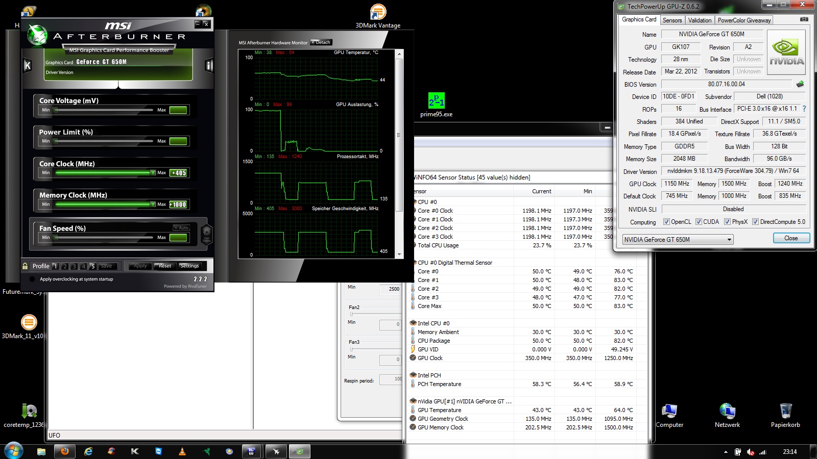

Alienware M14x R2 - Modified BIOS versions containing tweaked VBIOS files
Similar to the original M14x (aka R1 nowadays), the GPU of the M14x R2 is astonishingly powerful and has much more power than it reveals at stock settings.
The relatively low default clock and base boost as well as the apparent +135MHz core overclock limit holds back a lot of GPU power. These BIOS versions here will unlock this software overclocking limit and / or increase the clocks of your GPU and allow you to get much more power from your system.
Mods based on M14x R2 BIOS A03:
- A03 @ stock clocks, unlocked overclocking limits post-80-14494993390503_thumb.jpg
- more to come
Instructions are included, refer to the READ ME file.
Please provide feedback and leave a comment.
I'm also still looking for some versions to be tested once in a while, if you're interested please take a look at this thread: http://forum.techinferno.com/alienware-m14x/1787-%5Bm14x-r2%5D-vbios-mod-higher-boost-clocks-test-versions-only-5.html
