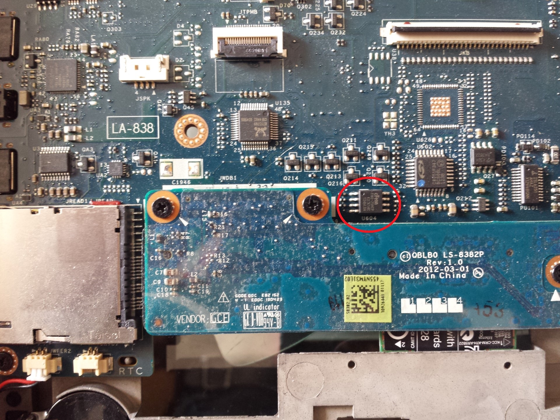

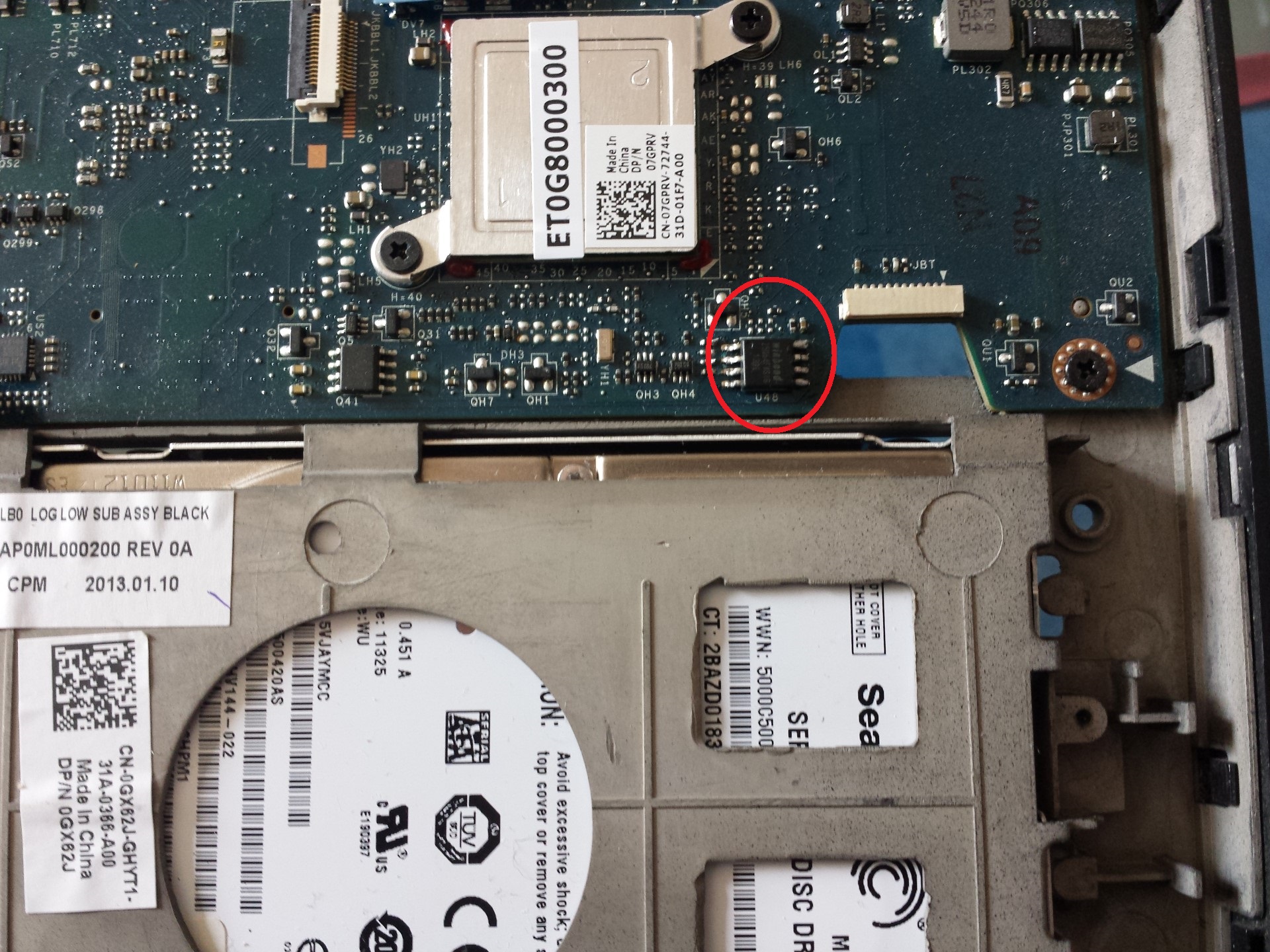

  1. So, Super've now M14Xr2 my yet again disassembled because I was curious. have two pictures taken which places the chips show there seem to be two different chips, the chip has been the sent me corresponds to the imprint of the old chips and the other at position U604 is a completely different. Maybe this will help you even further. Greetings dermosi U48 Location: U604 Location:
  2. Hello, i have the same Problem i buyed a replacement chip ( Winbond 25..... 1301 ) an i used the Location "U48" but after the Replacement my M14XR2 doesn't do anything, i don't no why. I have wrote an Email to my Chip Dealer which Bios Version he had programmed at the Chip. I hope that was the right Location, when i remember right the Chip on Location "U604" are a little bit smaller and have another Description i think. When are you finished and its work please write the right Location and your Chip Description please. Good Look , dermosi.
