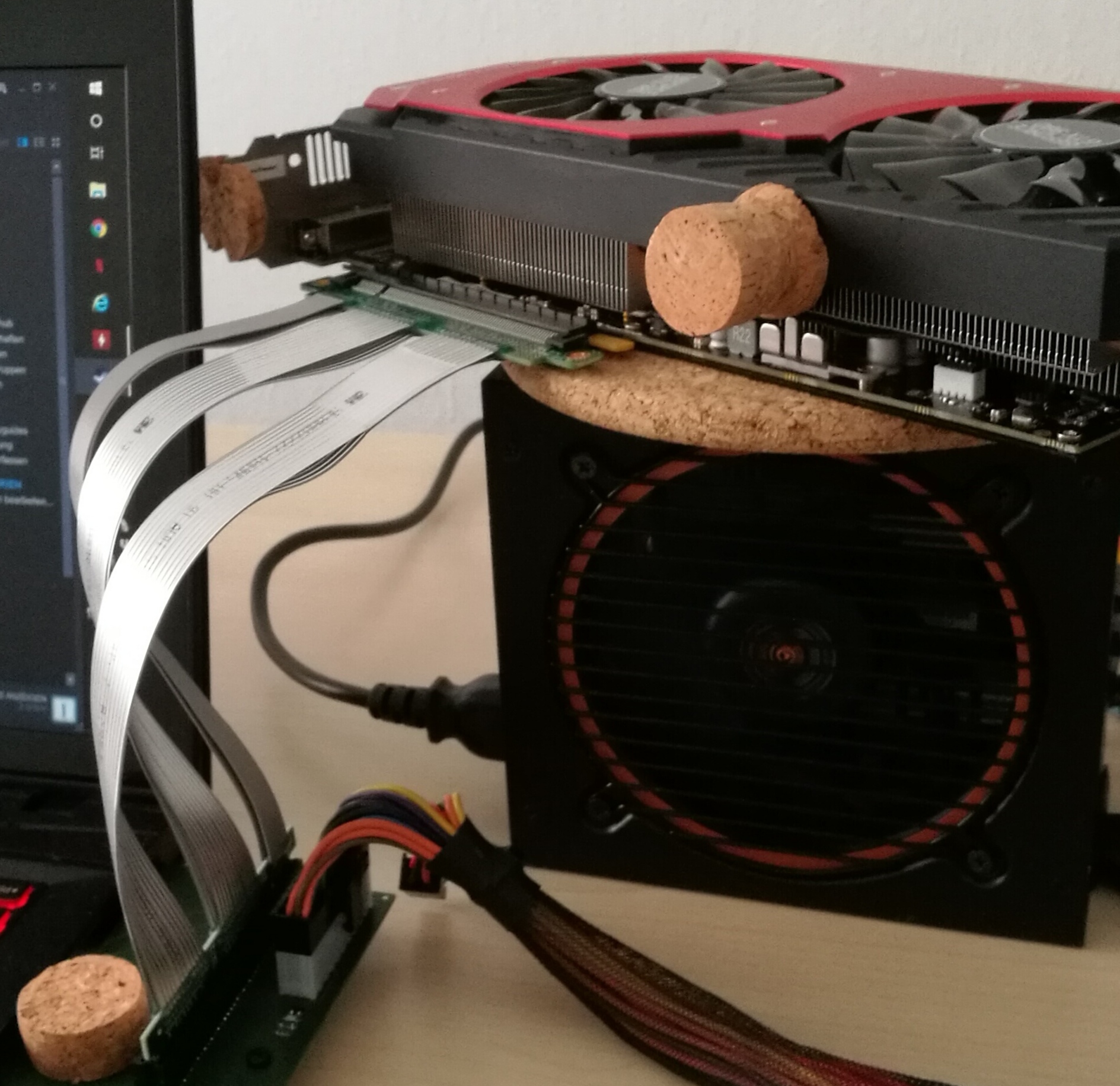

Guys it's me again!
I had success using the famous 3M Extender, what quality! I took the short version because of the thermaltake adapter failing on me, fearing that an even greater length may not work out at all regardless of build quality and shielding.
Here is a picture of my current setup, I will build a cage for the power supply with the graphics card on top to make things more official.

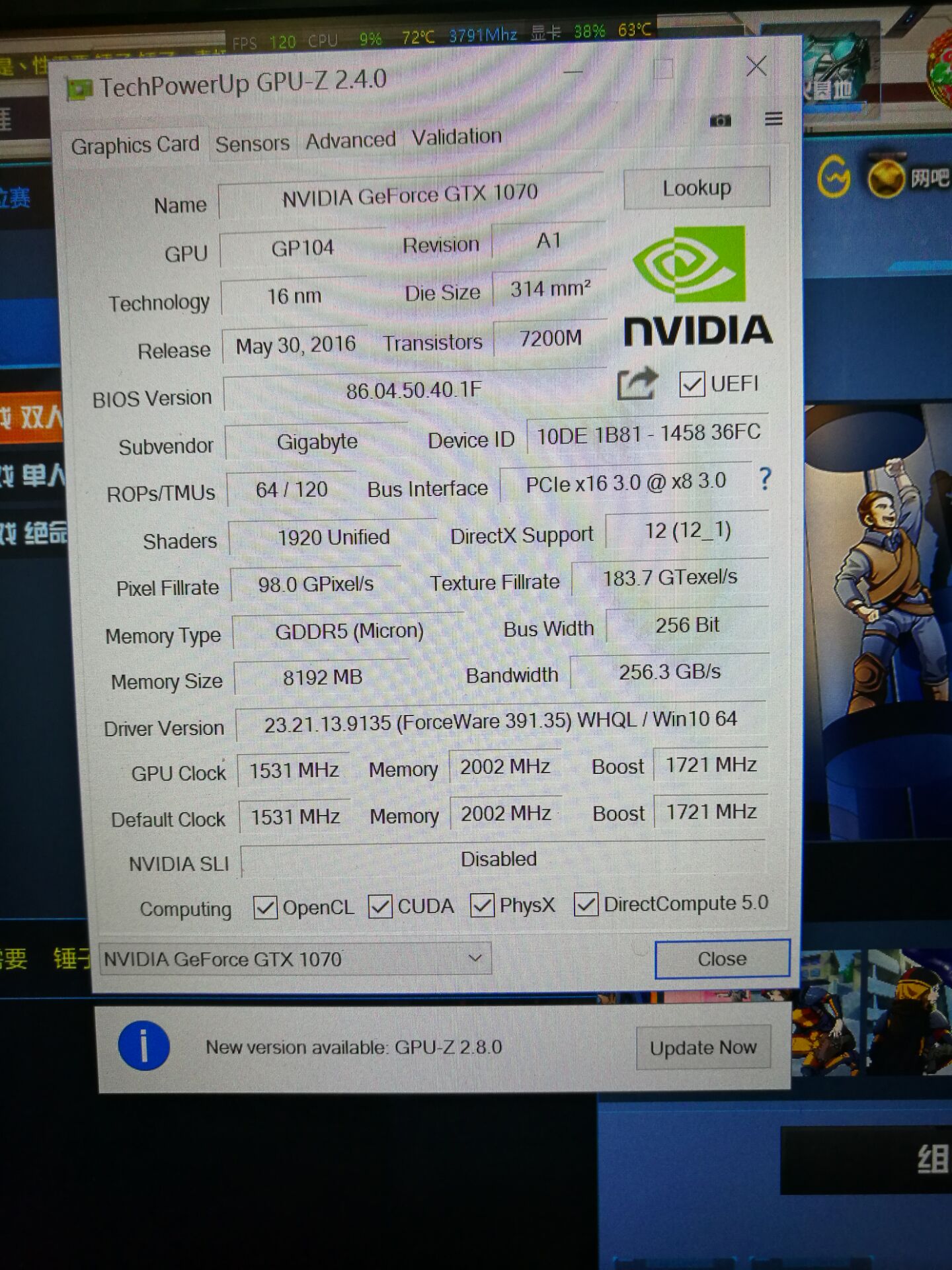

On 16. 4. 2018 at 5:52 PM, Swung Huang said:
still running at 3.0 x8. No compromises
