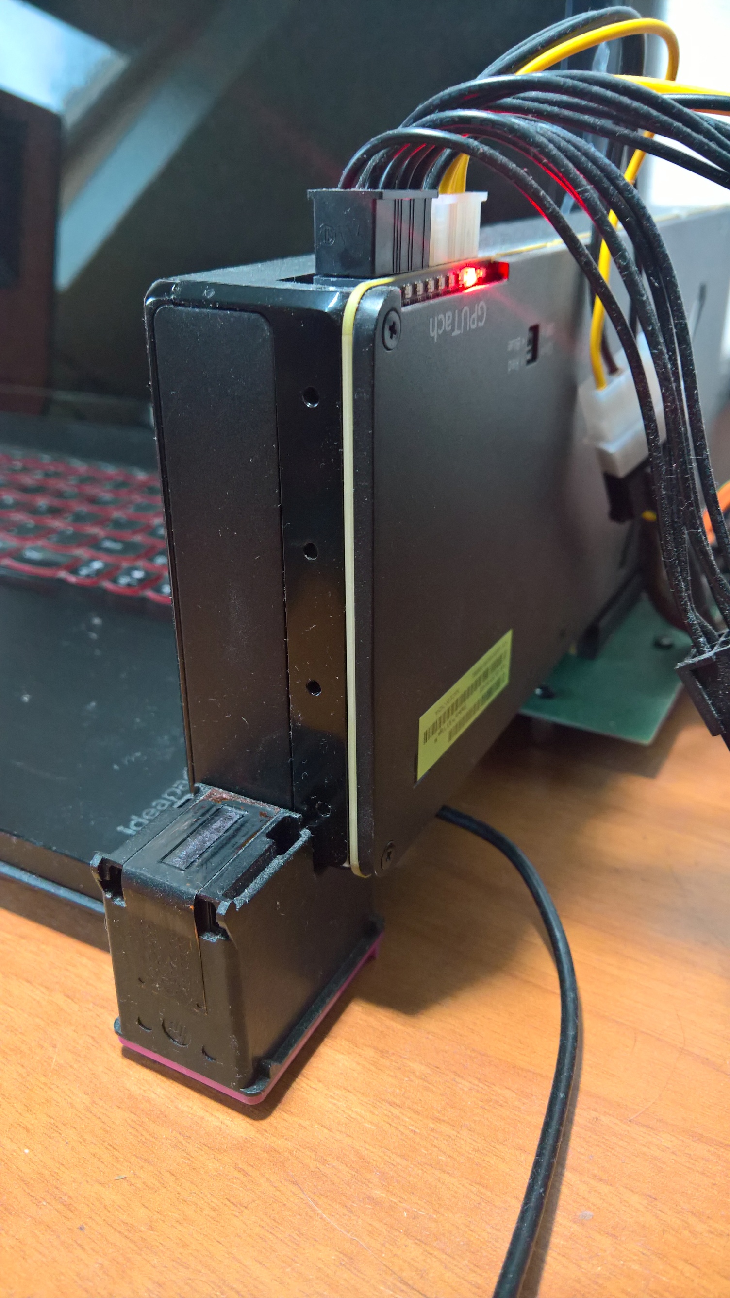

  7. To free up the slot which Gerald's adapter plugs into you would, indeed, need to remove the DVD drive, should you have one in your Y510p. In addition to the adapter itself, you will also need a PSU able to provide your graphics card with sufficient power and, of course, the graphics card itself.

  11. Yours is almost certainly version 2. Three versions of the Y510P Graphics Adapter exist: * Version 1: this is the experimental version which Gerald originally posted about. * Version 2: this is the version that Gerald sold in 2016 and part of 2017. It requires BIOS version 2.07 and Windows 10 to function. Earlier BIOS versions may also work. * Version 3: this is the current version. Thanks to a discovery first posted to the forums by user David 'Soap' Washington, it should work with any BIOS version, as long as one uses an AMD graphics card rather than an NVIDIA one. It may also work Windows 7, 8 and 8.1, in addition to Windows 10. To use an NVIDIA card you of course need the BIOS mod discussed in this thread.
