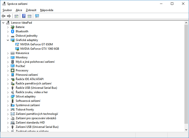

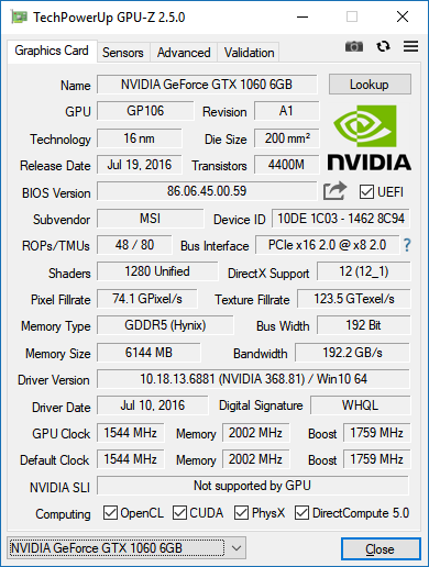

  1. EROR 43. 1060 6gb on Y500 all right. Download driver 368.81,no modify. Clean driver via DDU. in device manager rightclick on the basic graphic adapter on port PCI2, actualize driver, from disc, search driver 368.81,instal. restart. then instal Geforce expirience and actualize. in device manager disconnect GT650m. PS: maybe is possible to instal only newest driver after clean via DDU. I didn´t try. Does anyone know why I have bus interface only x16 2.0 @ x8 2.0 ? Swung Huang has 3.0
  2. Does anyone use nvidia via geralds adapter on Y500. I can't instal driver for 1060 6gb. There is error code 43 device was stopped, in device manager.
  3. How did you instal drivers for gtx 1070? If i instal driver for my 1060 6gb,i disconnected gt650m in device manager,then i instal driver for 1060,but computer selfconnect 650m through instalation and didn't instal driver for 1060. I have Y500.
