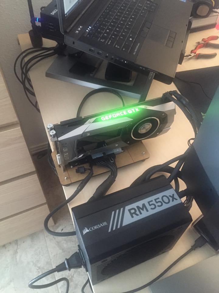

Hi guys,
I am new around here. I just recently bought an PE4C V3 connected via expresscard slot to dell m6800 with quadro k5100m discreet gpu and geforce gtx 1070.
I still trying to get my hardware detected but so far no luck. I cannot see it on device manager.
Tired various things like changing switches on PE4C, uninstalling all drivers. disabling optimus via bios. etc....
I am totally newb so do I need the egpu setup 1.3 to see my card on win 10 device manager?
Here is my setup.
*Edit. There are 4 leds on PE4C. First one is dimming red but it is very faint, second and 3rd one are bright green and 4th one also bright red.
Edited by astrn
2 hours ago, astrn said:
Hi guys,
Here is my setup.
1. Ensure the expresscard is enabled in BIOS.
2. Try hotplugging after boot and/or within Windows followed by a device manager rescan. Ensure the delay switches are turned off if trying this.
3. Try sleeping machine, attaching EC slot, then resuming machine followed by a device manager rescan. Ensure the delay switches are turned off if trying this.
4. Failing that, see if you have access to another expresscard equipped to test if it works. If not I'd suspect faulty eGPU adapter.

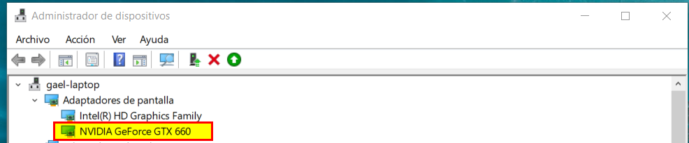

Hi,
I have "PE4C-EC060A V3.0with "Dell D220P AC adapter". It works properly with my "Radeon HD6770" on my laptop "Dell latitude E5540" (Windows 10). I've changed the GPU to Nvidia Geforce 660 and windows detected it and installed the drivers, but is not working. If I plug and unplug the HDMI wire I can see that the monitor detect the HDMI connection but in the end is not showing anything and the monitor turns off.
I checked the compatibility tables and I think that it should work:
http://www.bplus.com.tw/Adapter/PE4C V3.0.html
Any ideas?
Thanks in advance.
