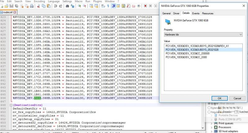

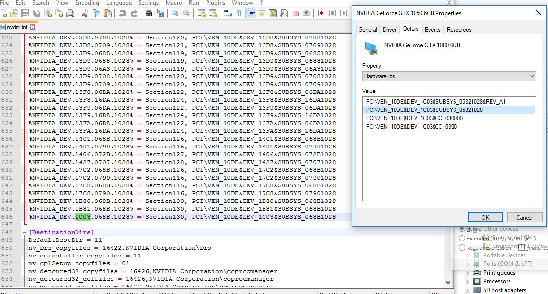

  2. I change switch my PE4C 3.0 SW 1 = 2 SW 2 = 1 For different purpose And this happen When I check nvdmi.inf could I enable optimus ?

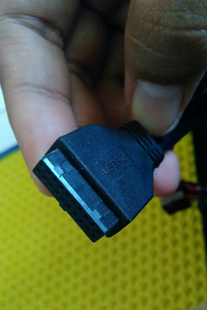

  5. Could PE4C 3.0 use usb cable from CM elite 130 ? The Picture shown below

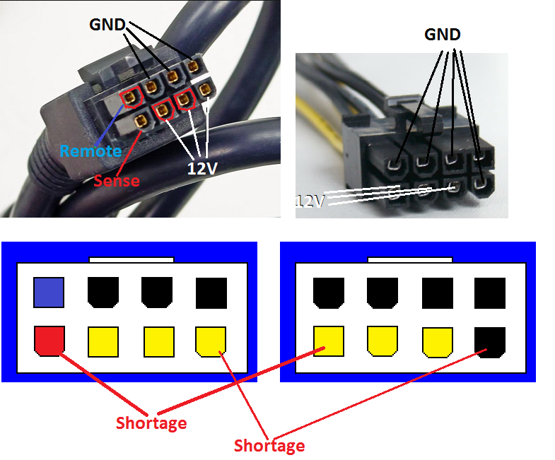

  8. Hi guys. I'm just wondering How to check 12V of dell da-2 with multimeter ? Is same as PSU atx ? I have been tried. This psu haven't power on (green pin) like psu atx. So I dont need power on the dell psu. Instead I plug yellow pin (12 V) with red cable and black cable from multimeter into ground pin according the images. And the result show 0V instead of 12 V ?????? What's wrong with me ? Update: I got it guys. Try plug remote and ground pin Thank you.

  13. Finally my PE4C 3.0 can suit CM elite 130 case Build eGPU PE4C 3.0
