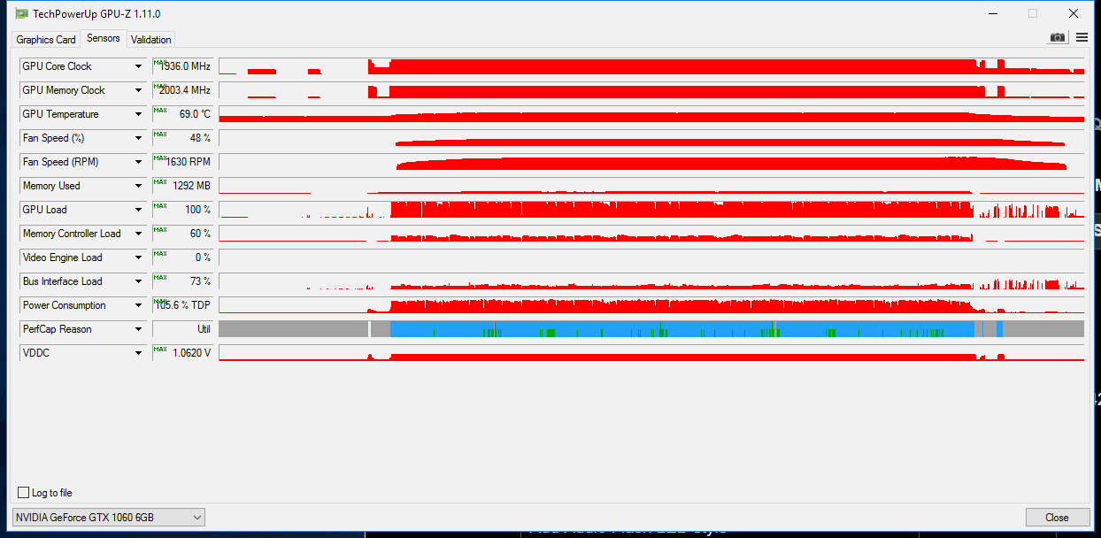

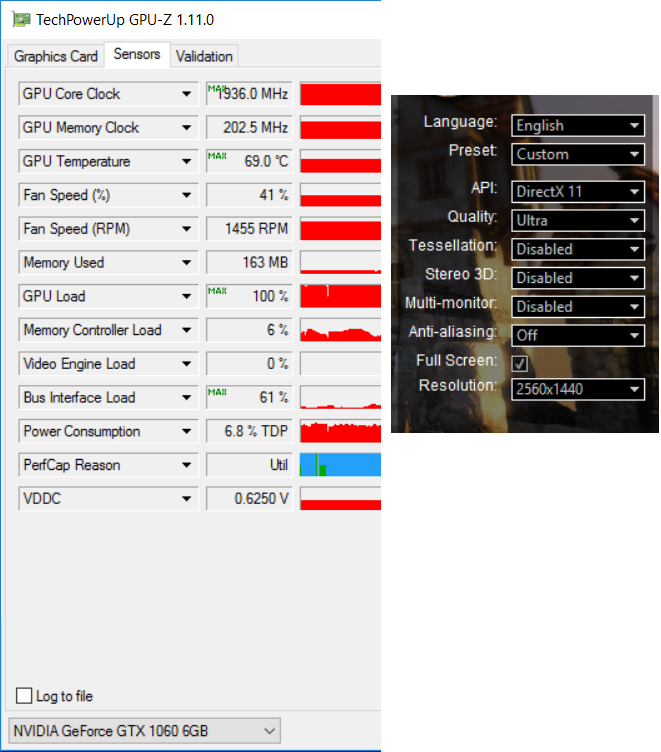

I'll chime in in case it's helpful. I'm running X230 i5 8GB with PE4C V3.0 Expresscard and a Gigabyte GTX 1060 6GB mini connected to a PB258q. I set Windows 10 to output to Display 2 only (external). I'm using GPU-Z to measure Bus Interface Load and reaching a max of 73% during gaming. My synthetic score is below. I'm looking for ways to improve the performance even further. Unigine Heaven Benchmark 4.0 FPS: 32.2 Score: 810 Min FPS: 7.5 Max FPS: 63.4 System Platform: Windows NT 6.2 (build 9200) 64bit CPU model: Intel(R) Core(TM) i5-3320M CPU @ 2.60GHz (2594MHz) x2 GPU model: Intel(R) HD Graphics 4000 10.18.10.4358/NVIDIA GeForce GTX 1060 6GB 21.21.13.6909 (4095MB) x1 Settings Render: Direct3D11 Mode: 2560x1440 8xAA fullscreen Preset Custom Quality Ultra Tessellation: Extreme -
yes! glad you pointed this out. thanks! btw, how do you know if the expresscard is using gen 1 or gen 2 settings? Unigine Heaven Benchmark 4.0 FPS: 32.2 Score: 810 Min FPS: 7.5 Max FPS: 63.4 System Platform: Windows NT 6.2 (build 9200) 64bit CPU model: Intel(R) Core(TM) i5-3320M CPU @ 2.60GHz (2594MHz) x2 GPU model: Intel(R) HD Graphics 4000 10.18.10.4358/NVIDIA GeForce GTX 1060 6GB 21.21.13.6909 (4095MB) x1 Settings Render: Direct3D11 Mode: 2560x1440 8xAA fullscreen Preset Custom Quality Ultra Tessellation: Extreme
