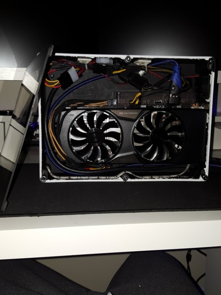

  2. A while ago I wrote about how my Mac was crashing with my newly built eGPU. I've possibly narrowed it down to being an issue with extending the HDMI cable that comes with my PCIe video card dock. I'm trying to figure out why this happens. The case I built was designed to have all the wires coming out of the back of the unit. However, because the PCIe adapter HDMI cable is so short, I'm not able to route it the way I want. The wire now oddly sticks out from the top of the case and it just keeps bugging me. I bought a HDMI extension cable to add length to the wire. Sometimes it boots up fine, sometimes it doesnt. Sometimes it will work for a good 15 minutes then suddenly freeze or reboot. I don't understand why the wire would degrade the signal so much. I thought the signal doesnt degrade much with digital signals and that's why HDMI is so great. I've tried several HDMI extension cables and adapters but nothing will keep the device stable. Even if I bought a longer cable from the makers of the PCIe dock, the end of the HDMI cable needs to have a downward facing male end because that's the only way the case will close properly in my situation. So you see, I need a very specific cable for the job. The only way I can achieve this is by 3rd party extension and adapters. I occasionally get a random reboot if I have the PCIe dock HDMI cable connected to a downward facing, 90 degree angle HDMI male adapter but it doesnt happen all the time. Still, when it does it is very annoying and I lose whatever I was working on. If I use the adapter + an extension HDMI cable, the GPU wont boot at all; just get a black screen. But if I use an HDMI extension cable that has a downward 90 degree angled male end already designed into it already, it will sometimes boot but would crash more frequently. Can someone explain to me what is happening? It's pretty frustrating that my project is 99% complete and this one thing is holding it back from truly being done.

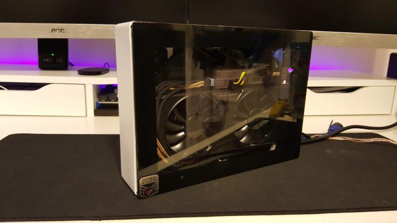

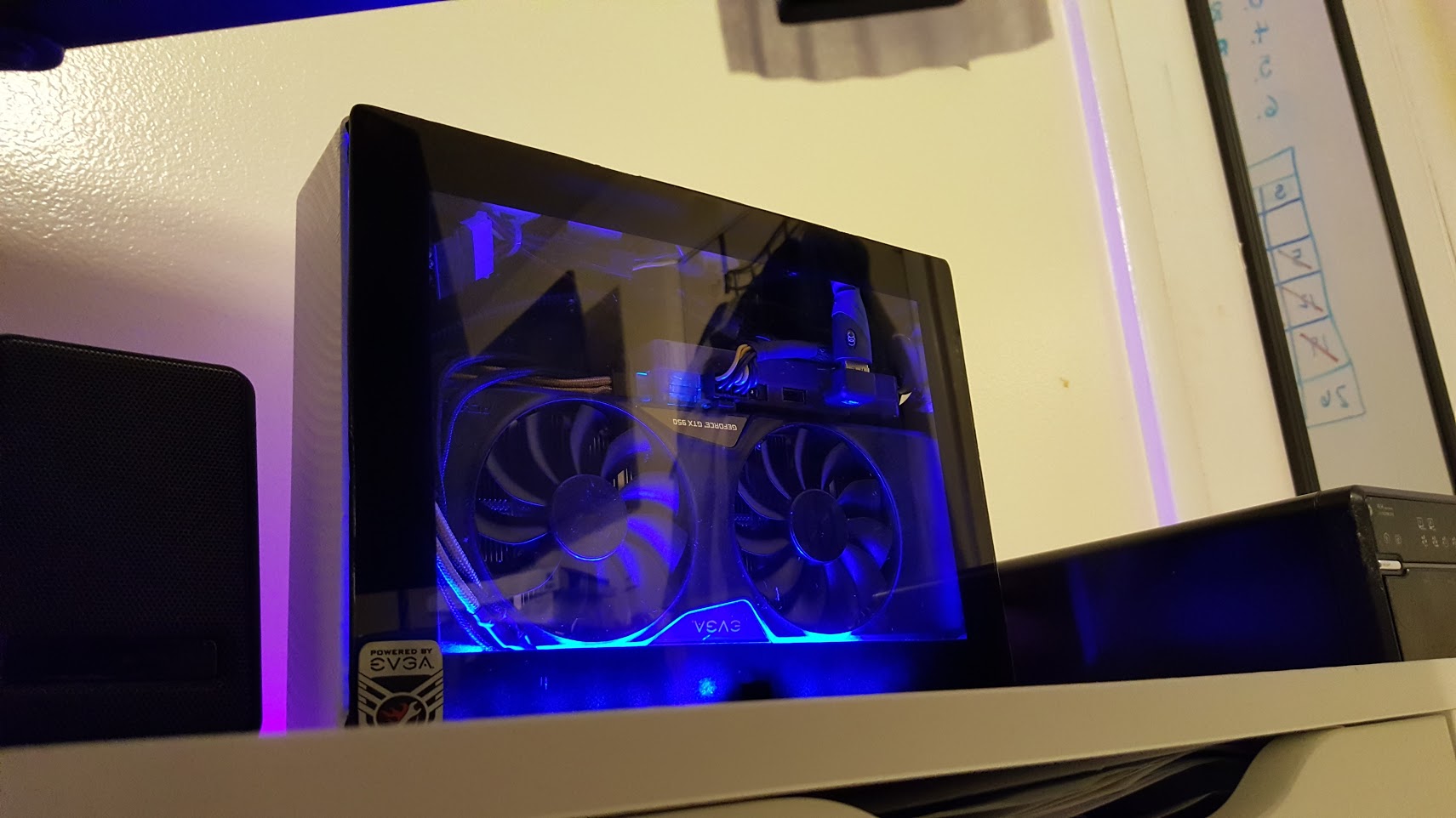

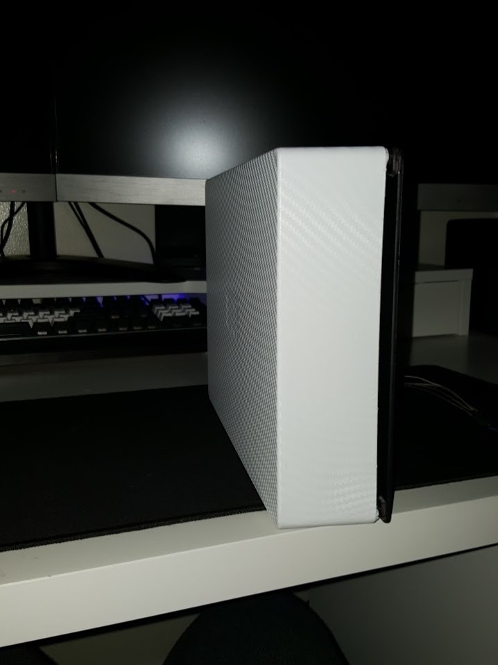

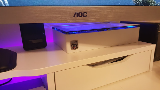

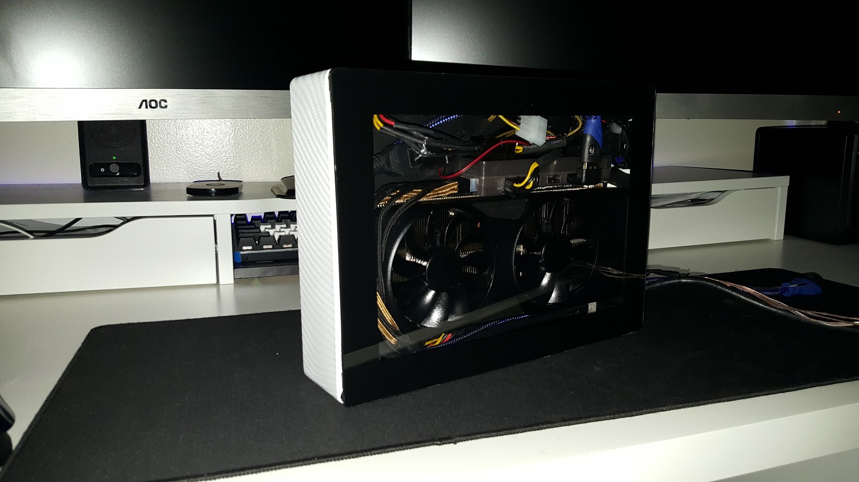

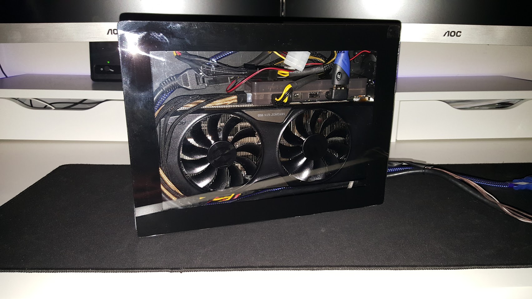

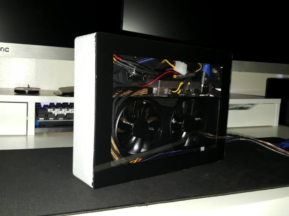

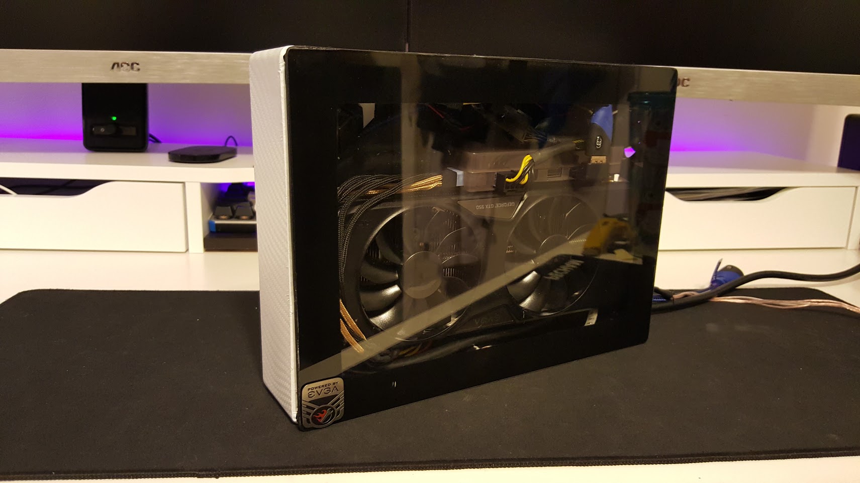

  3. Spent a week or so working working on this case. I have a EVGA GTX 950 SSC inside and it was challenging getting it to be as sleek as I wanted. Overall though I'm really happy with the results. Currently the eGPU is laying flat down and I've settled on this position for the case. At least this way I can see a lot more of the white carbon fiber vinyl I put on it. Just a few more pictures...
