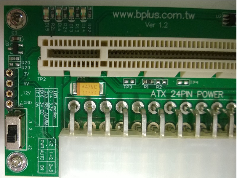

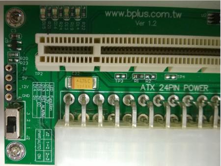

In the meantime, perhaps you could post a few close-ups of the adapter all connected up, and also one showing the cabling to the GPU itself. Thanks so much
scott
[ATTACH=CONFIG]13154[/ATTACH][ATTACH=CONFIG]13155[/ATTACH]

PE4C 2.1 has 4 power input possibilities: (1) DC jack (2) Dell DA-2 jack (3) ATX EPS 4pin CPU connector and (4) ATX 20/24 pin systemboard connector.
This differs to your PE4C 1.2 that has only 2 power input possibilities (1) ATX 20/24 pin systemboard connector and (2) 4-pin floppy molex connector.
Incidentally, the "four tiny holes labeled 3v, 5v, 12v, GND" are test points useful to do circuit board power validity checks with a multimeter.
