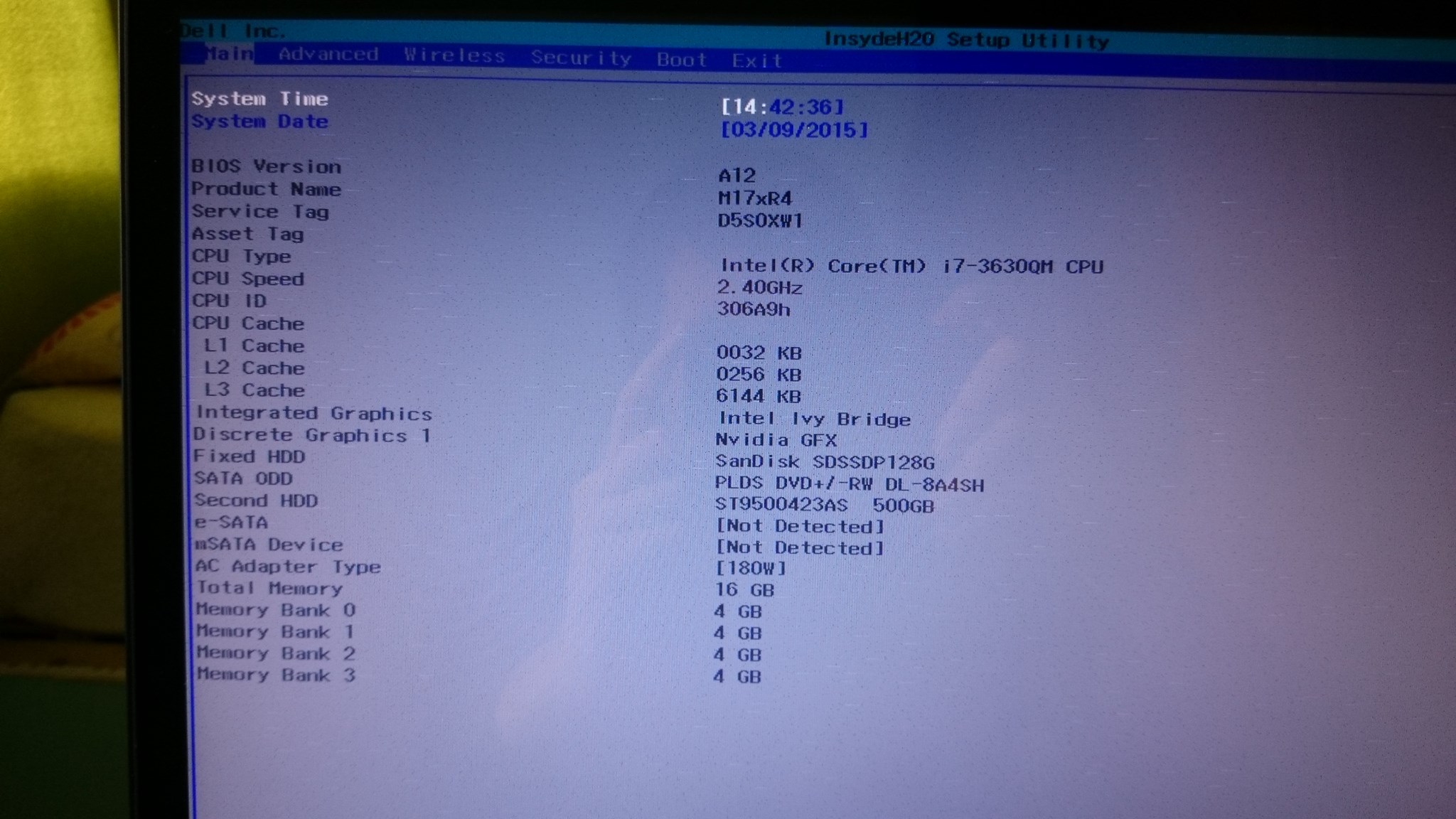

Hi I have M17x-R4 with HD4000 and GTX 660m. Want to upgrade to 680m. I have three pipe heatsink but don't know if its 100W or 75W. Also I have 180W ac adapter and I think it's not enough for this card. So I should to buy 240W ac adapter. BIOS version is A13. It mus be all right, and VBIOS I have got no idea, but I ask seller to flash it for M17x-R4.
But my biggest problem now is with shared graphic card HD4000. I have grainin screen. Not everywhere. Most on the place where colors are change. If I use wrong pixel test and display only one colour, then everything was good. If laptop is cold and I switch it on after one or more hours then screen looks like with 256 colours only. Then after temperature grows it better and better but dithering really never disappear. I try to upgrade drivers, flash BIOS but nothing helps. Only if I switch HD4000 off with FN+F7 and using only GTX 660m, then screen is without problems. Sorry for my english, but I learn this language only half year from South Park series :) So can anybody help me with this? I mean with this video cards :)post-33593-14494999663057_thumb.jpg
