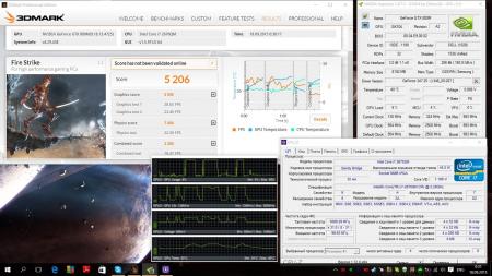

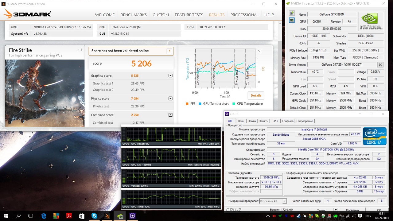

  3. I would like to share my upgrade! And so it went very well the only problem that I encountered it was the driver. PSU enough I have it 240 watt. The cooling system was 75 watt and I thought it will not be enough and it turned, everything works fine, the maximum temperature of 82 degrees video somewhere stable works 70 - 75, of course I have already ordered a 100 watt cooling system. And so every running game that loads the video card and I run speedfan and put coolers 100 percent. Yes, the company bought the card it`s Clevo and i not update vbios of this card for Dell, because it is not found. The charge of the combat capability of this screen)
  4. This is my result. My laptop: Dell Alienware M18x R1 2670Qm\8Gb(Kingston 1886Mhz)\Clevo GTX 880m 8Gb\120Gb SSD\512Gb HDD\240w + Zalaman ZM-NC3500 Plus... and my screenshot...
