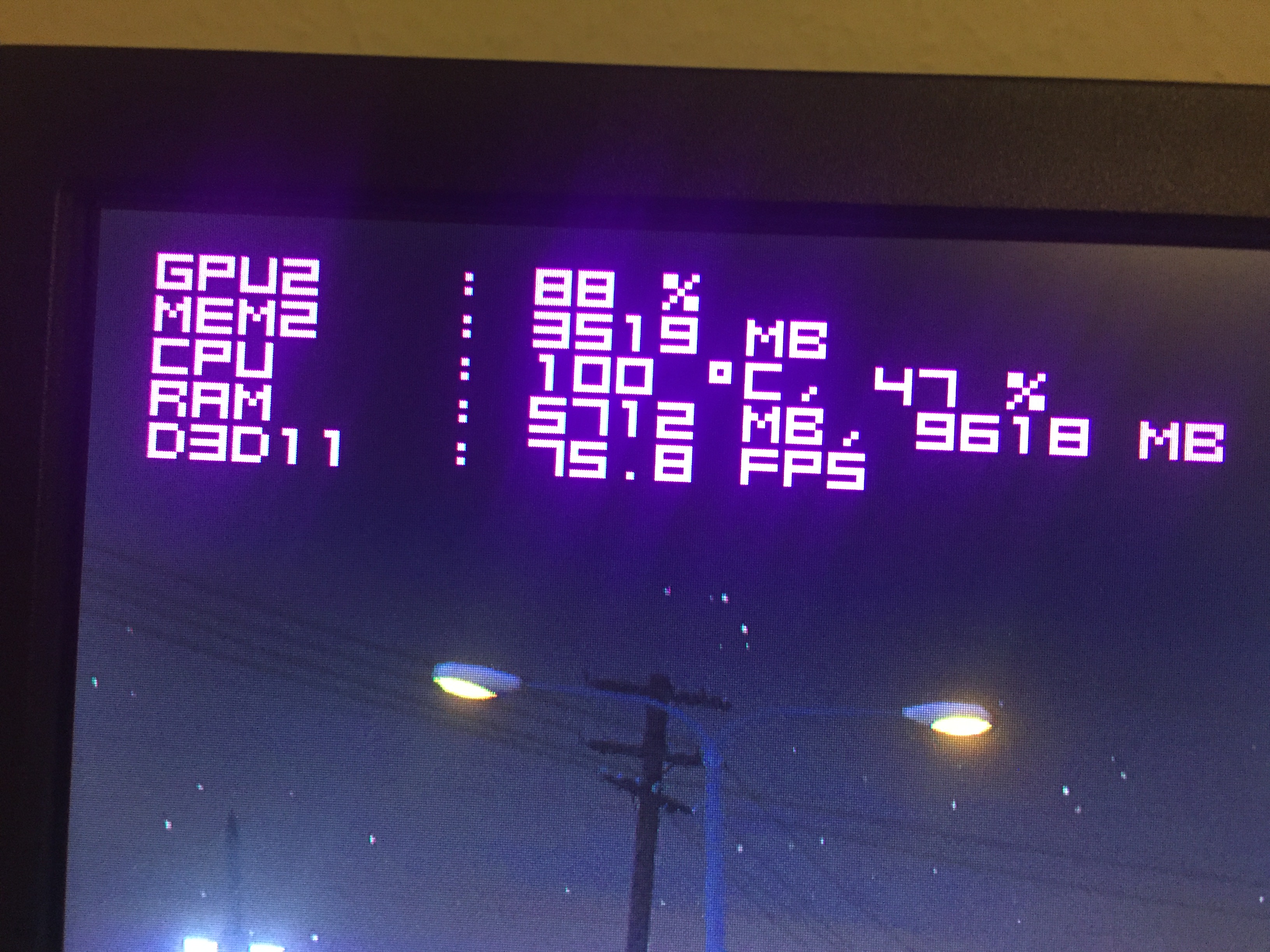

So guys... I think that I have a problem.
On the picture you can see that my CPU is on the max. 100 °C  (212 °F) at 45-65% operating grade!!!!
Do I have dust in the case of the MacBook? because I dont think this is a common temperature for this operating grade.
Does this bottleneck the GTX 970? because the GPU runs in average about 75-102%
picture (while playing GTA on high Settings)
@eGPUfan unfortunately that is normal. Especially GTA V has a high CPU load.
Look at IFixit for changing the thermal paste and change it with Arctic MX-4 or a different wellmade thermal-paste. Did it 1 week ago, was fairly easy to do and lowered my temperatures by 10° idle and load @late2013 with 750m. Before my Macbook throttled at 100° in GTA5, now it achieves in highest case 92° but without throttling... When you see the way Apple applies their thermal paste and how fcking dry and cracky it is, you realize why that great difference is possible.

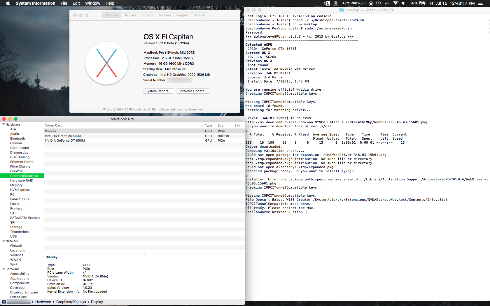

I'm trying to run something similar to @Barzenberg but I get no output on my external monitor after restarting. The monitor isn't even recognized as another display on the mac. The system report doesn't list the GTX 1070 under Graphics/Displays, just the name Display.
@goalque Did I do something wrong with running your script? See attached pic
Specs for reference:
Mid 2012 15" MBP i7
Akitio Thunder2
500W PSU
Gigabyte G1 GTX 1070
LG 34" Monitor
1 hour ago, justified said:
Hi guys,
Mid 2012 15" MBP i7
Akitio Thunder2
500W PSU
LG 34" Monitor
Nothing wrong, but there are no os x nvidia drivers for gtx1080/1070 atm.
