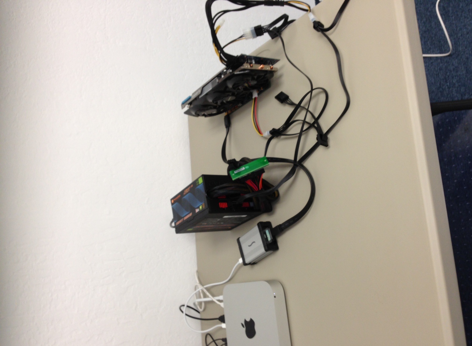

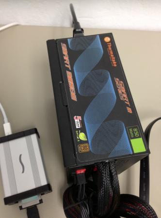

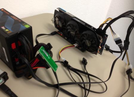

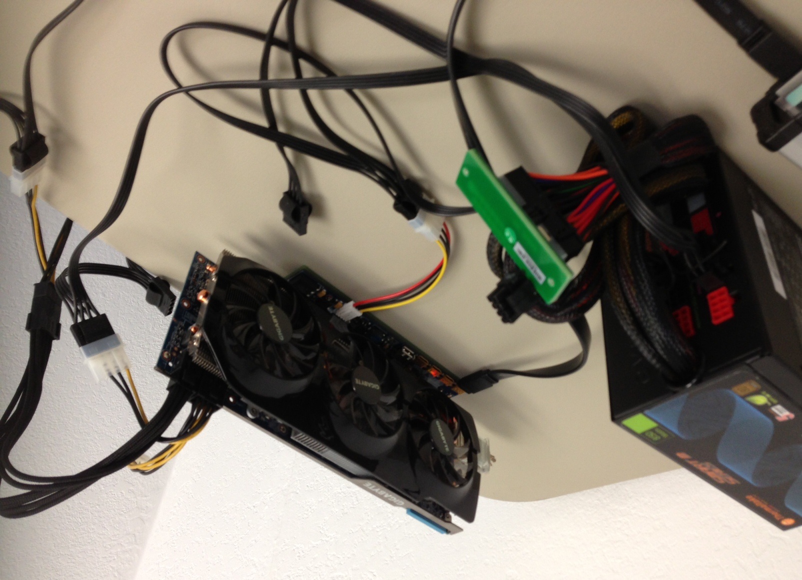

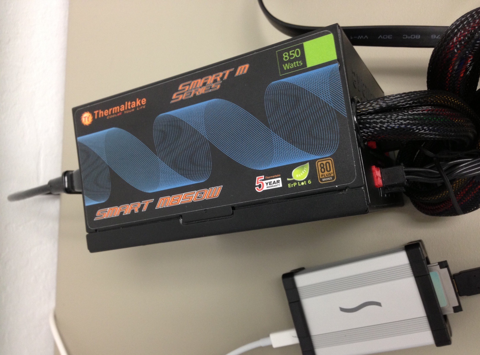

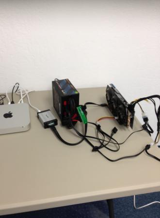

The Problem:
eGPU fan isn't starting and the system is unable to detect the card.
For now lets assume that I can get the card detected if it is properly powered up and the fans are working.
System Setup:
OS: Windows 7 64 Bit
System: Mac Mini - Running on Boot Camp
Ram: 16 GB
eGPU: AMD Gigabyte Radeon 7970
PSU: 840 Watts, 70A, +12V
Cabling Approach: Thunderbolt -> PCI-E Card Reader -> PCI-E HDMI Converter -> PE4H; PSU provides power to the PE4H as well as to the eGPU itself.
Current Status:
I am currently able to get lights D2, D3, and D4 to green, but D1 is red. I would love to know what that means as it might provide insight into the problem. This occurs when both the PSU is on and when the PCI-E card is plugged in through thunderbolt+adapter. If PSU D4 goes off, if adapter is disconnected and PSU is on I get faint red light on D1 and a green D3.
Note: The card does heat up, but the fans don't spin.
Query: Could it be a bad PE4H board?
Random Question: Should I be worried or checking jumper status, if so what should it look like?
What I Have Tried/Done:
eGPU drivers installed.
Attempted swapping out numerous cables and even the eGPU itself to see if it was a bad card.
Restarted OS and tried numerous timing combinations of turning things on and connecting while booting.
Looked through FAQs, run google searches...
Attached are images of my setup.

D1 = RED means PERST# is activated. That should remain on for whatever you set the PERST# delay using SW1=1 (off), 2=6.9s or 3=15s. I'd suggest set it to 15s. The power-of sequence should be:
1. Power on eGPU.
2. Power on Macmini
3. Halt Win8 from loading by hitting F12. Wait for PERST# LED (D1) to turn off.
4. Continue loading Win8.
The eGPU fans not turning means 3.3V isn't getting through to it. Try hotplugging the powered eGPU into the Sonnet Expresscard adapter. Does that see the fan start? If no I'd suggest test the PE4H + cable on an expresscard-equipped system. Note too that a PE4L 2.1b is recommended over a PE4H 2.4a for your purposes as it's pci-e 2.x capable. PE4H 2.4a can only reliably transmit pci-e 1.x (Gen1) signals.

Thank you for taking a look at my problem personally Nando4!
Alright I figured out that the PE4H adapter was bad and replaced it, and that fixed the fan problem, and the rest of your input especially the boot order was very helpful in detecting the eGPU. However, things aren't quite working yet.

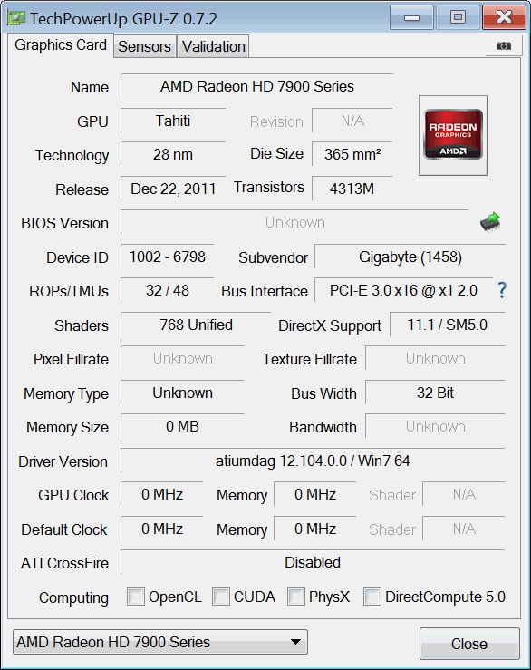

This is what gpu-z is telling me:
