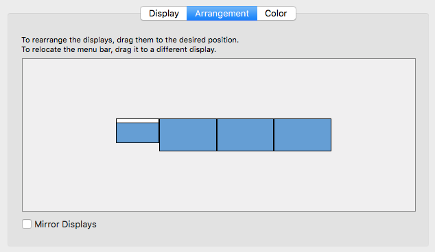

What a time to be alive! In the mean time, I'm taking it to the next level: So far so good, even though both TB ports are being used. If eGPU proves to be stable enough, I will try to get some nice displays and hook them up directly via the GTX.
