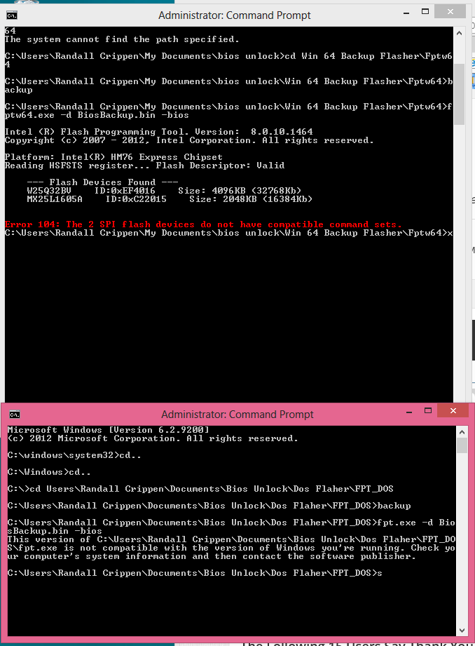

Hey svl7 - I just got my Lenovo y500 and I am wanting to overclock. I am trying to unlock my bios but when I go to run the backup utility either it is not working or I get an error.
Running the windows one from a command prompt give me error 104 - the SPI flash devices do not have compatible command sets.
Running the DOS version from command prompt tells me that it is not compatible with the 64 bit version of windows. any ideas what I could be doing wrong? Thanks for the help!

[ATTACH=CONFIG]6361[/ATTACH]
Nevermind - found the answer in a previous post! :)
