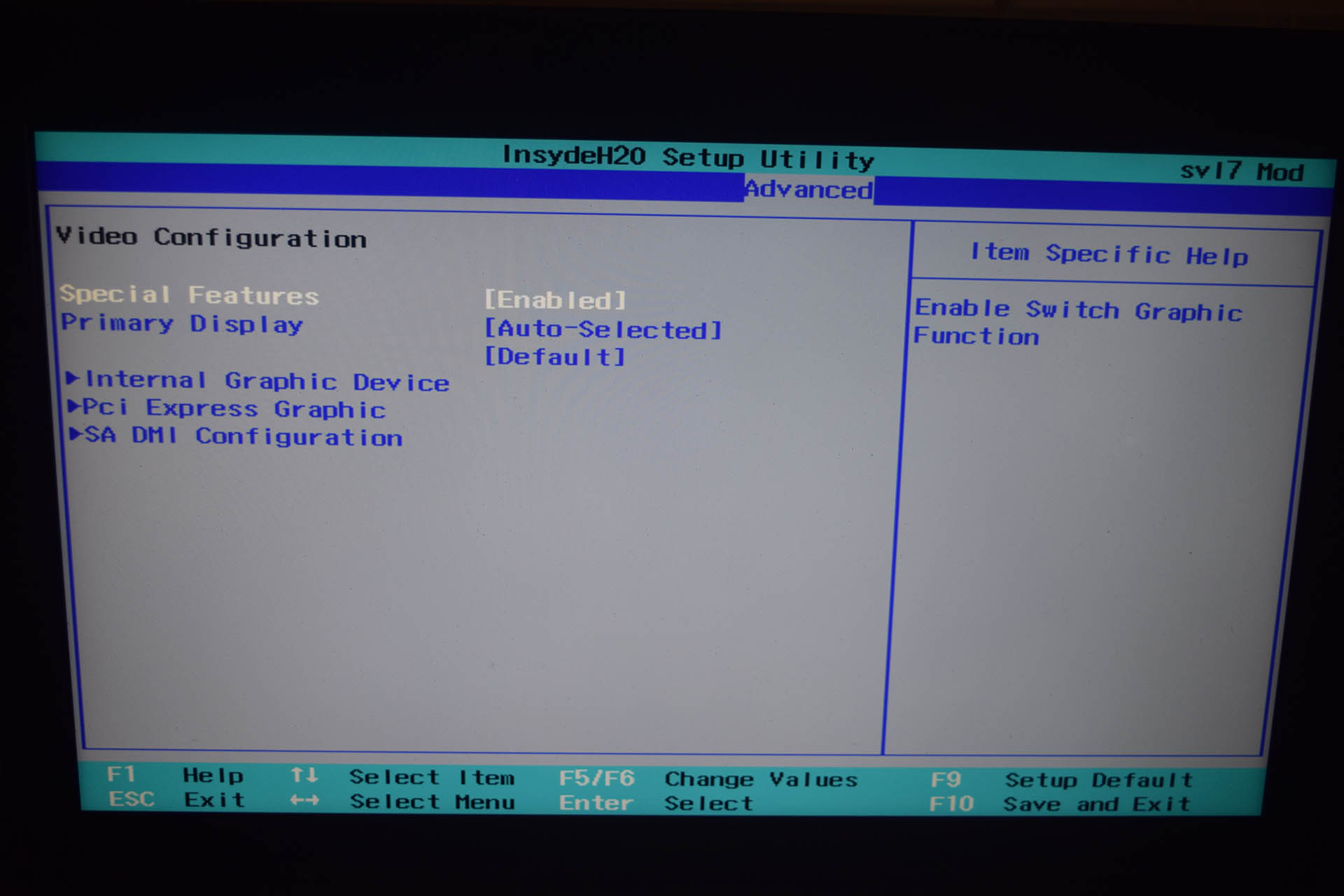

  5. Oh, if anyone was wondering, I figured out how to have both cards running at the same time. If you go into your BIOS and go to Advanced, then Video Configuration, and Enable 'Special Features'. This will allow both the GT750M/GT650M and whatever other card your running in the EXP GDC to run at the same time. In Windows 10 it seems to cause an occasional blue screen, but that could also be my faulty USB network adapter.

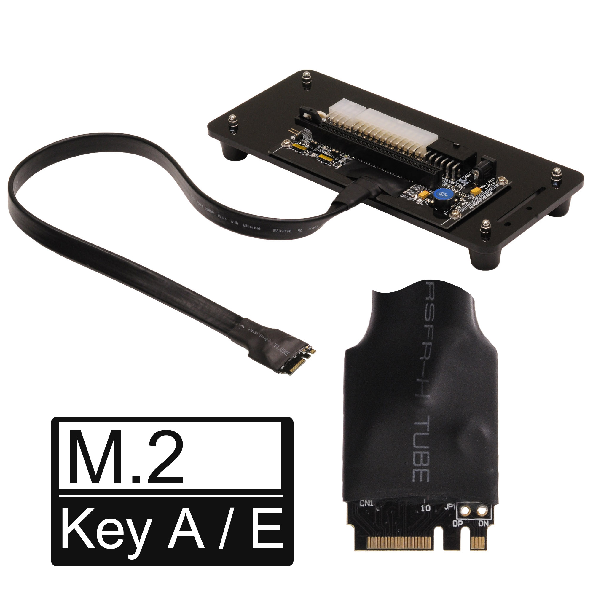

  9. Yo lappytoppins has a m.2 port there... Specifically, the m.2 key e This is what you need, the v4.1 with the m.2 adapter.
