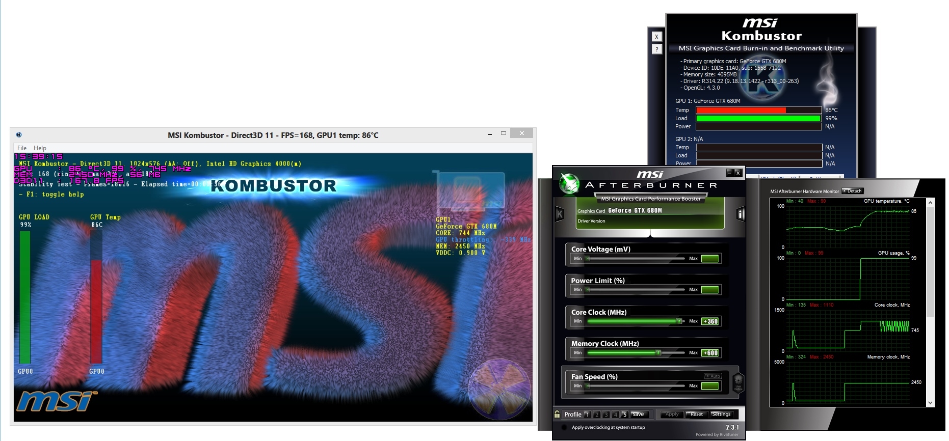

I can try other tests if needed but my time is limited due to finals this week. My problem is auto-throttling, but I am going to use foil tape on the heatsinks to close the gap between fan exhaust and the heatsink, and closed-cell foam to recycle less warm air, once the things arrive tomorrow or mid-week. Hopefully this will cause less throttling.
(disregard the 50MHz discrepancy on the sliders on MSI Afterburner and what's showing for the memory clocks, I used Nvidia Inspector to adjust the clocks)
