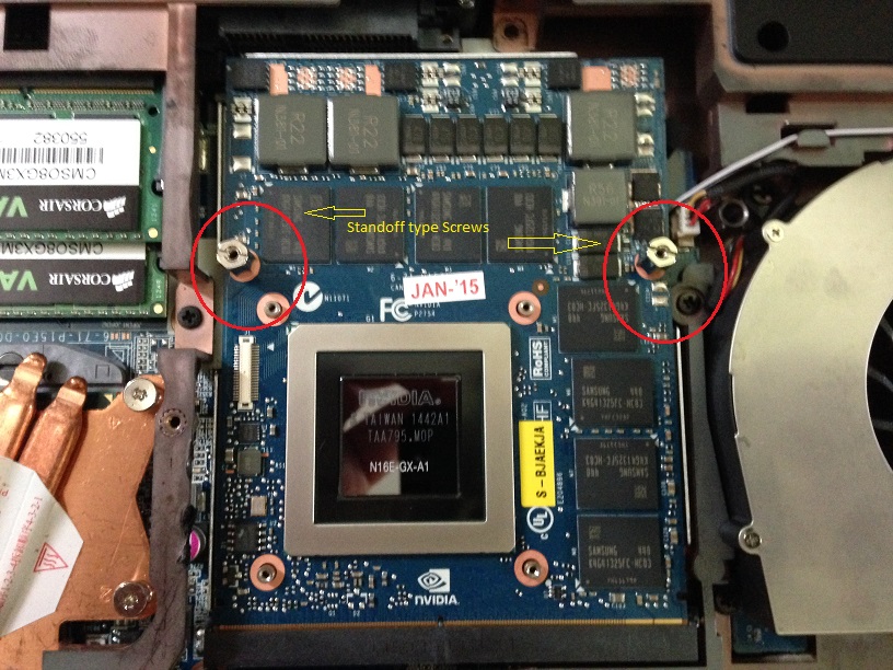

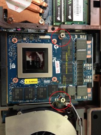

  8. it's pretty simple, 1. Open cover 2. remove screws holding gpu heatsink (core & mem), remove heastinks core first 3. remove gpu screws, they are a standoff type screw that the memory heatsink screws into. See pic 4. remove original gpu and replace with new gpu. make sure you install at a 450 angle. Secure with gpu screws (there will be some slight pressure as the card in pushed flat, alternatively hold card flat and tighten screws) 5. install new memory heatsink - ensuring to remove the plastic covering the thermal pads 6. install new core heastink - ensuring to remove the plastic covering the thermal grease, or clean off thermal grease and install some of your own choice. (I just used the stock grease and have only seen 740C under load) 7. close cover 8. boot and install drivers listed in thread - in device manager the card will be listed as Microsoft Basic Display Adapter until you install the drivers 9. enjoy your superfast laptop Its all in the service manual here anyway. http://forum.techinferno.com/clevo/3837-%5Brepair%5D-clevo-service-manuals.html <---- Pick your model Pic
