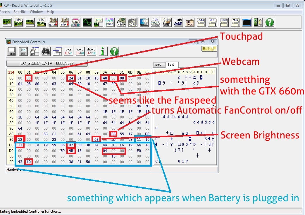

Hello guys, it's me again. I just tried again to figure out, which values are for the control of the fan... I noticed that no adjustment made any effect... except for one value. I can turn on/off the automatic fan control... But if I turned it off, the fan just stayed off and I couldn't change anything except turning the automatic fan control on again Here is a screenshot of what I found out with RW-Everything -all red marked values are changing under normal use of the Y580 (I could assign some of them) -the red marked in the blue bounded values only appear when the battery is plugged in Maybe somebody has an idea what I could do now? Any experts concerning the embedded controller? Is this a type of ''locked EC''? because no changing did take effect expect for the one mentioned above Edit: informations I found in RW-Everything: [Cooling Device] (Type 27) 1B 0F 34 00 FF FF 63 00 00 00 00 00 D0 07 01 43 ..4...c........C 6F 6F 6C 69 6E 67 20 44 65 76 69 63 65 20 44 65 ooling Device De 73 63 72 69 70 74 69 6F 6E 2E 00 00 scription... Type....................................... 0x1B (27) Length.....................................0x0F (15) Handle.................................... 0x0034 (52) Temperature Probe Handle.....0xFFFF Device Type and Status......... 0x63 Cooling Unit Group..................0x00 OEM-Defined.......................... 0x00000000 Nominal Speed........................0x07D0 Description String1 - "Cooling Device Description."
