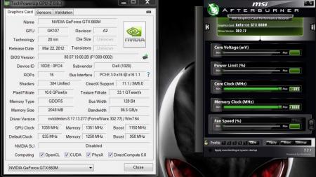

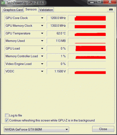

Anyway, the Clevo 660m works a G75VW vbios... and pretty well, here's a run @1200MHz: http://hwbot.org/image/815912.jpg
Yesterday I managed 1330MHz, with some more voltage :D

Yeah, I did, but I can't overclock the card per software in my system, so I just cranked up the clocks in the vbios, hahaha, got it stable up to 1330MHz (at least stable in 3dMark11).

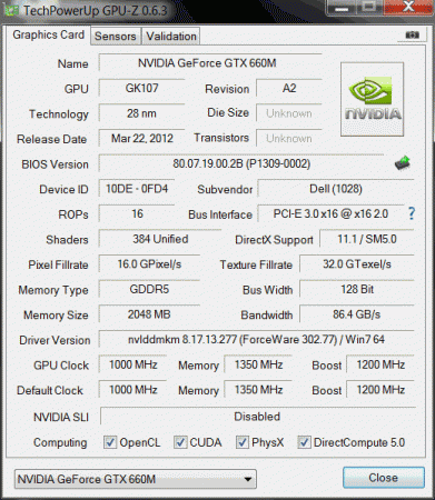

Hi svl7, I have just installed a Clevo 680m 4Gb in an Alienware M17xR3, and it works really great (http://forum.techinferno.com/alienware-m18x/1860-incoming-clevo-680m-4gb-aw-m18x-r1-3.html#post23778).
I am puzzled that the vendor ID is 1028 (Dell), instead of 1558 (Clevo), Do you think it will be possible to flash it with the Dell Bios (I know Dell cards only have 2Gb, but I think the nvidia bios just check whatever memory you have)?, the idea of flashing it with dell bios it is to recover the 3Dvision in case Dell chooses to support it, or if in the future I buy a M17R4 motherboard.
Thank you very much in advance for your time. Julian
Well, hahaha, that explains a lot... for some reason they seem to flash all card for AW users with the Dell vbios, even the 7970m... LOL. Seriously, as if this would solve all the possible issues (it doesn't). At least it allows you to use the Dell drivers, well... if you want you can still flash a Clevo vbios.
