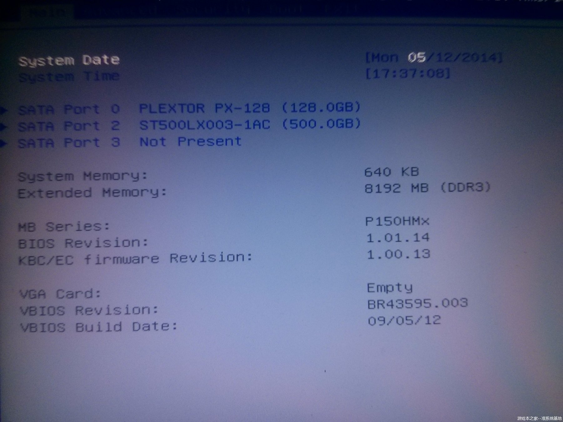

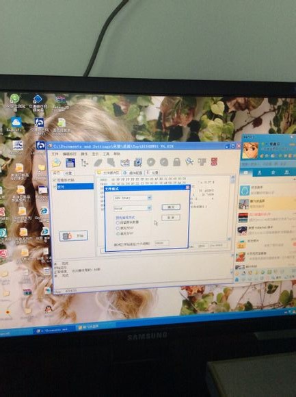

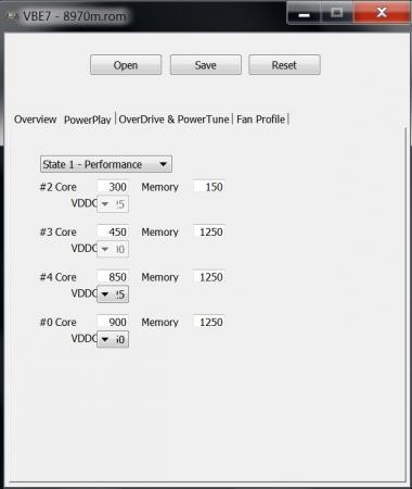

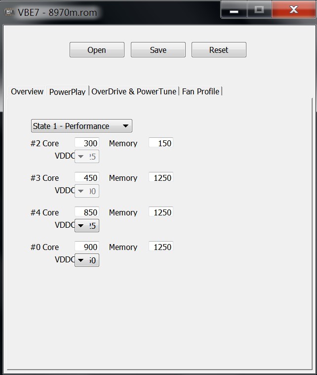

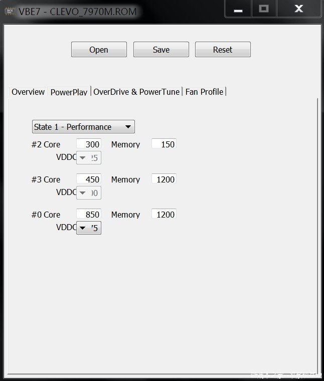

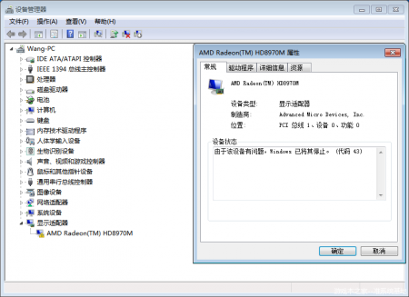

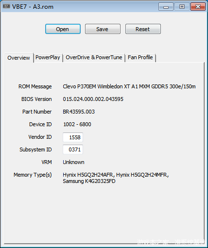

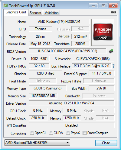

  1. Clevo 8970m in P150HM clevo 8970M BIOS and EC After the brush into the 7970M vbios GPU-Z Show vbios version Type Test Results 1: 8970M vbios can not start the machine 2: brush into the 7970M vbios: vbios structure with Samsung memory types, the successful launch of the computer and enter the system, can blind brush vbios. vbios structure is not with Samsung memory types, not start the computer, not blind brush vbios. 3: Blue Dell vbios same circumstances Question After win8 install the driver code to display a blue screen : SYSTEM THREAD EXCEPTION NOT HANDLED Now the problem can not install the driver, enable the device win7 64 display problems Can not be enabled devices - - - Updated - - - @Prema If you can help solve this problem ?

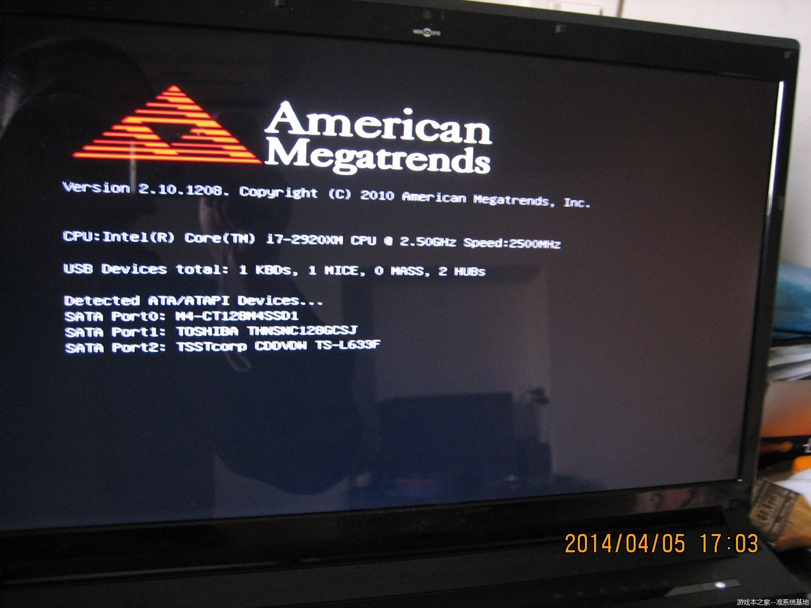

  4. Please you look at this mod `(* ∩ _ ∩ *) ' What are your views? P170HM CPU cooling & 2920XM overclocking - - - Updated - - - Here Soldering 179 degree temperature low copper aluminum copper and aluminum wire rod http://item.taobao.com/item.htm?spm=0.0.0.0.2oTSHd&id=7036302996 http://item.taobao.com/item.htm?spm=0.0.0.0.p7LVfw&id=7039988520

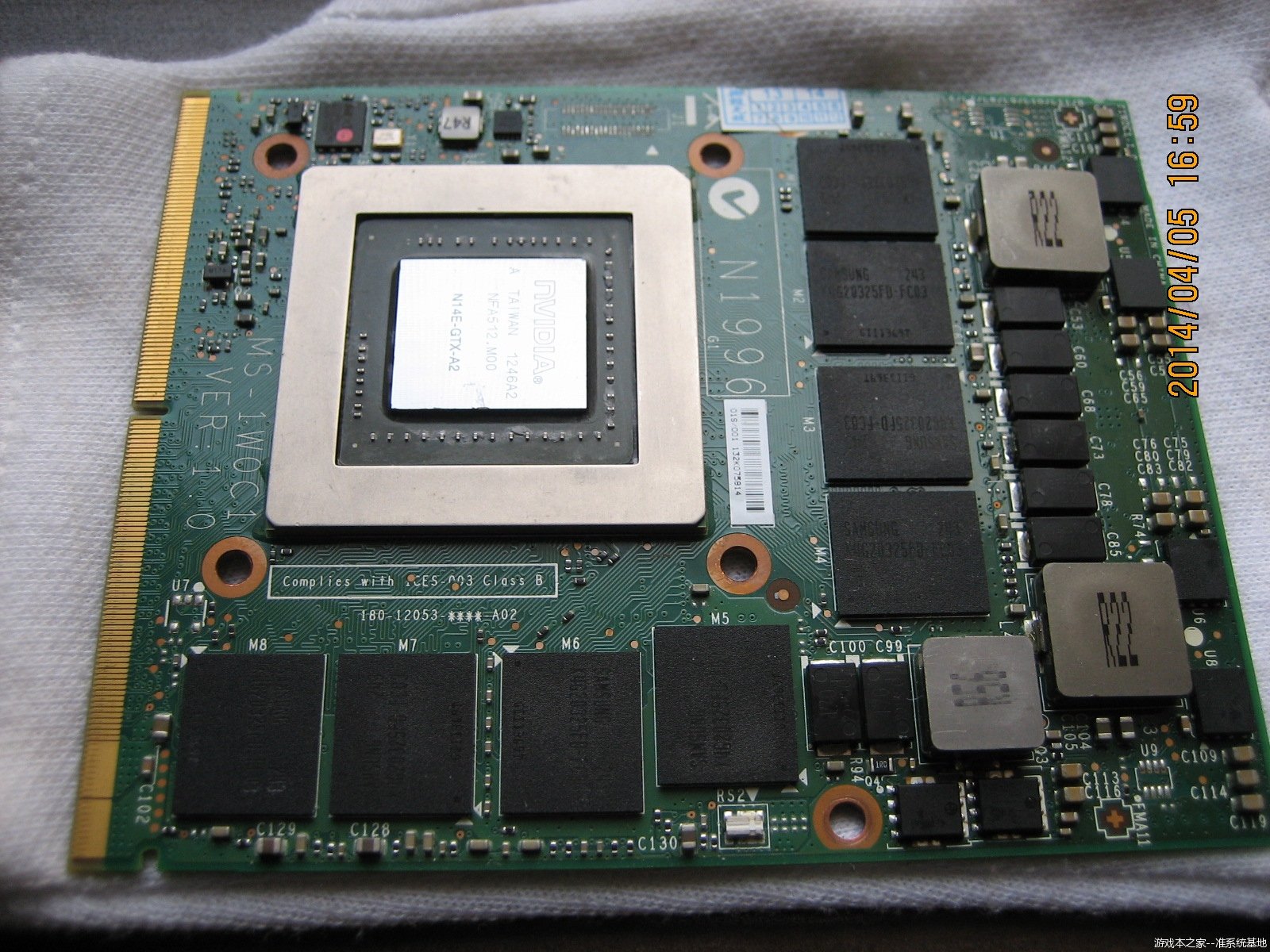

  5. MIS GTX780M in P170HM msi GTX780m VBIOS size of 88KB Turn on the computer , Normal through the first boot logo Enter the BIOS menu normal Successful start into the second LOGO...........After staying on this screen, can not boot into the system. . . . @Prema There is no way to solve?

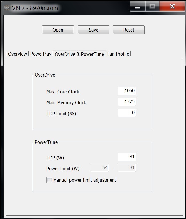

  6. vBIOS Editor for Radeon HD 7000 series cards Support 7970M 8970M vbios modified clevo 7970M 超频和修改vbios教程 VBE7.0.0.7b.zip

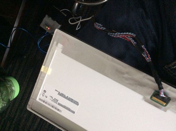

  8. luoxia

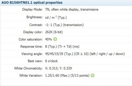

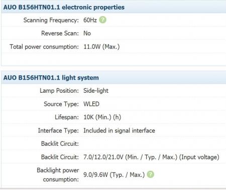

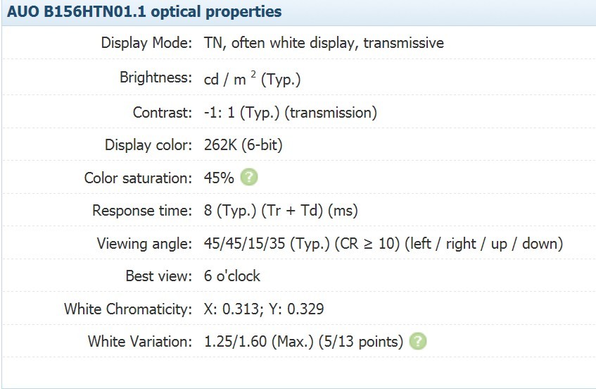

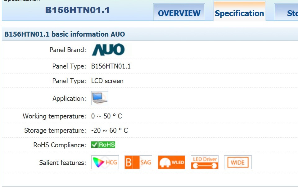

    Auo b156htn01.1
    My actual test Conclusion can not be used on clevo machines Huaping screen flicker Wait decoder
  9. luoxia
    Auo b156htn01.1
    Is there any way to solve P570WM3 2.1 supports 780M?

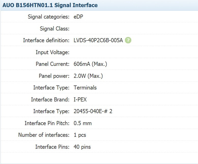

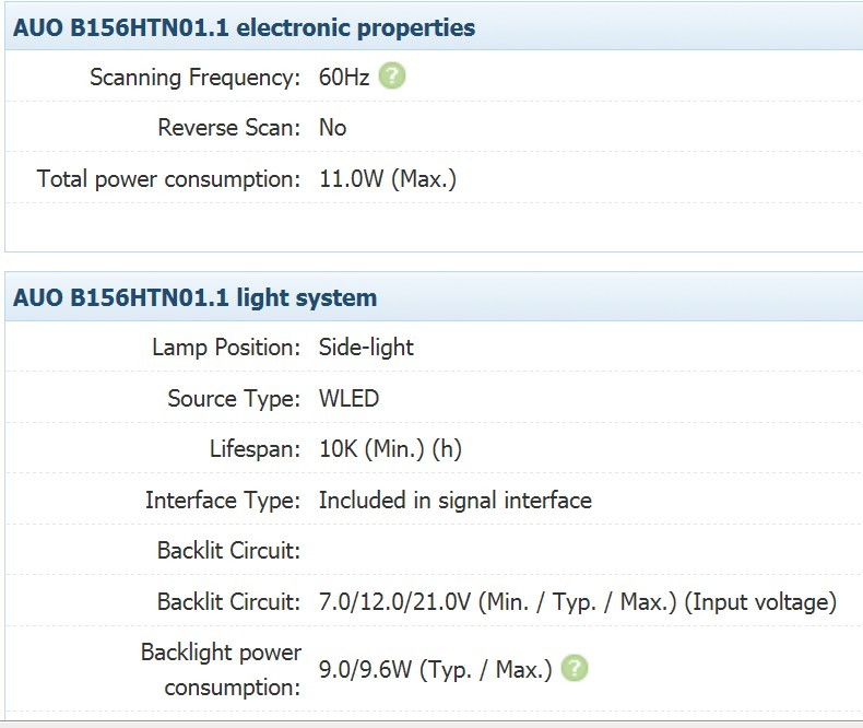

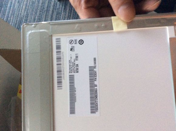

  10. luoxia

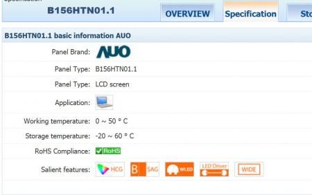

    Auo b156htn01.1

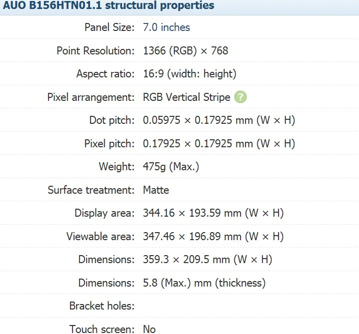

    AUO B156WH01 V4 new alternatives out B156HTN01.1 Finish: Matte Color saturation: 95% New arrival 15.6 screens Perfect A +
  11. luoxia

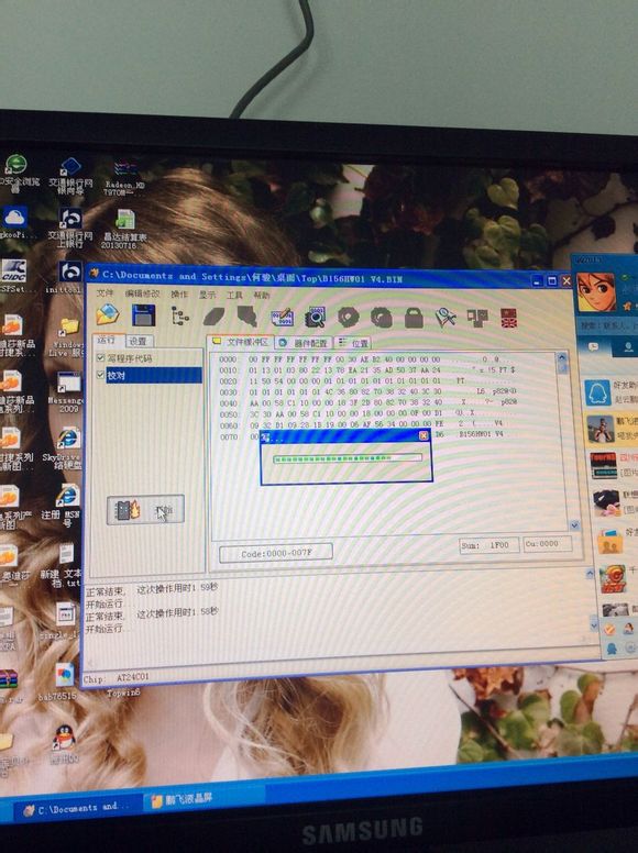

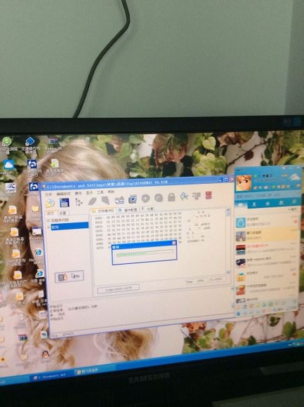

    Auo b156htn01.1

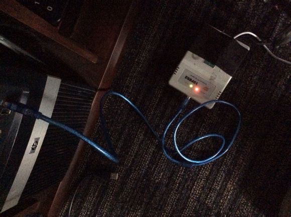

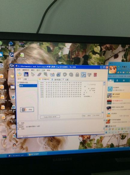

    AUO B156HTN01.1 ?B156HTN01.1.pdf???????????-?????????-?? 30 loaded B156HTN01.1 brush firmware B156WH01 V4 Improved compatibility Clevo screen flicker issue has been resolved

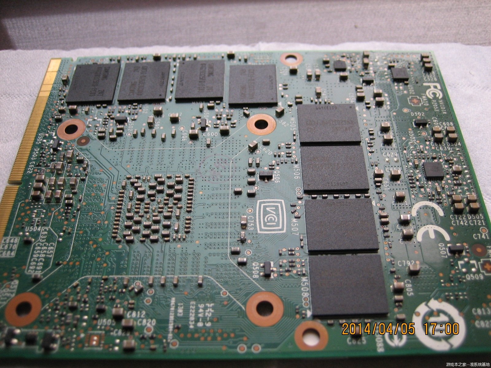

  12. Brush into vbios size 88KB of clevo msi 680M vbios common. As long as vbios size is 88KB can successfully lit P170HM

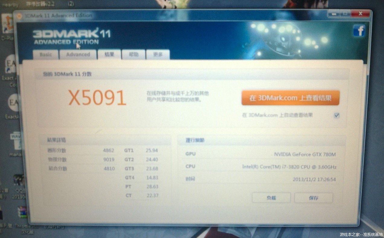

    P570wm3 780m sli
    P570WM3 780M SLI I7 3820 +32 Ghynix black stripe +64 G Samsung 830:Banane32:

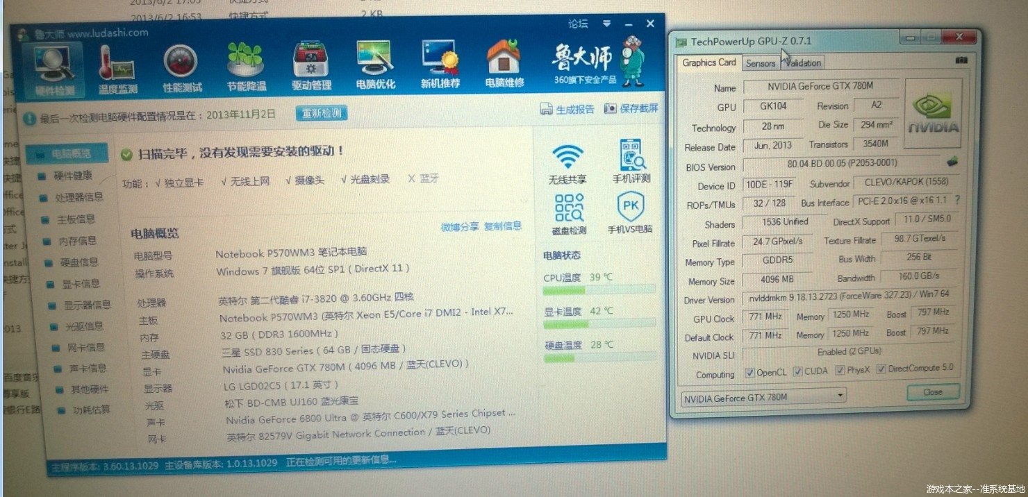

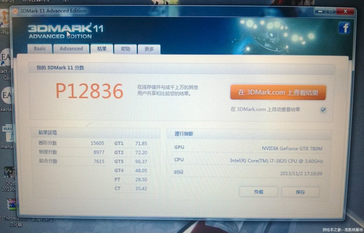

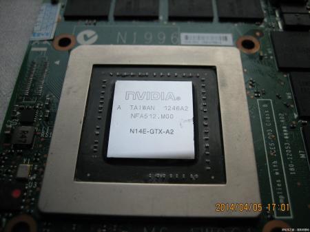

    Good ...... - - - Updated - - - Tomorrow machines on hand, By the time I'll VBIOS backup, Including the motherboard BIOS 测试平台如下: 笔记本电脑型号:Terrans Force X811(Clevo P177SM) 屏幕:17.3“ FHD(1920*1080) CPU:I7-4700MQ 显卡:GTX 780M 内存:4G 鲁大师硬件配置截图如下: <ignore_js_op> 2013-5-22 21:36 上传 下载附件 (122.67 KB) </ignore_js_op> 来个待机温度……看看待机温度还行…… <ignore_js_op> 2013-5-22 21:41 上传 下载附件 (1.72 KB) </ignore_js_op> <ignore_js_op> 2013-5-22 21:36 上传 下载附件 (114.27 KB) </ignore_js_op> 老熟人了,兄弟俩:CPU-Z和GPU-Z <ignore_js_op> 2013-5-22 21:36 上传 下载附件 (127.13 KB) </ignore_js_op> 注:Intel还没发布Haswell平台CPU呢,所以……,所以……,……一切的CPU都只有ES的了…… 就有关“驱动之家”新闻贴描述GTX 780M显卡: “它基于桌面的GK104核心衍生而来,开发代号N14-GTX-A2,1536个流处理器,其实和此前已有的GeForce GTX 680MX就是同样的东西,只不过后者是专门面向苹果Mac平台的。 当然也不是完全的“复刻”,GTX 780M的核心频率有所提高(771MHz VS. 720MHz),并且支持动态加速技术,最高可达797MHz,显存频率不变但是容量翻番到4GB。 据说其核心频率还能进一步超至950-1000MHz,性能额外增加15%,此时甚至能够打败GTX 770M SLI。” 好吧,看过硬件配置后,来,我们上主菜…… <ignore_js_op> 2013-5-22 21:41 上传 下载附件 (1.71 KB) </ignore_js_op> 鉴于3D Mark 06版本过低,已经不适合时代的要求,所以不再测试…… 【DX10理论性能测试:3DMark Vantage】 作为业界第一套基于DX10 的综合性基准测试工具,3DMark Vantage在发布前就早早地让众人翘首期盼了,因为它标志着DX10在游戏领域的宏大演出正式拉开帷幕。3DMark Vantage是一款显卡DX10性能基准测试工具,它能全面发挥多核心处理器、多路显卡的优势,能在当前和未来一段时间内满足PC系统游戏性能测试的需求。3DMark Vantage是专门为DX10显卡量身打造的。它包括两个图形测试项目、两个处理器测试项目、六个特性测试项目。借助于DX10 API的新技术和高效能,它为玩家带来了一场绚丽逼真的视觉特效盛宴。并且,3DMark Vantage还特别加入了对人工智能(AI)和物理加速的专门测试。 <ignore_js_op> 2013-5-22 21:36 上传 下载附件 (113.6 KB) </ignore_js_op> 注:这个分数有点偏低,我跑不出所谓的参考标准值……没找出原由,甚为可惜…… 【DX11理论性能测试:3DMark 11】 3DMark 11最大的卖点就是使用原生DirectX 11引擎,在测试场景中应用了包括Tessellation曲面细分、Compute Shader以及多线程在内的大量DX11新特性。3Dmark 11包含了深海(Deep Sea)和神庙(High Temple)两大测试场景,画面效果堪比CG电影,3DMark 11包含四个图形测试项目,一项物理测试和一组综合性测试,并重新提供了Demo演示模式。 <ignore_js_op> 2013-5-22 21:36 上传 下载附件 (113.96 KB) </ignore_js_op> 哈哈哈,有再次发现测试的显卡无法正确显示,原本测试GTX 780M显卡,却显示为HD 4600,不过没关系,这个是3D Mark 11版本过低的问题,升级到1.05版本就显示正确了,如下图所示: <ignore_js_op> 2013-5-22 21:36 上传 下载附件 (78.04 KB) </ignore_js_op> 【Futuremark的统一:3DMark】 Futuremark宣称:“全世界最受欢迎的基准测试软体与电脑性能测试” <ignore_js_op> 2013-5-22 21:56 上传 下载附件 (154.61 KB) </ignore_js_op> 游戏模拟类测试:Heaven Benchmark 2.5】 Heaven benchmark是俄罗斯Unigine游戏公司开发设计的一款专门测试DX11效率的软件,其支持DirectX 9、DirectX 10、DirectX 11与OpenGL 3.2 API,通过23个场景的测试最终得出显卡的实际效能。这个软件是有一个类似于阿凡达似的悬浮岛场景,其中的龙雕塑运用了细分曲面技术,还有岛上的路径和房子的砖块,通过DX11带来了很大的真实感。 <ignore_js_op> 2013-5-22 21:36 上传 下载附件 (228.91 KB) </ignore_js_op> 当然,时代在变迁,Heaven Benchmark也升级到了4.0版本~ <ignore_js_op> 2013-5-22 21:36 上传 下载附件 (149.33 KB) </ignore_js_op> Heaven 4.0 版本,相较于上代版本除了增设 Benchmark Presets 选项,标准的设定提供统一的分数基准。除此之外,新版本采用了改良版的绘图引擎,同时亦进一步强化镜头耀斑及镜深等效果,在晚上的场境亦加入了星光,同时亦加入了 GPU 温度与频率监察功能,大幅提升了 Benchmark 的可用性。 <ignore_js_op> 2013-5-22 21:36 上传 下载附件 (116.68 KB) </ignore_js_op> 果然,对比2.5版本,分数果然有差异~ 【游戏模拟类测试:最终幻想】 1.《最终幻想14》PC版硬件测.FFXIVBenchmark是史可威尔艾尼克斯公司公布的一个FF14官方测试程序,用实际的地图和角色来测试玩家电脑的性能和速度并给出一个得分。 由于1920*1080的测试结果截图比较大,所以这里提供1280*720的测试结果截图给于参考: <ignore_js_op> 2013-5-22 21:36 上传 下载附件 (187.56 KB) </ignore_js_op> 2.《最终幻想14 重生之境》由SE次时代引擎“夜光引擎”所打造,并公布了最新的PC跑分程序: 1280*720和1920*1080两个分辨率测试跑分的配置选项: <ignore_js_op> 2013-5-22 21:36 上传 下载附件 (184.01 KB) </ignore_js_op> 1280*720和1920*1080两个分辨率的测试成绩: <ignore_js_op> 2013-5-22 21:36 上传 下载附件 (182.78 KB) </ignore_js_op> 受限部分原因,有关GTX 780M显卡的测试,告一段落…… 不过,依旧在管中窥豹中能看出GTX 780M显卡,不愧为2013年的卡王,性能是杠杠的…… 当然,在GTX 780M正式发布后,搭配正式CPU,依旧会再做一次测试,毕竟,还有很多不了解的地方需要进一步核实,我很期待,你呢? - - - Updated - - - 测试平台如下: 笔记本电脑型号:Terrans Force P375SM 屏幕:17.3“ FHD(1920*1080) CPU:I7-4700MQ 显卡:GTX 780M SLI(两块GTX 780M显卡) 内存:16G (1600MHz) 鲁大师硬件配置截图如下: <ignore_js_op> 2013-5-22 21:46 上传 下载附件 (114.96 KB) </ignore_js_op> Haswell I7-4700MQ CPU硬件信息: <ignore_js_op> 2013-5-22 21:46 上传 下载附件 (73.27 KB) </ignore_js_op> 注:测试样机搭配的当然是工程版的CPU 前两天看到GPU-Z有新版本0.7.1发布,赶紧下载。果然对比0.7.0版本,GTX 780M显卡有了更多信息: <ignore_js_op> 2013-5-22 21:46 上传 下载附件 (141.49 KB) </ignore_js_op> 以下我们使用专业测试软件,用测试数据来解析Terrans Force P375SM笔记本电脑性能~ <ignore_js_op> 2013-5-22 21:50 上传 下载附件 (1.6 KB) </ignore_js_op> 【渲染性能测试:Cinebench R11.5】 Cinebench使用的是针对电影电视行业开发的Cinema 4D特效软件引擎,在CPU测试场景中,将会纯粹使用CPU渲染一张高精度的3D场景画面,依次检测CPU的渲染能力,反映出CPU在工作站设计软件上的性能表现。 <ignore_js_op> 2013-5-22 21:46 上传 下载附件 (72.48 KB) </ignore_js_op> 【DX10理论性能测试:3DMark Vantage】 3DMark Vantage是一款显卡DX10性能基准测试工具,它能全面发挥多核心处理器、多路显卡的优势,它是专门为DX10显卡量身打造的。它包括两个图形测试项目、两个处理器测试项目、六个特性测试项目。借助于DX10 API的新技术和高效能,它为玩家带来了一场绚丽逼真的视觉特效盛宴。并且,3DMark Vantage还特别加入了对人工智能(AI)和物理加速的专门测试。 <ignore_js_op> 2013-5-22 21:46 上传 下载附件 (116.48 KB) </ignore_js_op> 注:感到欣慰的是,GTX 780M双显卡的测试下来性能还不错,比Terrans Force X811测试的GTX 780M单卡好多了~ 【DX11理论性能测试:3DMark 11】 3DMark 11基于原生DX11引擎,全面使用DX11 API的所有新特性,包括曲面细分、计算着色器、多线程。3DMark 11继承并改良了3DMark Vantage的统计方式,使得测试更加简便、合理。 这里3D Mark 11升级到了1.0.05版本,再也不用尴尬地解释显卡型号错误的问题啦…… <ignore_js_op> 2013-5-22 21:46 上传 下载附件 (119.47 KB) </ignore_js_op> 【Futuremark的统一:3DMark】 Futuremark公司的新产品,有“返璞归真”之说,并宣称:“全世界最受欢迎的基准测试软体与电脑性能测试”。 <ignore_js_op> 2013-5-22 21:58 上传 下载附件 (36.68 KB) </ignore_js_op> Cloud Gate和Ice Storm两个测试主要是针对低配置的笔记本电脑,所以在以上截图可以看到,测试结果分数高得有点吓人啦…… 【游戏模拟测试:Heaven Benchmark 4.0和Valley Bennchmark 1.0】 Heaven 是最早推出的 DirectX 11 Benchmark 测试工具之一,同时亦是 Hwbot 世界超频排行榜的其中一个 3D 项目, Unigine 于 12 日推出全新 4.0 版本,测试场境是一个奇幻 的蒸气小村落世界,画面会出现大量闪亮的黄铜、木材和齿轮素材,大量使用 Tessellation 的鹅卵石街道,在精心制作的飞船场境以及雄伟的中央广场中穿梭,利用各类最先进的绘图 API 技术,考验绘图卡的性能表现。 <ignore_js_op> 2013-5-22 21:46 上传 下载附件 (128.51 KB) </ignore_js_op> Valley 是 Unigine 全新的 Benchmark 工具,在一个高达 640,000,000m2无缝地形的森林山谷中,周围的茫茫树海中的每片叶子和花瓣均表现得十分细致,充份利用了 Unigine 引擎对大型互动场境的应用,测试采用鸟瞰方式穿越这个天堂般的山谷,同时亦考验着 3D 绘图卡的性能。 <ignore_js_op> 2013-5-22 21:46 上传 下载附件 (104.19 KB) </ignore_js_op> 【“最终幻想14”测试软件:FFXIVBenchmark和FFXIV-ARR-Bench-World】 FFXIVBenchmark和FFXIV-ARR-Bench-World也是两款测试显卡性能非常不错的软件,不过可惜的是,好像并不支持两款两块显卡的并行运行测试……,经过测试对比,测试分值差异不大,甚为可惜,不过这里也把测试的分值提供给大家参考: <ignore_js_op> 2013-5-22 21:52 上传 下载附件 (226.59 KB) </ignore_js_op> 【显卡压力测试工具:GpuTest 】 GpuTest是一款十分小巧的基于OpenGL的显卡压力测试软件。 测试包括FurMark(基于OpenGL 3.2)、TessMark(基于OpenGL 4.0)、GiMark(基于OpenGL 3.3)和PixMark(基于OpenGL 3.2)。 不过,依旧很遗憾,经过后期测试数据的对比,发现也是不支持双卡并行测试,也很可惜,这也是么有想到的……但依旧提供测试数据给大家参考: GpuTest设置界面,这里测试统一使用1280*720分辨率: <ignore_js_op> 2013-5-22 21:46 上传 下载附件 (33.78 KB) </ignore_js_op> GpuTest总共提供了8个测试项目,希望这些测试数值能对看官有所参考:) <ignore_js_op> 2013-5-22 21:46 上传 下载附件 (177.64 KB) </ignore_js_op> <ignore_js_op> 2013-5-22 21:46 上传 下载附件 (186.87 KB) </ignore_js_op> 哈哈,针对Terrans Force P375SM笔记本电脑双GTX 780M显卡,做了非常详细的测试,大家对此笔电性能应该有了全面的了解了吧~ 看官的好奇心是否满足了呢?GTX 780M单卡性能原本就非常强悍了,双卡则更可怕…… 外观靓丽的P375SM笔记本电脑,再次证明其实力所向披靡,着实为2013年的旗舰机奠定了结识的基础 当然,本次测试仅是个开始……因为首先样机的缘故,还有很多不解的地方需要探索,而未来在硬件和软件得不断完善下,相信未来的Terrans Force P375SM笔记本电脑会更强、更完美…… - - - Updated - - - 测试平台如下: 笔记本电脑型号:Terrans Force P375SM 屏幕:17.3“ FHD(1920*1080) CPU:I7-4700MQ 显卡:GTX 780M SLI(两块GTX 780M显卡) 内存:16G (1600MHz) 鲁大师硬件配置截图如下: <ignore_js_op> 2013-5-22 21:46 上传 下载附件 (114.96 KB) </ignore_js_op> Haswell I7-4700MQ CPU硬件信息: <ignore_js_op> 2013-5-22 21:46 上传 下载附件 (73.27 KB) </ignore_js_op> 注:测试样机搭配的当然是工程版的CPU 前两天看到GPU-Z有新版本0.7.1发布,赶紧下载。果然对比0.7.0版本,GTX 780M显卡有了更多信息: <ignore_js_op> 2013-5-22 21:46 上传 下载附件 (141.49 KB) </ignore_js_op> 以下我们使用专业测试软件,用测试数据来解析Terrans Force P375SM笔记本电脑性能~ <ignore_js_op> 2013-5-22 21:50 上传 下载附件 (1.6 KB) </ignore_js_op> 【渲染性能测试:Cinebench R11.5】 Cinebench使用的是针对电影电视行业开发的Cinema 4D特效软件引擎,在CPU测试场景中,将会纯粹使用CPU渲染一张高精度的3D场景画面,依次检测CPU的渲染能力,反映出CPU在工作站设计软件上的性能表现。 <ignore_js_op> 2013-5-22 21:46 上传 下载附件 (72.48 KB) </ignore_js_op> 【DX10理论性能测试:3DMark Vantage】 3DMark Vantage是一款显卡DX10性能基准测试工具,它能全面发挥多核心处理器、多路显卡的优势,它是专门为DX10显卡量身打造的。它包括两个图形测试项目、两个处理器测试项目、六个特性测试项目。借助于DX10 API的新技术和高效能,它为玩家带来了一场绚丽逼真的视觉特效盛宴。并且,3DMark Vantage还特别加入了对人工智能(AI)和物理加速的专门测试。 <ignore_js_op> 2013-5-22 21:46 上传 下载附件 (116.48 KB) </ignore_js_op> 注:感到欣慰的是,GTX 780M双显卡的测试下来性能还不错,比Terrans Force X811测试的GTX 780M单卡好多了~ 【DX11理论性能测试:3DMark 11】 3DMark 11基于原生DX11引擎,全面使用DX11 API的所有新特性,包括曲面细分、计算着色器、多线程。3DMark 11继承并改良了3DMark Vantage的统计方式,使得测试更加简便、合理。 这里3D Mark 11升级到了1.0.05版本,再也不用尴尬地解释显卡型号错误的问题啦…… <ignore_js_op> 2013-5-22 21:46 上传 下载附件 (119.47 KB) </ignore_js_op> 【Futuremark的统一:3DMark】 Futuremark公司的新产品,有“返璞归真”之说,并宣称:“全世界最受欢迎的基准测试软体与电脑性能测试”。 <ignore_js_op> 2013-5-22 21:58 上传 下载附件 (36.68 KB) </ignore_js_op> Cloud Gate和Ice Storm两个测试主要是针对低配置的笔记本电脑,所以在以上截图可以看到,测试结果分数高得有点吓人啦…… 【游戏模拟测试:Heaven Benchmark 4.0和Valley Bennchmark 1.0】 Heaven 是最早推出的 DirectX 11 Benchmark 测试工具之一,同时亦是 Hwbot 世界超频排行榜的其中一个 3D 项目, Unigine 于 12 日推出全新 4.0 版本,测试场境是一个奇幻 的蒸气小村落世界,画面会出现大量闪亮的黄铜、木材和齿轮素材,大量使用 Tessellation 的鹅卵石街道,在精心制作的飞船场境以及雄伟的中央广场中穿梭,利用各类最先进的绘图 API 技术,考验绘图卡的性能表现。 <ignore_js_op> 2013-5-22 21:46 上传 下载附件 (128.51 KB) </ignore_js_op> Valley 是 Unigine 全新的 Benchmark 工具,在一个高达 640,000,000m2无缝地形的森林山谷中,周围的茫茫树海中的每片叶子和花瓣均表现得十分细致,充份利用了 Unigine 引擎对大型互动场境的应用,测试采用鸟瞰方式穿越这个天堂般的山谷,同时亦考验着 3D 绘图卡的性能。 <ignore_js_op> 2013-5-22 21:46 上传 下载附件 (104.19 KB) </ignore_js_op> 【“最终幻想14”测试软件:FFXIVBenchmark和FFXIV-ARR-Bench-World】 FFXIVBenchmark和FFXIV-ARR-Bench-World也是两款测试显卡性能非常不错的软件,不过可惜的是,好像并不支持两款两块显卡的并行运行测试……,经过测试对比,测试分值差异不大,甚为可惜,不过这里也把测试的分值提供给大家参考: <ignore_js_op> 2013-5-22 21:52 上传 下载附件 (226.59 KB) </ignore_js_op> 【显卡压力测试工具:GpuTest 】 GpuTest是一款十分小巧的基于OpenGL的显卡压力测试软件。 测试包括FurMark(基于OpenGL 3.2)、TessMark(基于OpenGL 4.0)、GiMark(基于OpenGL 3.3)和PixMark(基于OpenGL 3.2)。 不过,依旧很遗憾,经过后期测试数据的对比,发现也是不支持双卡并行测试,也很可惜,这也是么有想到的……但依旧提供测试数据给大家参考: GpuTest设置界面,这里测试统一使用1280*720分辨率: <ignore_js_op> 2013-5-22 21:46 上传 下载附件 (33.78 KB) </ignore_js_op> GpuTest总共提供了8个测试项目,希望这些测试数值能对看官有所参考:) <ignore_js_op> 2013-5-22 21:46 上传 下载附件 (177.64 KB) </ignore_js_op> <ignore_js_op> 2013-5-22 21:46 上传 下载附件 (186.87 KB) </ignore_js_op> 哈哈,针对Terrans Force P375SM笔记本电脑双GTX 780M显卡,做了非常详细的测试,大家对此笔电性能应该有了全面的了解了吧~ 看官的好奇心是否满足了呢?GTX 780M单卡性能原本就非常强悍了,双卡则更可怕…… 外观靓丽的P375SM笔记本电脑,再次证明其实力所向披靡,着实为2013年的旗舰机奠定了结识的基础 当然,本次测试仅是个开始……因为首先样机的缘故,还有很多不解的地方需要探索,而未来在硬件和软件得不断完善下,相信未来的Terrans Force P375SM笔记本电脑会更强、更完美……
