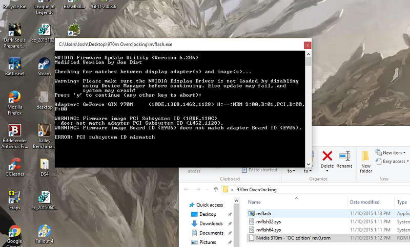

Tried flashing and I keep getting this error. Anybody know why?
You are using the wrong NVFLASH. Just use the one modded for Notebooks from the OP.
