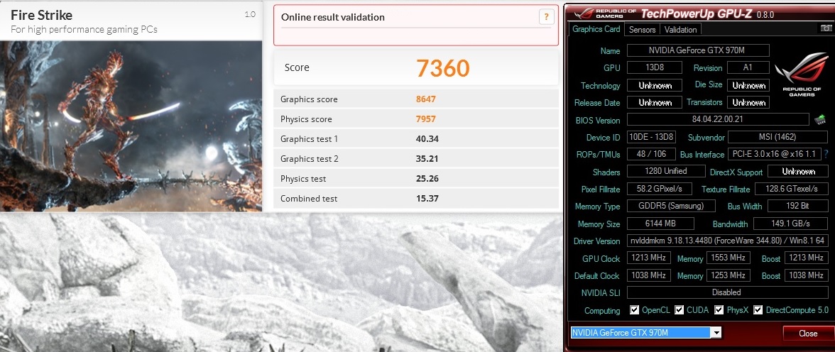

So far this is the stable bench in 3dmark firestrike
core clock = 175
mem clock = 600

it seems that I've hit the limit for my 970m
175 = Core clock
600 = Mem clock
I wont touch the Power limit yet (default settings) unless you guys know the safe limits to move the slider for this one.
