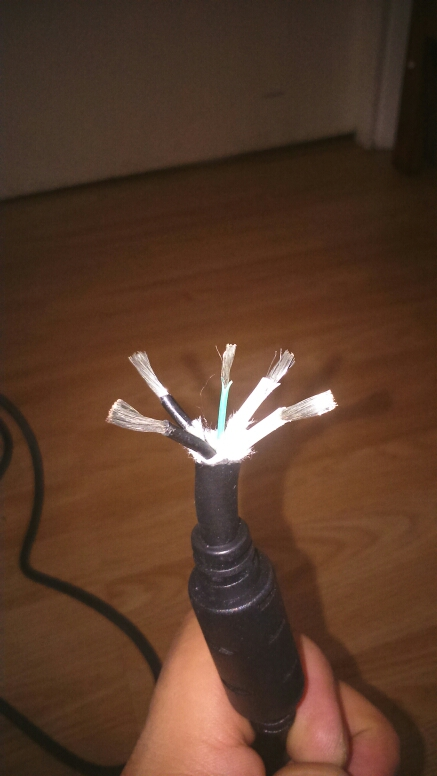

stormyandcold Posted July 14, 2015 Share Posted July 14, 2015 This is how far I've got, waiting for connector cable to come before I solder.Bixpower 6 ft DC Power Cable 16AWG with 5 5 x 2 5mm Male to Female Connectors | eBay Saves my original power-supply. Do I solder both black cables together or is one of them earth? In which case the green cable can be soldered to it? Thanks for your help. Quote Link to comment Share on other sites More sharing options...
haiwepa Posted July 14, 2015 Share Posted July 14, 2015 If it's a Dell 330w PSU, you need to solder/put together the two white wires on one side , and both the two black and the green wires on the other side. Quote Link to comment Share on other sites More sharing options...
stormyandcold Posted July 14, 2015 Share Posted July 14, 2015 Awesome, cheers bro! This mod seems much easier now that I know it works like that.(also confirmed by Khenglish cheers!). Quote Link to comment Share on other sites More sharing options...
