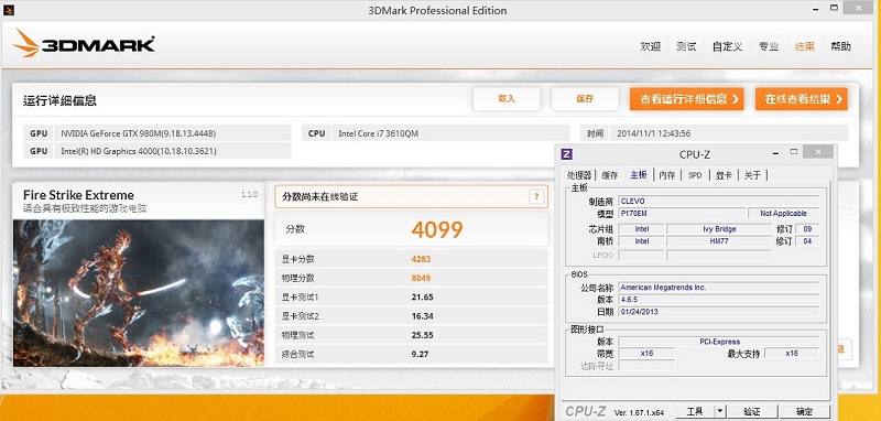

zhubonan 12 Posted November 21, 2014 As far as I know 680m is currently (sadly) the most powerful GPU for 170EM or EM series. However after some search recently I found that there maybe a chance to have 980m on-board skiping 7 and 8 series. Some Chinese clevo resellers tested EM and 980M and found surprising results. I think this may be interested for someone(including me a owner of 680m P170EM) Here is the original link 实测è“天GTX 980M 完美兼容,è“天 EM机器_准系统å§_ç™¾åº¦è´´å§ Please note this is not fully confirmed yet! 2 Quote Share this post Link to post Share on other sites
godfafa 137 Posted November 21, 2014 As far as I know 680m is currently (sadly) the most powerful GPU for 170EM or EM series. However after some search recently I found that there maybe a chance to have 980m on-board skiping 7 and 8 series. Some Chinese clevo resellers tested EM and 980M and found surprising results. I think this may be interested for someone(including me a owner of 680m P170EM)[ATTACH=CONFIG]13194[/ATTACH] Here is the original link 实测è“天GTX 980M 完美兼容,è“天 EM机器_准系统å§_ç™¾åº¦è´´å§ Please note this is not fully confirmed yet! Search Core i7-3740QM Processor&gpuName=NVIDIA GeForce GTX 980M I dont know what these results mean. But some ivy system is able to run 980m. And I think these are results of pxx0em (150 170 370). - - - Updated - - - Hope someone can test and if you do in any case, please let me know. Quote Share this post Link to post Share on other sites

Guest Posted November 21, 2014 Here!Generic VGA video card benchmark result - Intel Core i7-3740QM Processor,CLEVO P15xEMx SHIT, forgot to delete that...I wanted to finish the work on the mod first... Ah well, since it's out there anyway, here you go with an official bench: NVIDIA GeForce GTX 980M video card benchmark result - Intel Core i7-3740QM Processor,CLEVO P150EM I am still sitting on 3 broken systems and work has stalled so please don't ask for any Mod ETAs... Edit: You will no longer need any driver .inf Mods with the next batch of Prema Mods for your GTX980M & GTX970M on any Clevo. Quote Share this post Link to post Share on other sites

xnz1201 10 Posted December 2, 2014 There's some Chinese users succeed to install 980 on em. It didn't go well on my 370em, GPU-Z can recognize the card as 980M. But not work well with any version of 3Dmark. And all games locked at 30fps,as well as 3DMark. I edited driver's inf, it didn't go well anyway Quote Share this post Link to post Share on other sites

NightFX 19 Posted January 22, 2015 Hi everyone,just to let you know that I have installed the GTX980M into my P170EM, and it is working fine, in fact it works GREAT…NVIDIA GeForce GTX 980M video card benchmark result - Intel Core i7-3720QM Processor,CLEVO P170EMIts more dumb luck than skill that I got it working, I tried many NVidia drivers and INF files before I got it to work. I’m using;Win 7 – 64bitPrema’s modified Bios for the P170EM: P170EM_17_12_PM_v2 BIOS (note that the Bios shows VGA slot as EMPTY.)https://biosmods.wordpress.com/p170em/ Stock NVidia driver version 347.12 (stock INF) its a NVidia Developer Centre driver forGeForce, Quadro, Tesla. Its on NVidia site or, v347.12 Windows 8 64bit | NVIDIA Desktop/Mobile OEM - GeForce r346 series - LaptopVideo2Go Forumshope this info helps, cheers NightFX 2 Quote Share this post Link to post Share on other sites
