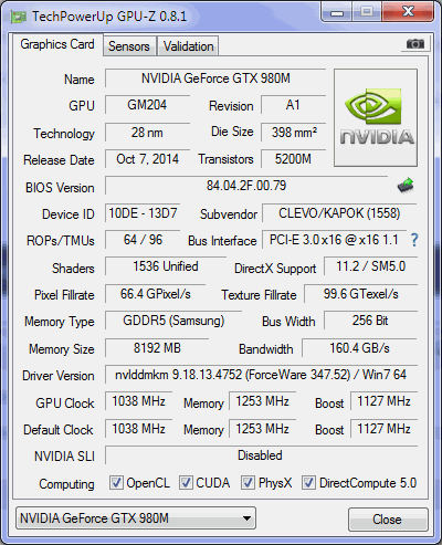

  1. Thanks for the reply Prema, Those Fire Strike scores that I quoted were the total scores, not just the GPU score, which on best run was GPU 9550 using stock vBios and 347.52, and as mentioned above, all other combinations resulted in a worse score. The only thing I haven't tried is your Bios V3, I am using your Mod 1.02.17PM v2 Bios My Fire Strike GPU score was 7285 using 345.20 Mod Bios V2 and Mod vBios V1. cheers...
  2. I'm not sure if my experience is the same as everyone else, but I have tried the modified vBios on 3 separate occasions (and then re-flashed the stock vBios back)and have tried it with; 344.91 345.20, 345.20 Mr Fox 346.87 347.12 347.52 and none of these drivers and the Modified vBios has been as good as the stock vBios and 347.52 (or 347.71). Any driver I have tried with the Modified vBios has resulted in a Fire Strike score of between 5800 and 7850, mostly the lower end. Using Stock vBios and 347.52 I consistently get between 7950 and 8100. If someone can recommended non347 driver to use with the modified vBios I would love to hear which one. cheers NightFX

  9. Brought mine from UpgradeMonkey (eBay), works fine and at 100% using standard clocks and driver 347.52 upgrademonkey1 | eBay Each to their own.. cheers
  10. Yes I agree with you Toopy. I got the GTX980M working at full speed on my P170EM using the 347.12 driver and got great benchmark scores on 3DMark. At this stage I'm happy that I haven't wasted my money, I will look at OC later when the BIOS is sorted out. Cheers

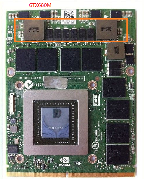

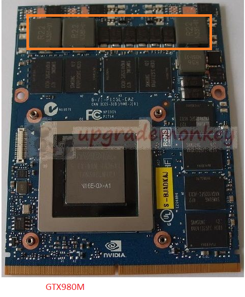

  14. Unless you buy 980M upgrade kit that has all the extra bits (heat sink, thermal pads and thermal paste), you will need some extra thermal pads (and paste); GTX980M. If you compare the highlighted area, you can see that the top section of components on the 980M is wider than the 680M. While the heatsink will cover this whole section, the existing thermal pads wont, extra pads will be needed. GTX980M installed in my P170EM using existing 680M brackets, screws and heatsink. Additional thermal pads needed and new thermal paste. I replaced all the old thermal pads with 11.0watt/mk rating Fujipoly/ModRight pads and Arctic Silver 5 Thermal Compound, and so far no heat issues. It would certainly be easier to get everything as a kit if the price is right. hope this helps. Cheers.
  15. Good luck with your new 980M. Depending on where you ordered your new 980M, you will also need to by a sheet of thermal pads (I brought 1mm and 0.5mm) to build up the required thicknesses. Also, check that the GTX675 heat sink fits the 980M correctly. The GTX680M did (same form factor and component layout), so hopefully yours will to.
