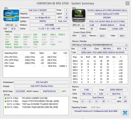

djawho Posted March 22, 2015 Share Posted March 22, 2015 I have look the subsys of my gtx 970m and she have a strange subvendor 0371.1558 . But if i look in the official driver the first code is 0376.1558 . Is it for that if it's not possible to put all drivers ?for me in fire strike i have just 6421 and the gpu 7431 only . With 347.XX 344.XX . Quote Link to comment Share on other sites More sharing options...

Guest Posted March 23, 2015 Share Posted March 23, 2015 I have look the subsys of my gtx 970m and she have a strange subvendor 0371.1558 . But if i look in the official driver the first code is 0376.1558 . Is it for that if it's not possible to put all drivers ?for me in fire strike i have just 6421 and the gpu 7431 only . With 347.XX 344.XX .You have to change the 0376 to 0371 in the driver .inf. until the Mod gets a public/stable release.Hi all, one question: it is possible to make the 980M upgrade on a Clevo P170EM that comes with a AMD 7970M installed? I already have the P170EM_17_12_PM_v2 PremaMod system bios installed (and if i buy the 980M from Eurocom, from what i have been reading here, it comes already with a vBios prepared to my laptop, if not i should flash it with CLEVO_8GB_GTX980M_OC_PM_v1 graphics card bios)Many thanks!Mythlogic and Eurocom will send you a v3b system BIOS and a compatible vBIOS. Alternatively you can use that Prema Mod vBIOS. Quote Link to comment Share on other sites More sharing options...
