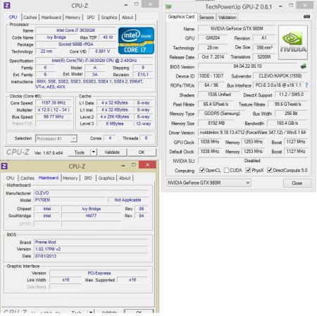

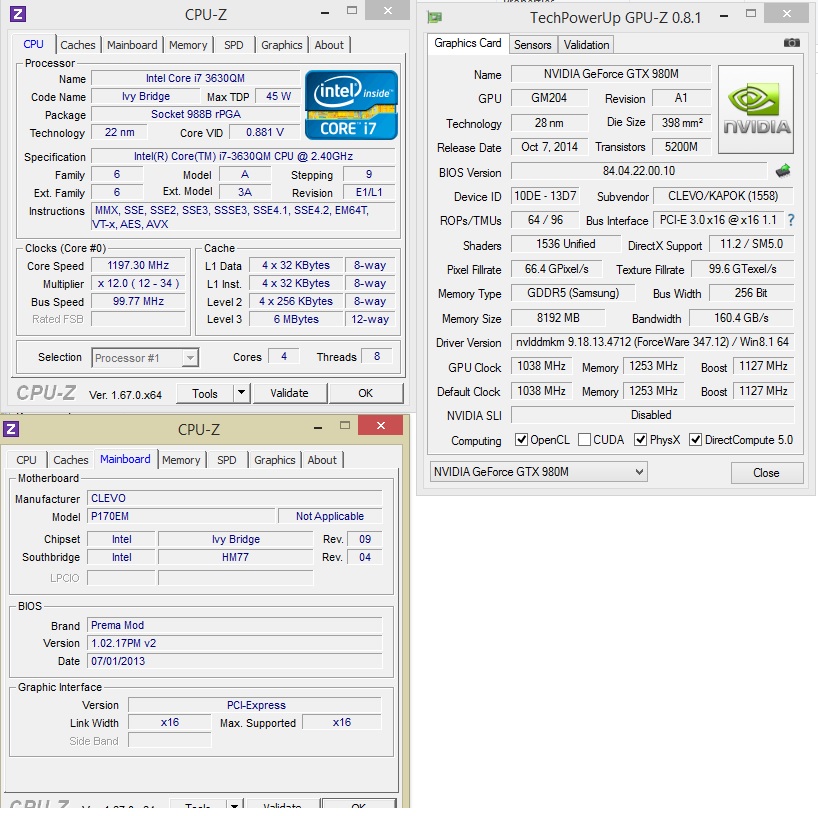

Recieved and installed my 980m from rjtech this afternoon and can confirm its a straight plug and play with the drivers listed in this thread here
http://forum.techinferno.com/clevo/8361-980m-seems-compatible-em-series-2.html#post119999
had to use these as drivers from the Nvidia site wouldn't install
pic
got 8000 in fire strike first run without running ixtu to boost turbo mode and with stock bios

You can try this driver from www.laptopvideo2go.com, I found it worked "as is - stock".
v347.12 Windows 8 64bit | NVIDIA Desktop/Mobile OEM - GeForce r346 series - LaptopVideo2Go Forums
other Drivers will need a modified INF file.
cheers
just be aware that with 347.xx drivers u cannot overclock ur gpu...
hey folks,just found this post by prema, especially after the info i just gave concerning no overclocks on the 347.xx drivers this should be important to know:
