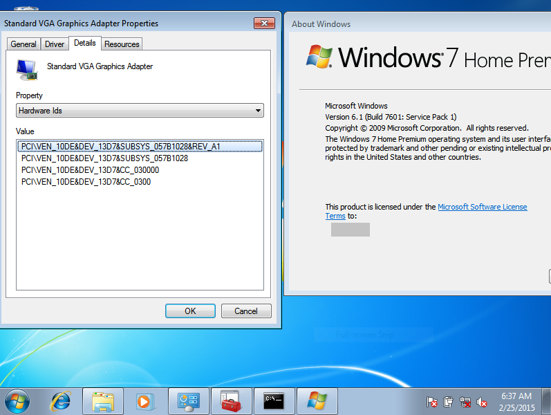

J95 Posted February 25, 2015 Share Posted February 25, 2015 ... M18xR2...? @Peter18x @TBoneSan 120Hz AWs will need a 'backup card' 680M or 780M in case something goes wrong (BIOS reset).BIOS -> IGP 'Auto' -> 'Disabled' -> PCI Express Graphic -> "Always Enable PEG" Enabled -> Peripheral Configuration -> Serial Port A Disabled -> "Azalia" Disabled -> Boot options -> "Boot List Option" LEGACY -> Exit menu "Save without exit option" -> Power Off. Plug HDMI cable/external monitor -> Monitor/ input selection e.g. when using HDMI 1 set input to HDMI 2 >No scanning whatsoever< Finally Power ON. Install win7/MBR.Win7/MBR - Legacy BIOS Mode. Win7/MBR - Legacy BIOS Mode.Win7/GPT - UEFI/Legacy option ROM 4 Quote Link to comment Share on other sites More sharing options...
TBoneSan Posted February 25, 2015 Share Posted February 25, 2015 ... M18xR2...? @Peter18x @TBoneSan BIOS -> Peripheral Configuration -> Serial Port A Disabled -> Azalia Disabled -> Boot options -> Legacy -> Save without exit option -> Power Off. Plug HDMI cable external monitor -> Power ON Install win7 spare or external drive. Flash svl7's & Johnksss' unlocked vbios http://forum.techinferno.com/general-notebook-discussions/8560-nvidia-maxwell-vbios-mods-900m-series-overclocking-versions.html[ATTACH=CONFIG]14211[/ATTACH]BIOS tweaking - Removing Throttling...15min... PCI Express Graphics -> PEG0 PEG1 PEG2 PEG3 set all to 'GEN3' -> 'Always enable PEG' enabled SA DMI configuration -> 'DMI Link ASPM Control' Disabled PCI Express -> Port2 (Graphics) ASPM Auto set to disabled Install GeForce v345.09 from HERE, match NV drivers 347.xx voltage offset +62.5mV and increase Power Target. Set startup task... Very cool, I'm assuming I'd still need to swap each 980m to primary to flash? Or does this method finally skip this requirement? Quote Link to comment Share on other sites More sharing options...
J95 Posted February 25, 2015 Share Posted February 25, 2015 Very cool, I'm assuming I'd still need to swap each 980m to primary to flash? Or does this method finally skip this requirement?Nope, this is full Legacy BIOS Mode so you don't need to swap cards (IGP disabled). Use HWinfo or AIDA64 to detect the corresponding PCI express ports. Quote Link to comment Share on other sites More sharing options...
TBoneSan Posted February 25, 2015 Share Posted February 25, 2015 Awesome! I can't wait to try. So this has effectively removed throttling then? Quote Link to comment Share on other sites More sharing options...
J95 Posted February 25, 2015 Share Posted February 25, 2015 Awesome! I can't wait to try. So this has effectively removed throttling then? Win7/MBR are basically for flashing the cards and 3DMark11/stock (sound card disabled), the other BIOS settings + NV Inspector will remove throttling for Gaming but not extreme OCing. Edit: Core throttling, at least flashing is not a problem anymore for 120Hz AWs...M18xR2? Quote Link to comment Share on other sites More sharing options...

TBoneSan Posted February 25, 2015 Share Posted February 25, 2015 Is it necessary to always use NI to mitigate throttling?Followed your instructions.. Now have a black screen 8 beep code. Any ideas? I've tried removing HDDs, CMOS flash.. Can't get things back... I'm stuck in Legacy mode and can't switch back. Now I got to tear this thing down a million times to get it back.. @#$& Quote Link to comment Share on other sites More sharing options...
Wolf Posted February 25, 2015 Share Posted February 25, 2015 Hi, am new to the forum, I alienware m17x r14, I read the whole post but I did not understand whether you need mrttere vbios mod to operate the card. Thank You Quote Link to comment Share on other sites More sharing options...
TBoneSan Posted February 25, 2015 Share Posted February 25, 2015 @J95 Ok..so I'm back up and running. Had to pull the cards out, restart, switch back to UEFI, then put the cards back in.. Had I already done the windows 7 install on the msata I would have just done it the old wayAny idea's what went wrong bud? Quote Link to comment Share on other sites More sharing options...
J95 Posted February 25, 2015 Share Posted February 25, 2015 Is it necessary to always use NI to mitigate throttling?Followed your instructions.. Now have a black screen 8 beep code. Any ideas? I've tried removing HDDs, CMOS flash.. Can't get things back... I'm stuck in Legacy mode and can't switch back. Now I got to tear this thing down a million times to get it back.. @#$&Beeps are related to a bad hdmi connection, clearing cmos means you will need to boot using igp without the 980Ms installed.Did you disable Serial Port A & Azalia...? Quote Link to comment Share on other sites More sharing options...
