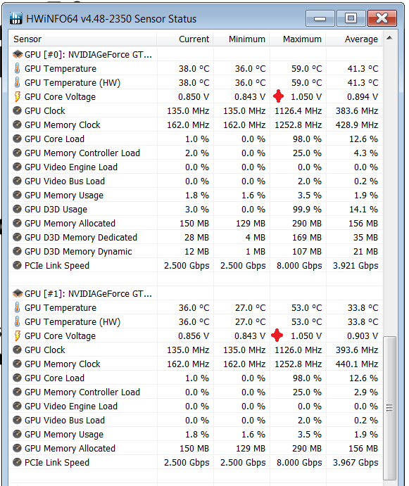

  13. I think it's due to every 980m use slightly different voltage at same clock. At slightly higher voltage 980ms performs better. Unlock voltage limit upto 1250mV could help to get stable performance at very high clocks.
  14. Cosz stock vbios already got voltage table for specific clock. Check again with HWINFO64, run some graphically demanding game while HWINFO64 runnin in background. Even at stock boost clock 1126 980m uses 1050mV.
