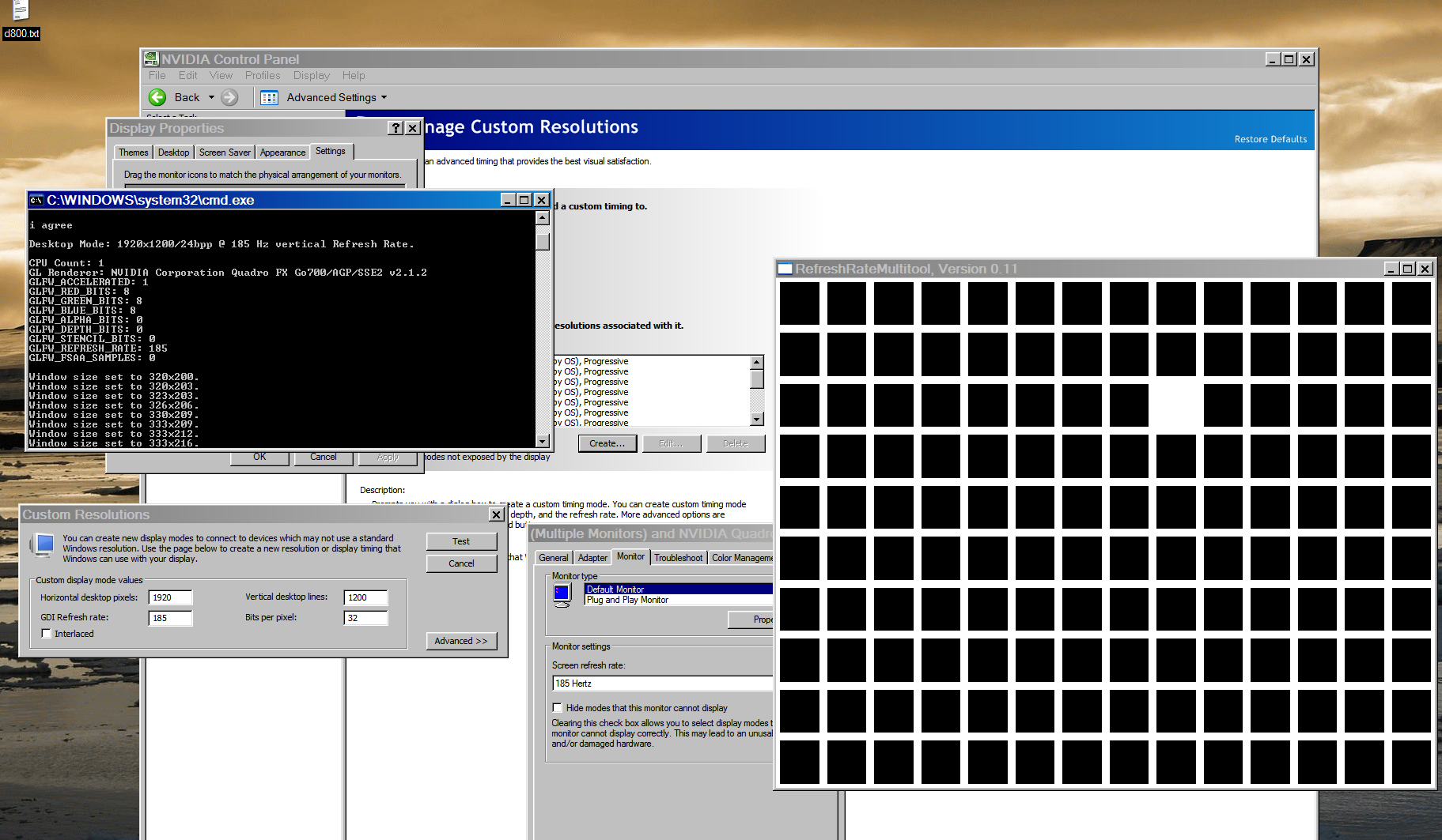

H658tu Posted August 19, 2014 Share Posted August 19, 2014 Stable 1920x1200 32-bit 185 Hz Hmm, right ... disclaimer; NOT on a y510p, obviously, 1920x1200 = WUXGA, not HD, it's got (1200-1080)/1080 * 100 = 11% more pixels than HD . Ok, so ran into this thread by chance and thought I'd test it on my Latitude D800, it's got the world's first ≥HD panel, pre-dating the advent of Blu-ray by 2 years ... It's stable all-right, but can only verify this on Refresh Rate Multitool: Not because the browser tools fail, but because the Pentium M can't cope with the browser's resource demand (cpu à la 2004). Funny though; am using a 1000Hz usb polling rate mouse (on a ~1250Hz port), which shows ... almost too fast, if it weren't for the high resolution. This 15.4" TN lcd was build april 2003, so we're talking about something that's over 11½ years old by now: LQ154M1LW02. 2 Quote Link to comment Share on other sites More sharing options...
