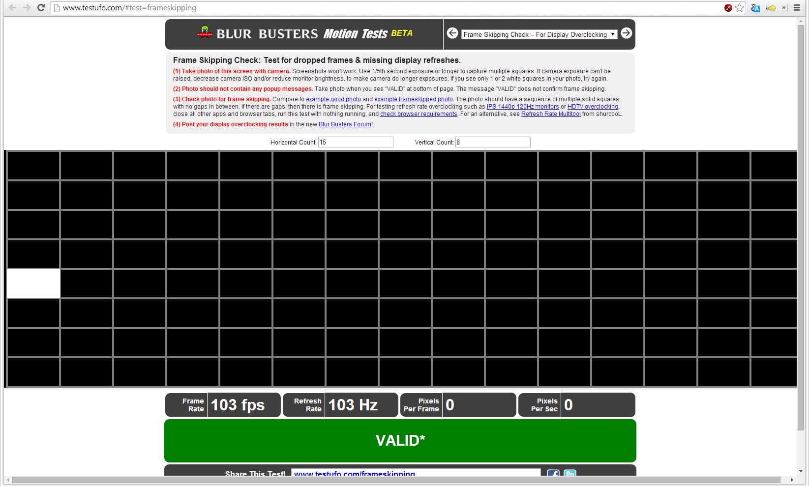

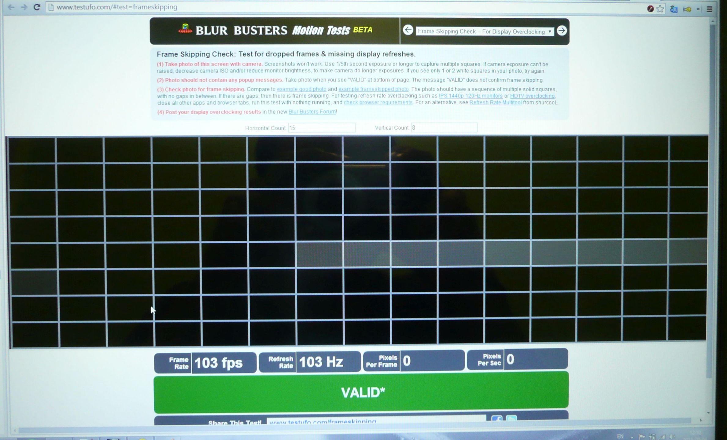

NonXtreme Posted August 5, 2014 Share Posted August 5, 2014 I also got max of 103Hz on my Y510p with glossy screen. According to HWiNFO my monitor is LP156WF1-TLC2.But at 103Hz I see a little flickering(almost none) so I now keep it at 100Hz. At 104Hz and above, display will turn black and my laptop will freeze.Edit: Now I'm back to 75Hz since I start to notice some artifact(scan lines). 1 Quote Link to comment Share on other sites More sharing options...

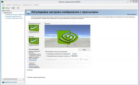

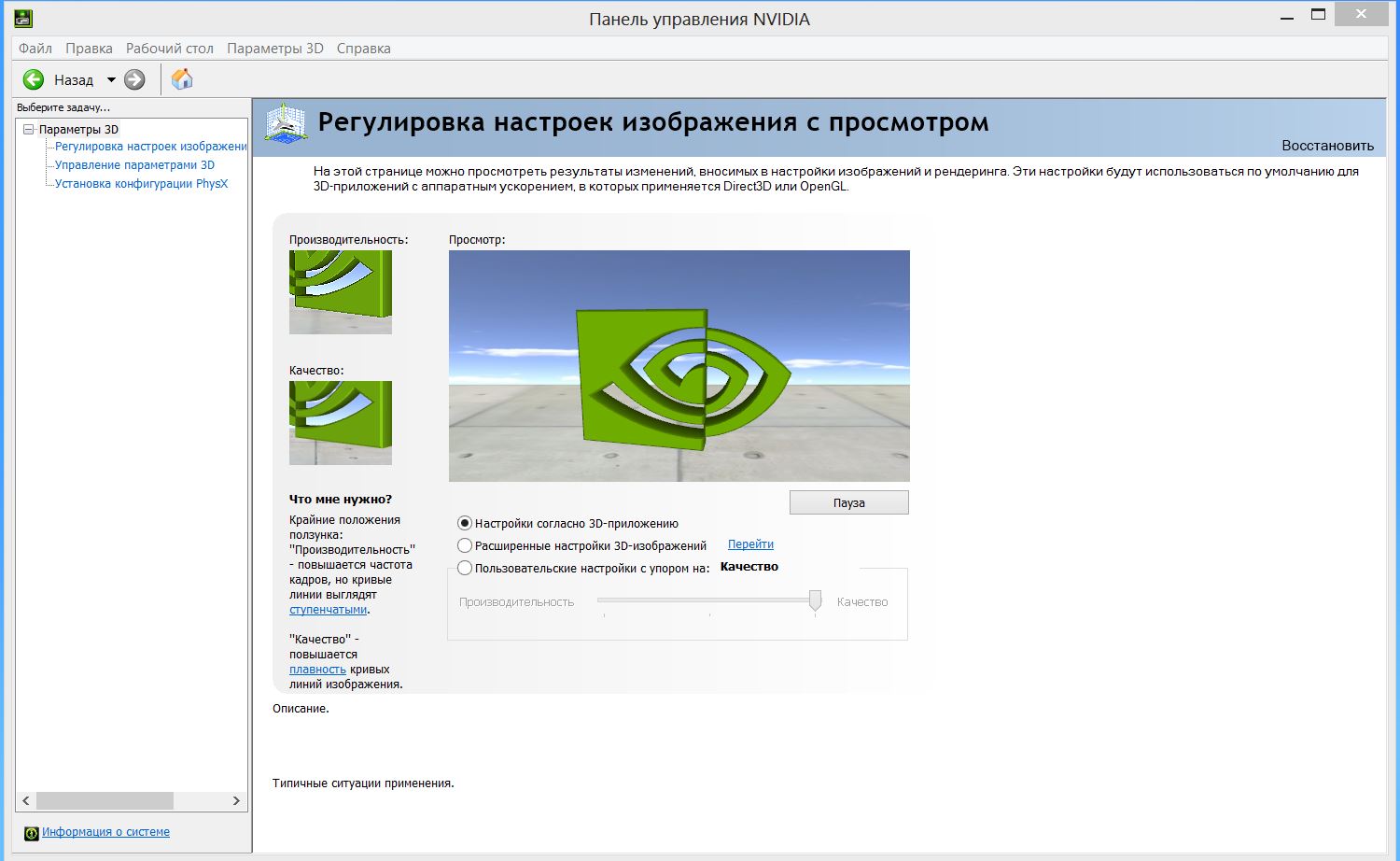

Tonus55 Posted August 6, 2014 Share Posted August 6, 2014 Why in my Nvidia control panel i not see Display and Video settings? Quote Link to comment Share on other sites More sharing options...
octiceps Posted August 6, 2014 Share Posted August 6, 2014 Why in my Nvidia control panel i not see Display and Video settings?[ATTACH=CONFIG]12178[/ATTACH]Do you have a Y510p/Y410p without SLI? If so, you're out of luck with LCD overclocking due to Optimus. 1 Quote Link to comment Share on other sites More sharing options...
Xupack Posted August 6, 2014 Share Posted August 6, 2014 I also got 103HZ on my y510p and I can see no more flickering on some websites that I used to (Steam). Quote Link to comment Share on other sites More sharing options...

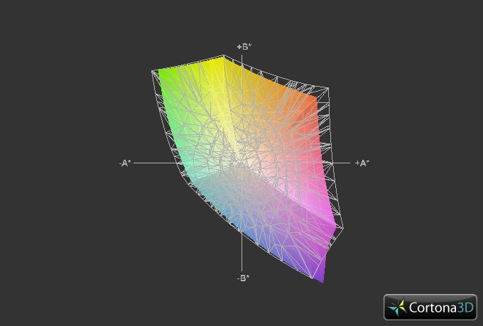

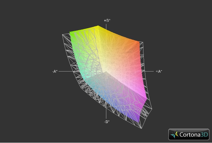

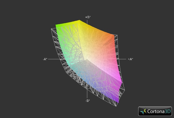

octiceps Posted August 7, 2014 Share Posted August 7, 2014 Actually, it looks like the glossy is slightly wider spectrum/more inside sRGB? TLC1 glossy: TLB2 matte: The only other apparent difference between the two is the stronger backlight on the matte which gives it higher brightness and contrast. The matte is probably just a less overclockable panel. Interesting that the Y580 uses the same TLC1 glossy panel as the Y500 and early Y510p. Not overclockable ofc due to Optimus. 2 Quote Link to comment Share on other sites More sharing options...
H658tu Posted August 7, 2014 Share Posted August 7, 2014 Actually, it looks like the glossy is slightly wider spectrum/more inside sRGB?Yes, that's because it's the same screen, but with a different (diffusing) filter for its final layer. Which, besides reducing glare, also filters the light from the lcd itself, reducing color space. The higher-powered backlight compensates the dimming effect (and contrast, because of the higher 'up'-values), but not spectrum; once a wavelength is lost, it's lost. What am I like the only person in the world with the non-glossy screen?You can turn it (back) into a glossy, or vice-versa. But the last option is tricky, unless you have vacuum cleaning tic (or own a cleanroom ...). More accurately, removing the AG filter is not really the same as an original glossy; the glossy has an outer layer too, but it is a clear one. So a matte-turned-glossy is more sensitive to damage than an original glossy.That being said, this production series is extensive, 13 models in all. Most are simply from a later production run. But which is better for overclocking ... there's no sensible way to determine that, except for trying (and plotting experiences with production series). You can, however, choose based on the properties contrast, brightness and spectrum. The last one using noteboocheck reviews, for instance. Quite a list, isn't it; Acer, Asus, Clevo, Gigabyte, HP, Lenovo, MSI and Sony ... 1 Quote Link to comment Share on other sites More sharing options...

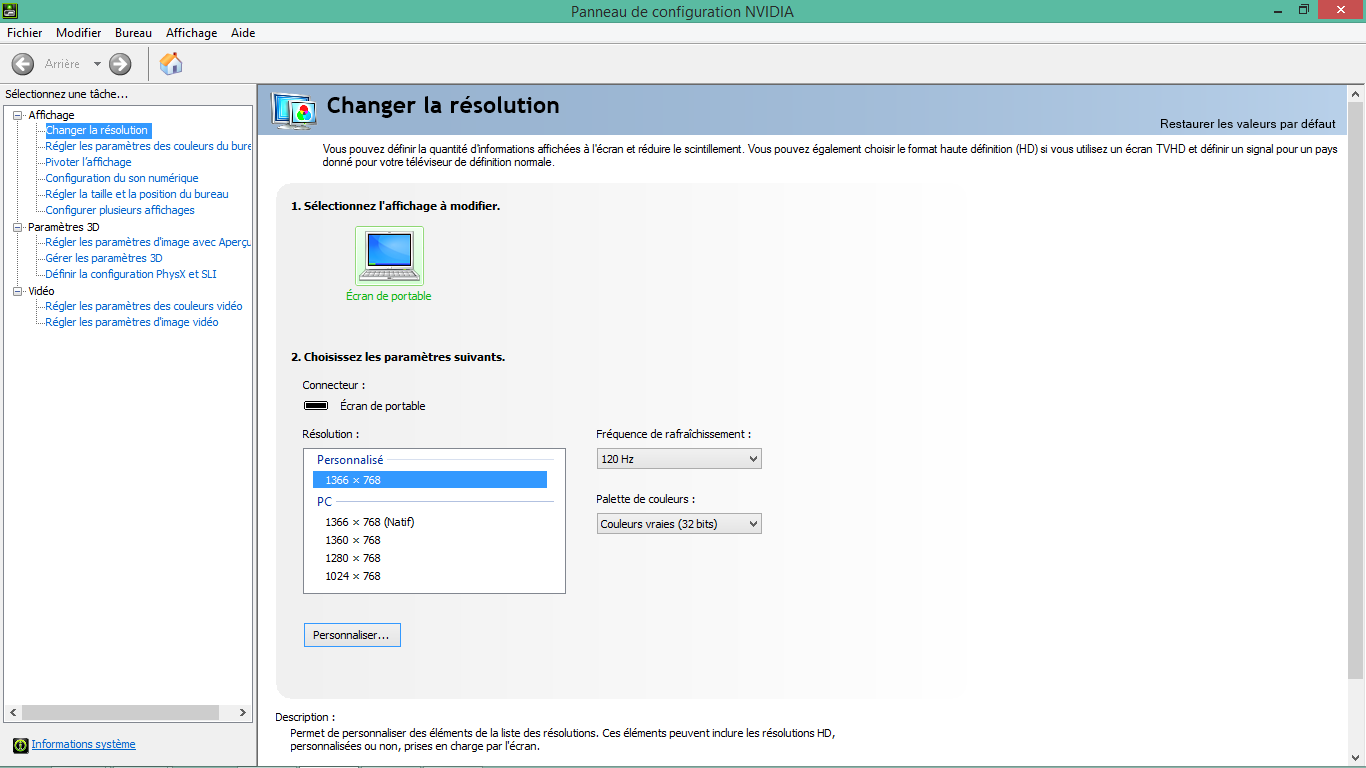

ecureuilx Posted August 10, 2014 Share Posted August 10, 2014 My screen is stable at 120Hz on my Y400. Quote Link to comment Share on other sites More sharing options...
octiceps Posted August 10, 2014 Share Posted August 10, 2014 My screen is stable at 120Hz on my Y400. Wow that's pretty crazy. And this is with the stock 1366x768 screen? What is panel number? It is actually possible to get 120 FPS in a lot of games with SLI at the lower resolution. Maybe I should find a 768p screen that can overclock to 120 Hz and install it on my Y500. Quote Link to comment Share on other sites More sharing options...

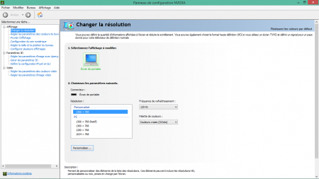

ecureuilx Posted August 10, 2014 Share Posted August 10, 2014 Wow that's pretty crazy. And this is with the stock 1366x768 screen? What is panel number?It is actually possible to get 120 FPS in a lot of games with SLI at the lower resolution. Maybe I should find a 768p screen that can overclock to 120 Hz and install it on my Y500. Where is the panel number? I tried 144Hz but my screen went black. Quote Link to comment Share on other sites More sharing options...

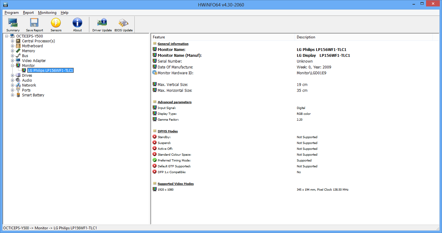

allstone Posted August 10, 2014 Author Share Posted August 10, 2014 Where is the panel number? I tried 144Hz but my screen went black.[ATTACH=CONFIG]12223[/ATTACH]You can use AIDA64 to find out your monitor model number. Quote Link to comment Share on other sites More sharing options...
octiceps Posted August 10, 2014 Share Posted August 10, 2014 You can also use HWiNFO64 to find your panel model. Quote Link to comment Share on other sites More sharing options...
