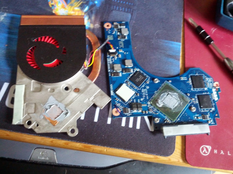

fejerm Posted December 30, 2013 Share Posted December 30, 2013 problem with another graphics card 750m.Temperature Ultrabay graphics card are after a few minutes were over 97 degrees, there was throttling.I took it from the port, disassemble it and I see:GPU HAS NO PASTA on it!!!It is the cause of overheating.To fix the problem you need repaste the Kepler GPU.Repasting the ultrabay GPU will NOT HELP...it may take a little bit more time to reach the 97C, but it will. Laptop cooler will not help neither...only way I could think of is to lower the vcore voltage by 80-90mV...too bad there is no probram out there yet which we can use to edit the voltage in the ultrabay VGA bios...Funny thinng is, the ultrabay VGA is cooking inside the laptop., but the fans are not running 100%. If you run dust removal, you can hear the fans running on a much higher RPM. (btw I am on BIOS 3.05) Quote Link to comment Share on other sites More sharing options...

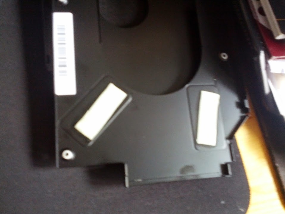

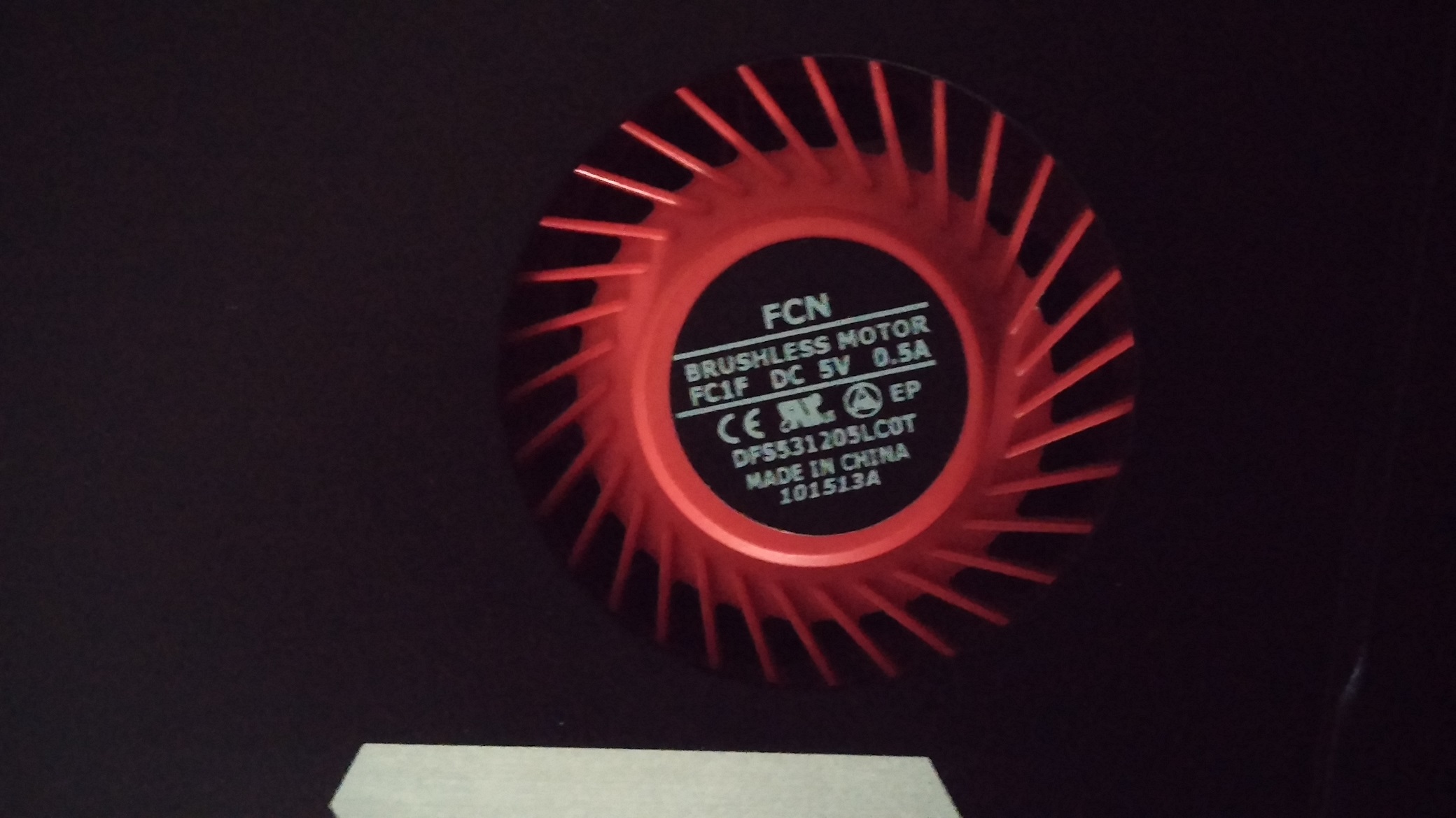

sullyman86 Posted December 31, 2013 Share Posted December 31, 2013 What does your ultrabay fan look like? I ordered a y510p off amazon and it had a lot of blades on the fan. It got very hot. I didn't repaste that one just returned after I found an open box one on newegg. The open box ultrabay reached about 85-90c max and after repaste never goes over 80c. But the newegg one has fewer fan blades. I don't know if the number of fan blades has any affect but it appears so. I wish I had pictures but I don't. Sent from my EVO using Tapatalk Quote Link to comment Share on other sites More sharing options...

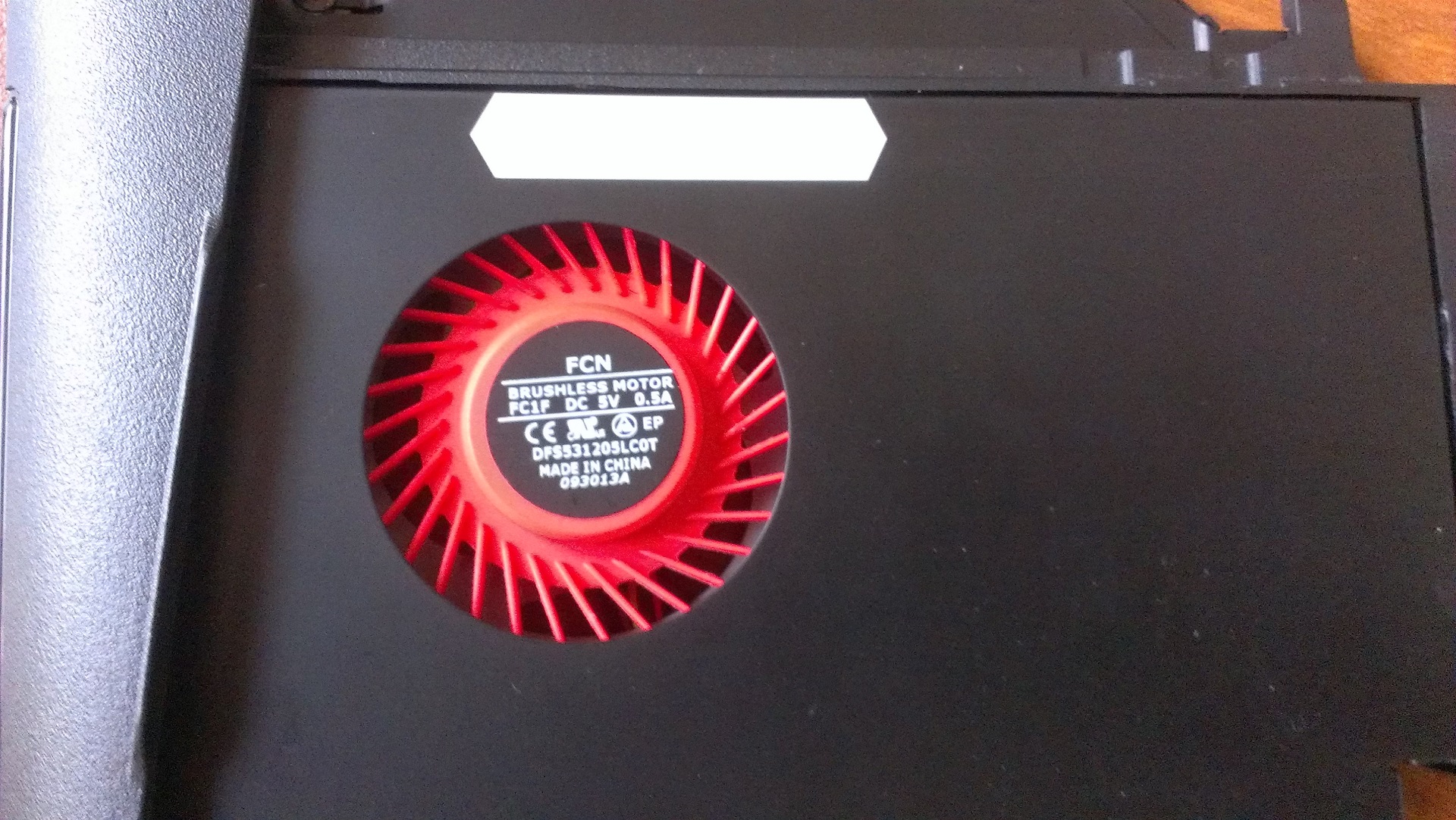

sullyman86 Posted December 31, 2013 Share Posted December 31, 2013 Here is my good fan. The one that heated up a lot had more fan blades than this and they were thinner. It was also the Sunnen brand - - - Updated - - - The biggest issue however is that the fan speed is not very close to max even though the GPU are getting extremely hot. I would say my fans only go to 50%. If there already is a mod to make these run faster than forgive me, but i do not think there is. Quote Link to comment Share on other sites More sharing options...

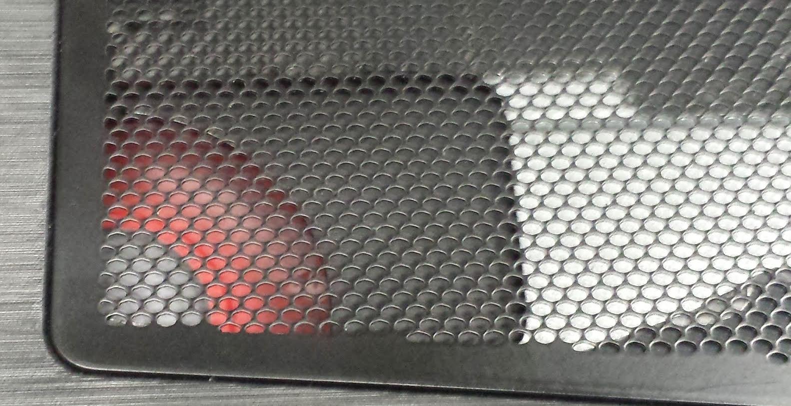

fejerm Posted January 1, 2014 Share Posted January 1, 2014 I have tested, if the ultrabay FAN was running on max RPM, it would help a LOT. I've ran a game while I started dust removal and until the fan was running on max RPM the 2nd VGA temp started to decrease. Wonder if it would be possible to mod the system bios or 2nd vga bios to force the fan to run on max rpm ... oh and my fan looks like this and it overheats: Quote Link to comment Share on other sites More sharing options...

code9523 Posted June 22, 2014 Share Posted June 22, 2014 I dropped temperature!!! I'm happy as never before! I used a coollaboratory liquid metalpad and it's works! My max temps in games dropps pretty good in same loads previously where I got on my integrated gpu 750m 75 - 85C I got now stable 70C MAX on the ultrabay 750m I reached max 93 - 97C now it's stable 83C MAX! All test where done without overclocking and in room with temperature of 22C. I got some problems with applying this metal pads on cpu and gpu at first time I put there one layer of metal and it was not enough so after second attempt I put the 3 layers of metal and heated a radiator on motherboard with hot air to 80C. Then I assembled laptop and launched furmark on it for 10 minutes to heat a gpu and melt metal pad for better contact after it I let it chill for a while and started game testing and results where just perfect after all my pains)) P.S. In ultrabay gpu I put same 3 layers of this metal. Quote Link to comment Share on other sites More sharing options...

darklotuz Posted July 8, 2014 Share Posted July 8, 2014 you would think since it's sold as a gaming laptop they would just do a little better job making sure the cpu and gpu's have good paste on them. I mean damn I'd pay extra just to make sure that was done from the start.problem with another graphics card 750m.Temperature Ultrabay graphics card are after a few minutes were over 97 degrees, there was throttling.I took it from the port, disassemble it and I see:GPU HAS NO PASTA on it!!!It is the cause of overheating.To fix the problem you need repaste the Kepler GPU. Quote Link to comment Share on other sites More sharing options...
Varroa Posted July 9, 2014 Share Posted July 9, 2014 Here are some pics of the unassembled ultrabay before I re-applied the thermal paste and did the spacer mod trick. I also re-positioned the thermal pads on the ram (and even added on where there was no pad). I got significant temp drops after I did this, enough to stop the card from throttling almost immediately and my 3D mark scores went up by over 50%. Quote Link to comment Share on other sites More sharing options...
