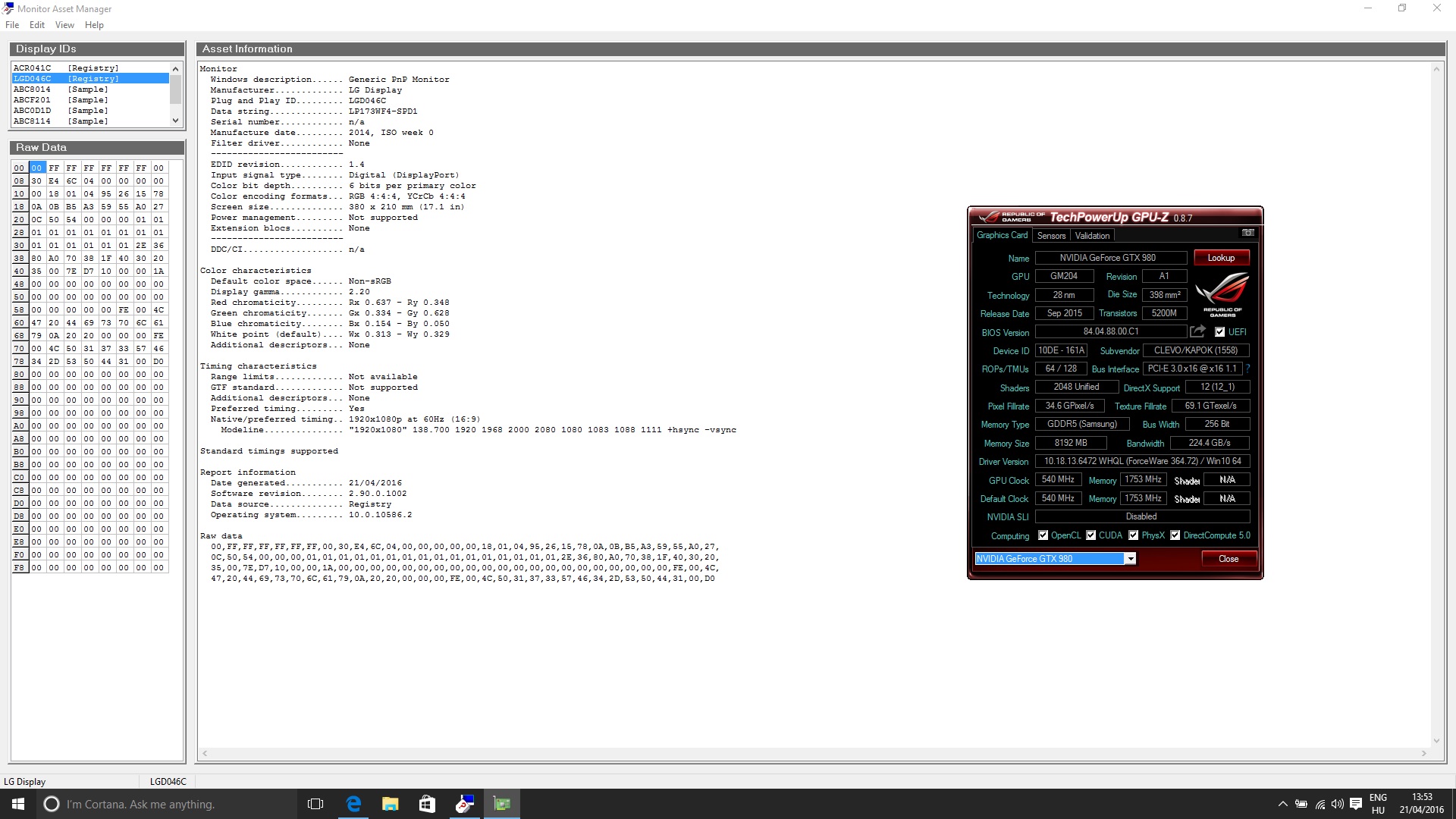

    P775DM3-G EC

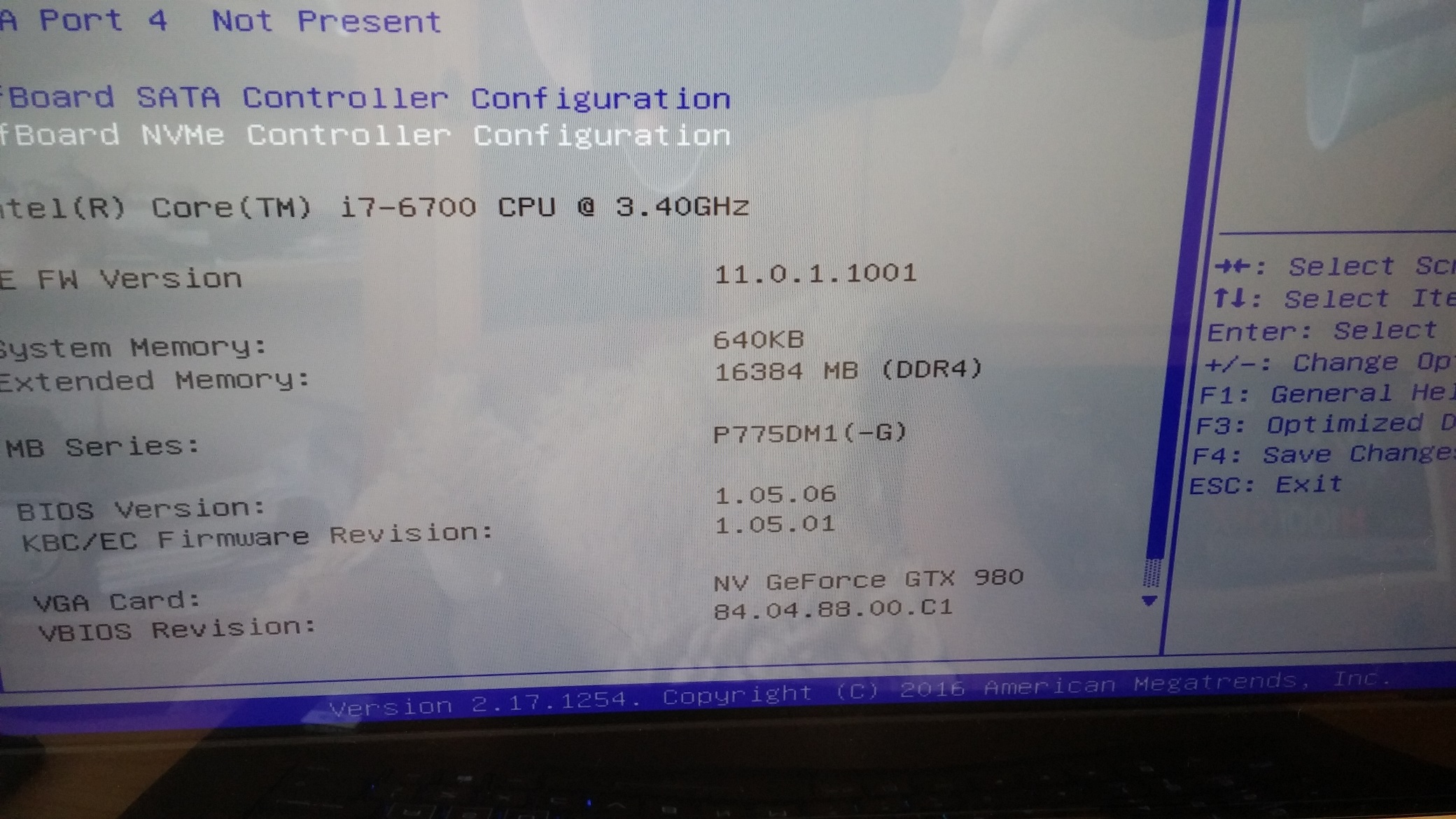

  7. Does anyone else experience microstuttering if the FPS goes under 50 and G-Sync is active? Also, does anyone else experience this weird aftershadow in Rise of the Tomb Raider if DX12 is active ? Also, could someone please save the stock vBIOS for GTX980 for me and send it over ? My vBIOS is 84.04.88.00.2A, is there a newer version? I have checked reviews of this laptop and none of them had this bios...or this is the latest one ?

  12. The cause was outdated EDID. (maybe even the SPD1 was white listed too) PCS changed my screen to another SPF1 and G-Sync is working again now.
  13. Thanks! Could you please also create an INF file for me with moninfo? Thanks!
