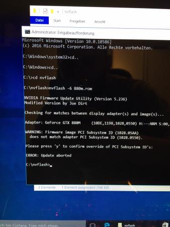

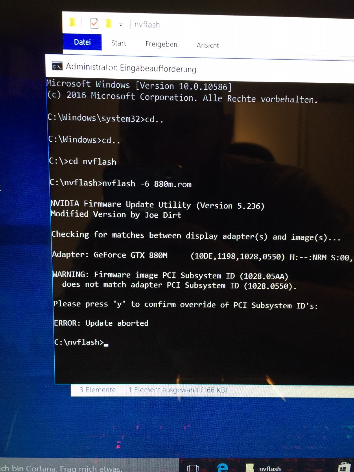

hello.what model laptop with you?and how you install?which version to use nvflash?thanks
First of all stop spamming the forum and wait for a reply.
Secondly: are you running the command line in administrator?
Did you rename the vBios file? If you can't do a simple thing like renaming a file then don't think on flashing this...
