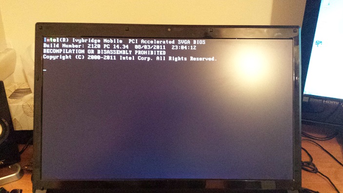

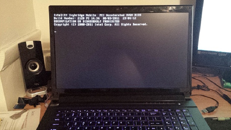

Hey guys, so I'm totally a retard and didn't follow the correct instructions for the Clevo P170em 680m 4GB version flash and looks like I totally bricked my card..... Basically I didn't see svl7's post about until it was too late.....this:
Clevo GTX 680m (4GB version) vbios:
'OCedition' revised -> higher limits for software overclocking, stock default clocks. For P1xxHM based systems I recommend only using version 80.04.29.00.01 !! Some users reported issue with other vbios versions (stock or modified, doesn't matter). EM users make sure you're on the latest BIOS / EC
same with increased 3d voltage ('OV') -> refer to the file name (Same warning as above applies to P1xxHM users).
I ended up flashing it to this:
Clevo 680m (80.04.33.00.10) 'OCedition' revised v01
And now my POST is this:
So if anyone has some good news that would be amazing LOL??? I know I could buy a whole new vbios chip and re-solder it onto the card.... which I totally don't want to do, or it would be nice to have someone do that for me lol. Seriously though I'm willing to ship my card and have someone fix this for me. Just sucks cause I literally just bought this laptop a few days ago for 900 bucks on ebay and now GOD has smitten me
(BUT GOD I ONLY WANTED BETTER PERFORMANCE...:04:)!
Anyways I'll stop ranting.... I have the backup vbios saved if that makes any difference.
Someone please let me know I'm not alone in my sins, thanks.
