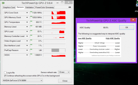

@All *FW development* @Prema's Mods, I need 9xxMs ASIC quality readings, in addition to 3D voltage* on stock vBIOS. SLI systems please include both cards...;)

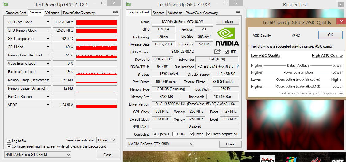

Hope I done this right - ASIC 72.4%:

@Mr. Fox Due to voltage throttling VDDC/3D readings weren't accurate, please repeat the GPU-Z render test, both cards. Like above run each card at a time.
Thx

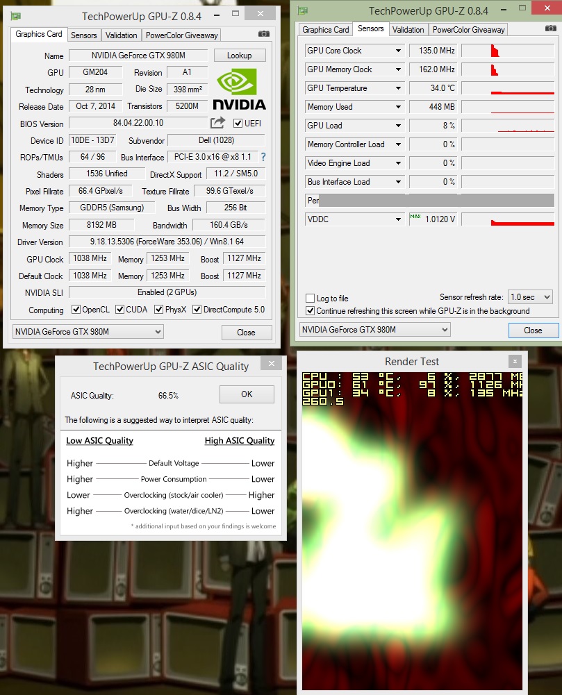

@J95 - with SLI disabled, there is no way to load the secondary GPU. If you select it in GPU-Z it still only creates a 3D load on the primary GPU and secondary remains idle. With SLI disabled the only thing the secondary GPU can be used for is dedicated PhysX rendering or CUDA compute tasks. This is not new or different with Maxwell... it has been this way all along.
Side note: @J95 and @Prema - unequal voltage is common on Maxwell SLI using stock vBIOS... that is not throttling, just a bug NVIDIA was kind enough to provide for us, even for desktop Maxwell GPUs. It is one of the documented Maxwell GPU problems. With the modded 980M vBIOS I am using it locks voltage on both cards equal because there is no dynamic "range" crap for the voltage to fluctuate as it sees fit. It goes where I set it and stays there unless the P-state changes because the operational "range" was eliminated. The high and low voltage are edited to be the same for each clock state, so it has nowhere else to go. The kicker is, you have to bump the voltage at least one notch to lock them. If you leave the voltage to stock defaults, one GPU will always be different than the other. It really sucks, but we've to expect suckiness from stock NVIDIA vBIOS for years now, right? They are never any good unless they are modded.
@J95 Heres the slave card 3d reading with sli off.
[ATTACH=CONFIG]15475[/ATTACH][ATTACH=CONFIG]15476[/ATTACH]
Exactly... this is normal behavior. It cannot be tested with SLI disabled because it cannot be used for 3D graphics rendering as a secondary GPU with SLI disabled.

Then try running gpu-z render test w/ SLI enabled, your previous test throttled due to 3dmark11 heavy load. Stock vbios unequal voltage is common/intended based on ASIC.

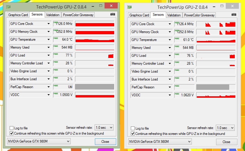

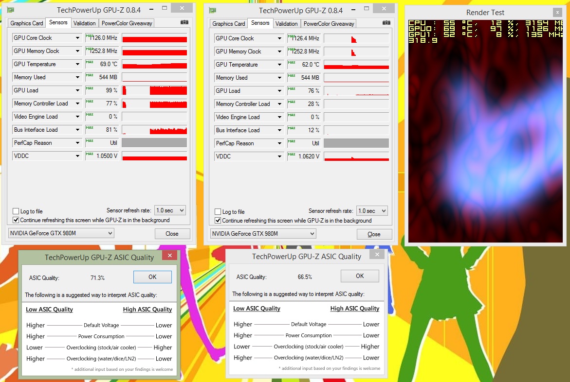

@J95 yes there's no way to fully loaded two GPU at same time, with SLI disabled, the 2nd gpu still sit idle, i even think to swap 2 gpus, but seem to be useless since 2 gpus behave exactly same way, 2nd gpu still idle anyway

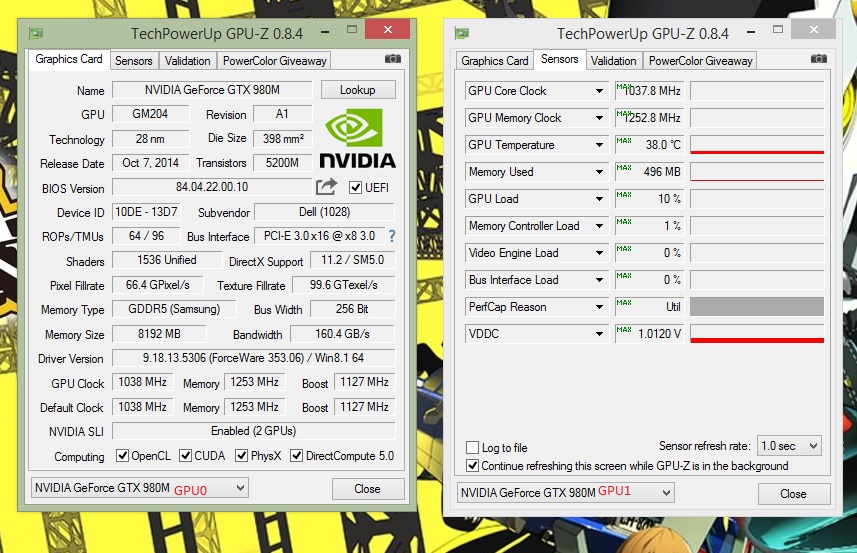

Here my result, stock cpu& gpu clock, stock vbios, stock bios, driver 353.06, with VDDC set to highest value
GPU0
GPU1
there ya go, hopefully l'm doing it right
first i run about 10 sec of 3dmark11 (entry profile), take screenshot of 2 gpu-z status
then i ran render test in fullscreen mode, exit render mode and take asic quality of 2 gpus
final step is run render test in windowed mode and take asic quality at the same time (same with previous post)
pls note that left panel is GPU0 and right one is GPU1
/if there's anything i can help with, pls inform me

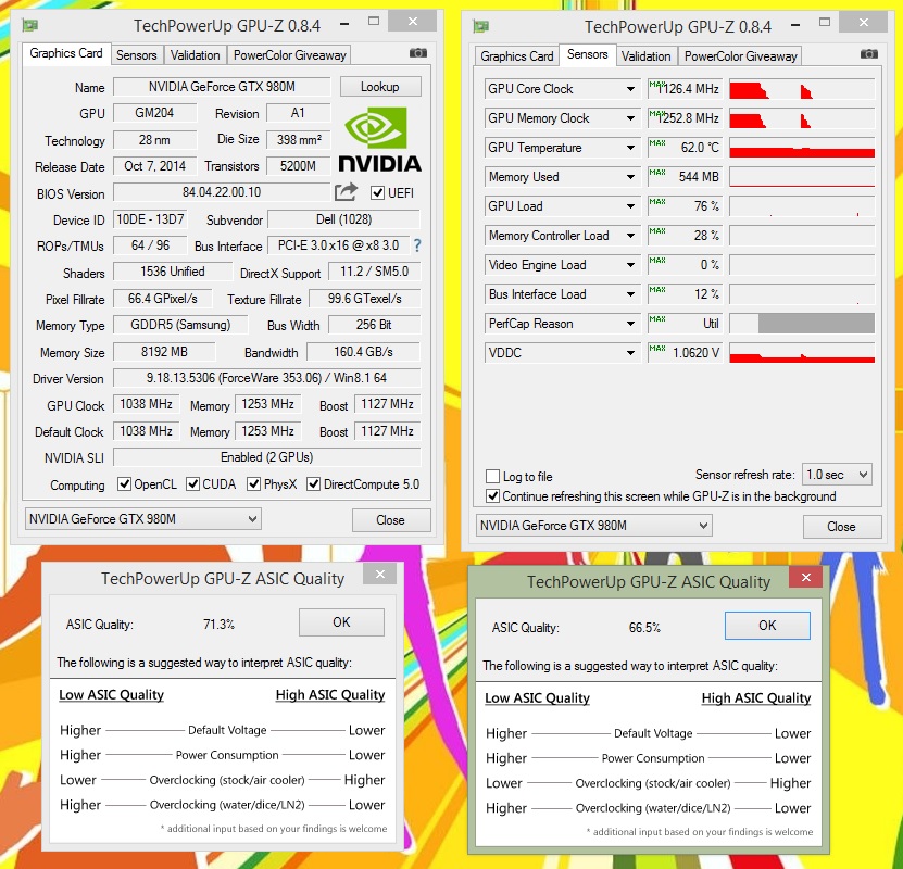

[ATTACH=CONFIG]15512[/ATTACH]

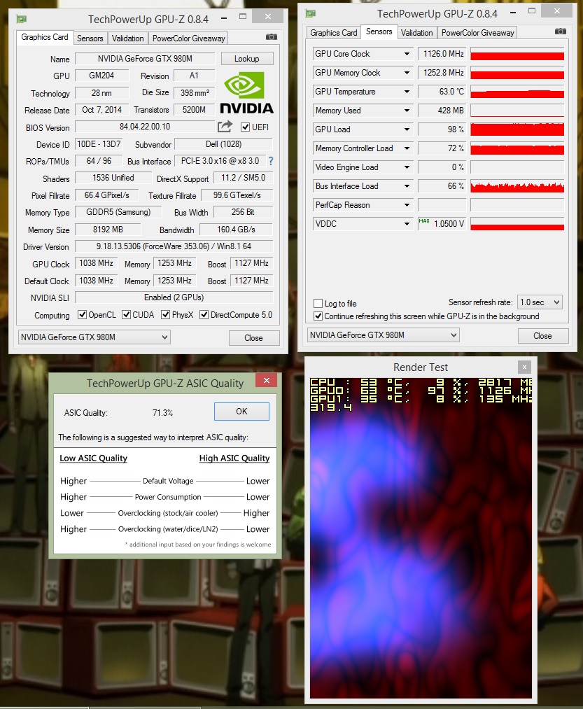

[MENTION=1756]twin snakes[/MENTION]
ASIC 65.5% 1.062v
ASIC 71.3% 1.050v
GPU 0
[ATTACH=CONFIG]15463[/ATTACH]
Well i still can;t run render test with secondary gpu, only primary one is fully loaded

yes i notice that too, 2nd gpu has higher vcore as well as lower asic quality
so do you get what you need?
Yep, thanks man. Including both results perfcap reason.
*Stock vBIOS*
Like above, please set GPU-Z sensors to "Max" and then run 3dmark11 "Entry Level" for a few seconds to capture secondary GPU VDDC reading.

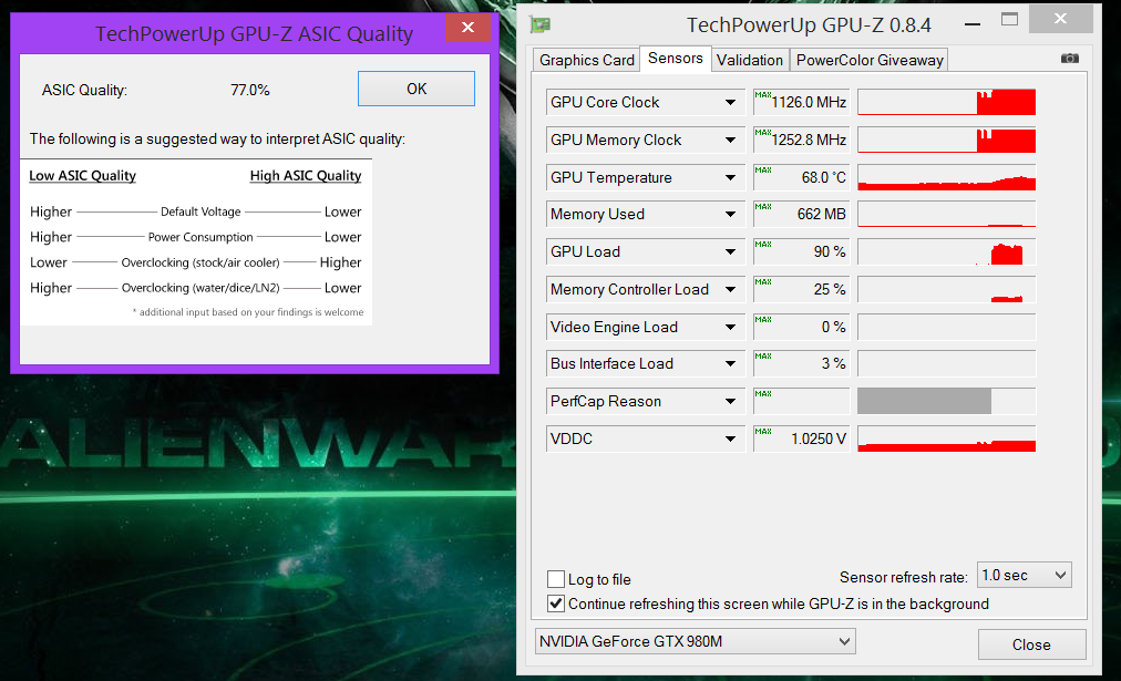

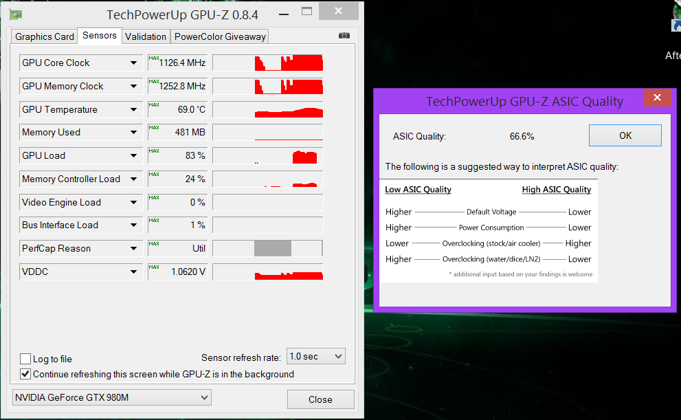

@J95. I did as you asked. except i had to run 3dMark at "performance level" only option available on demo.
hope its what you need :)
GPU0
[ATTACH=CONFIG]15525[/ATTACH]
GPU1
[ATTACH=CONFIG]15526[/ATTACH]

I got my cards from you aswell on ebay!! They are running beautifully in my beast (after finding the right driver that is)... u can see my ASIC score above is pretty decent one @77.0 other @66.6. can I swap the one with lower ASIC? (Joking) lol :distracted:

@haXBOXpro THX.
ASIC 66.6% 1.062v
ASIC 77.0% 1.025v
