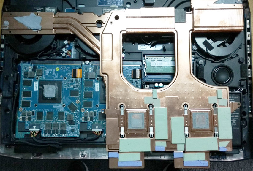

The backside of the PCB alsohas empty slots for memory. 16GB anyone? :)

Prema any chance you could fix the MSI 1080 links? Is the layout the same as the 1070? The MSI 1070 looks really good. It should be fittable into a standard MXM 3 slot and be able to take an unmodified heatsink. Too bad MSI cards can only be found rarely on ebay.
I am very surprised by the use of multiple core VRMs. The only cards I am aware of that being done on were pre 2011 AMD top end GPUs (HD 4890 and I think 2900XT). The Clevo is definitely 4+2. The MSI is hard to tell. I first thought it was a 5, but it looks like it is actually a 3+2. There are two sizable VRMs at the top that look like they are for the core, while neither is big enough to be able to control 5 phases. I feel bad for Prema trying to BIOS mod these multi-VRM cards.
The Clevo design does look a little better, but of course its bigger. Those lower 2 core phases will pull power very efficiently from the MXM power tabs, and the upper 4 phases get power efficiently from the power connector. Also 2 memory phases should outperform the single memory phase on the MSI. The MSI appears to be plug & play into older laptops though... well worth the less than 1% overclocking difference.

They only plug into some roomier models like possibly the P7xxZM/P7xxDM. I can tell you for certain that 1070 will NOT fit in my laptop, either in the primary or slave slots. And I don't expect it'll fit in your P150EM either, though I could possibly be wrong. (Not that we could cool them easily, heh. Or that I have ANY intention of upgrading this laptop whatsoever; a new model is just better in every way now that 120Hz screens are a thing again).

The ES/QS 1070 boards had all MOSFETs soldered, just like its bigger brother. The MP boards are missing two.
Apart from that difference it's just GDDR5 Vs. GDDR5x and some smaller components.
Clevo wants to use this MXM format across the board going forward...

The run was with automatic FANs. And here comes the thing:
These are now 12v FANS and the automatic profile won't let the FANs get to 60% of their full capacity even at maximum heat...reason being it would sound like a jet engine;)

Will the  processor cooling be somewhat degraded due to the shared GPU cooling?
CPU will be cooler in pure CPU runs like long encoding scenarios...if we put full load on both GPUs and CPU then well, we will have to see...

As @Prema stated, the fans they use on the P870DM3 are all 3 the same model, contrary to the original P870DM. Judging from photos it seems in the new model they replaced the bigger 2 fans of the old model and are using now the smaller/weaker fan in the center of the old model exclusively for the new P870DM3? I am a little bit concerned about this fact. In the video from Eurocom one card gets 90 degree hot. Can somebody confirm if indeed the center fan of the old model is the same version as the 3 fans used in the new one?

Check my reply regarding FANs a few posts above...(old FANs where 5v).
Why are they using 2x230W instead of 2x330W for P870 with single 1080?
