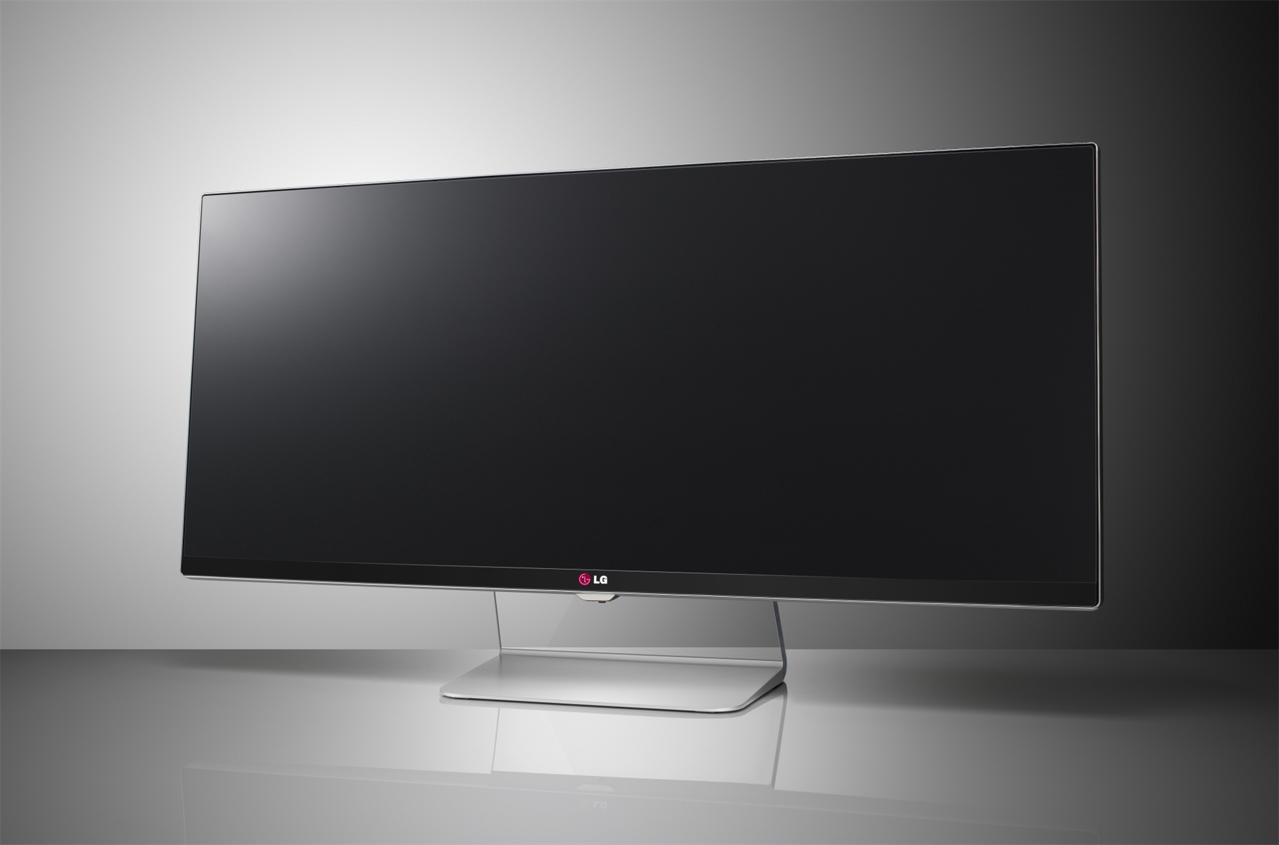

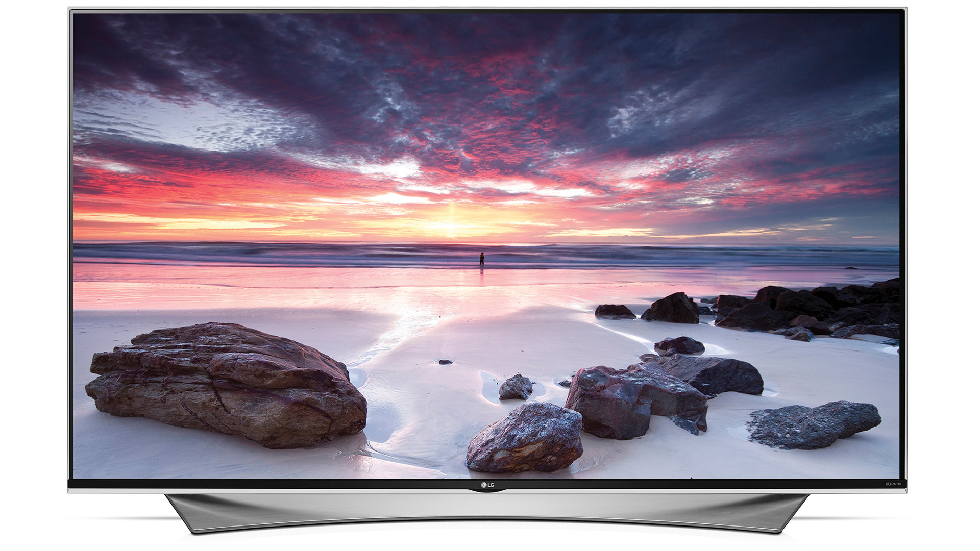

TBoneSan Posted August 25, 2016 Share Posted August 25, 2016 (edited) 1 hour ago, Dr. AMK said: Dear friend, just listen to @Mr. Fox advice in this regards and you will not regret that. I'm using a 4K 55" LG TV as a monitor and I can feel the 4K details practically, 17" 4K in my opinion is just a waste of money, but for rich people it will be nice to have especially if it will support the 120Hz I was referring to the 1080p 120hz monitors (Def don't want 4k..more so I don't want 60hz). I've been informed by Hidevolution that the current 120hz monitor is also shipped with a non-Gsync gpu. Ie. If you were to swap over to a gysnc display on the laptop itself, it still wouldn't work. That would be really crappy when it comes to selling someone the old card at upgrade time as most people would have Gsync displays. Additionally I'm not clear on what display will be on offer soon other than it being 120hz and Gsync. Is is going to be 5ms? I don't mind if it's TN or IPS. Edited August 25, 2016 by TBoneSan 2 Quote Link to comment Share on other sites More sharing options...

Dr. AMK Posted August 25, 2016 Share Posted August 25, 2016 16 minutes ago, TBoneSan said: I was referring to the 1080p 120hz monitors (Def don't want 4k..more so I don't want 60hz). I've been informed by Hidevolution that the current 120hz monitor is also shipped with a non-Gsync gpu. Ie. If you were to swap over to a gysnc display on the laptop itself, it still wouldn't work. That would be really crappy when it comes to selling someone the old card at upgrade time as most people would have Gsync displays. Additionally I'm not clear on what display will be on offer soon other than it being 120hz and Gsync. Is is going to be 5ms? I don't mind if it's TN or IPS. I didn't play games too much in the laptop screen or even doing my work on it, so I really don't care much about that, my investment goes to an external big high end quality monitor, I found that more reasonable for me. I attached my monitors for work in office, and for my home, maybe they are not the best out there, but I'm happy with them so far. 1 Quote Link to comment Share on other sites More sharing options...
