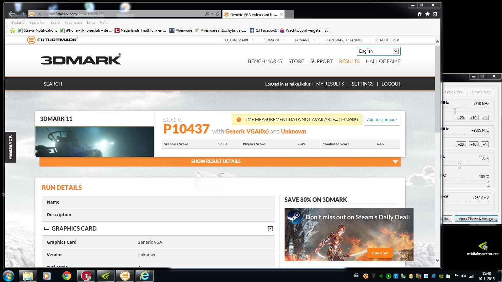

Finally got it flashed.....thanks Robbo youre help was great.
First run overclocked i think that its my limit as well everything more gives me crashes......so +230 is the max for me.
But still impressive for a 6 year old lappie......smile.

thats the picture its also on the benchmark treat....
[ATTACH=CONFIG]13570[/ATTACH]
